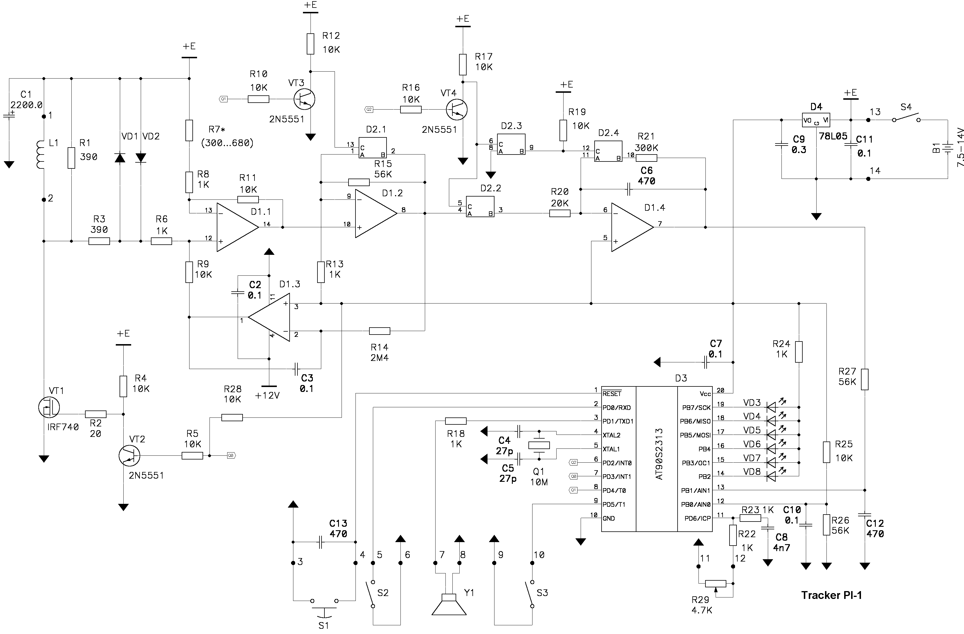

                    clone pi
                      tracker pi

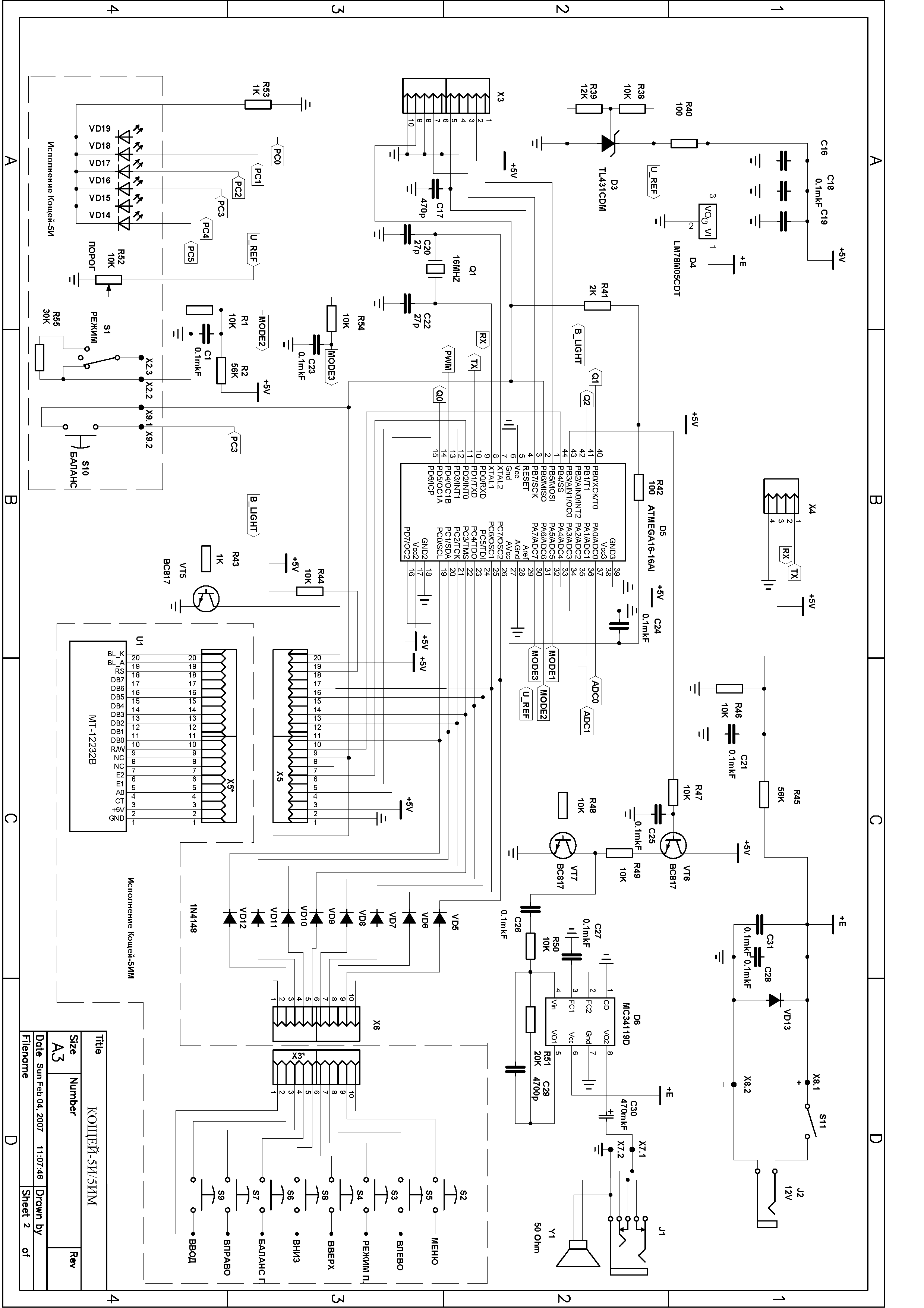

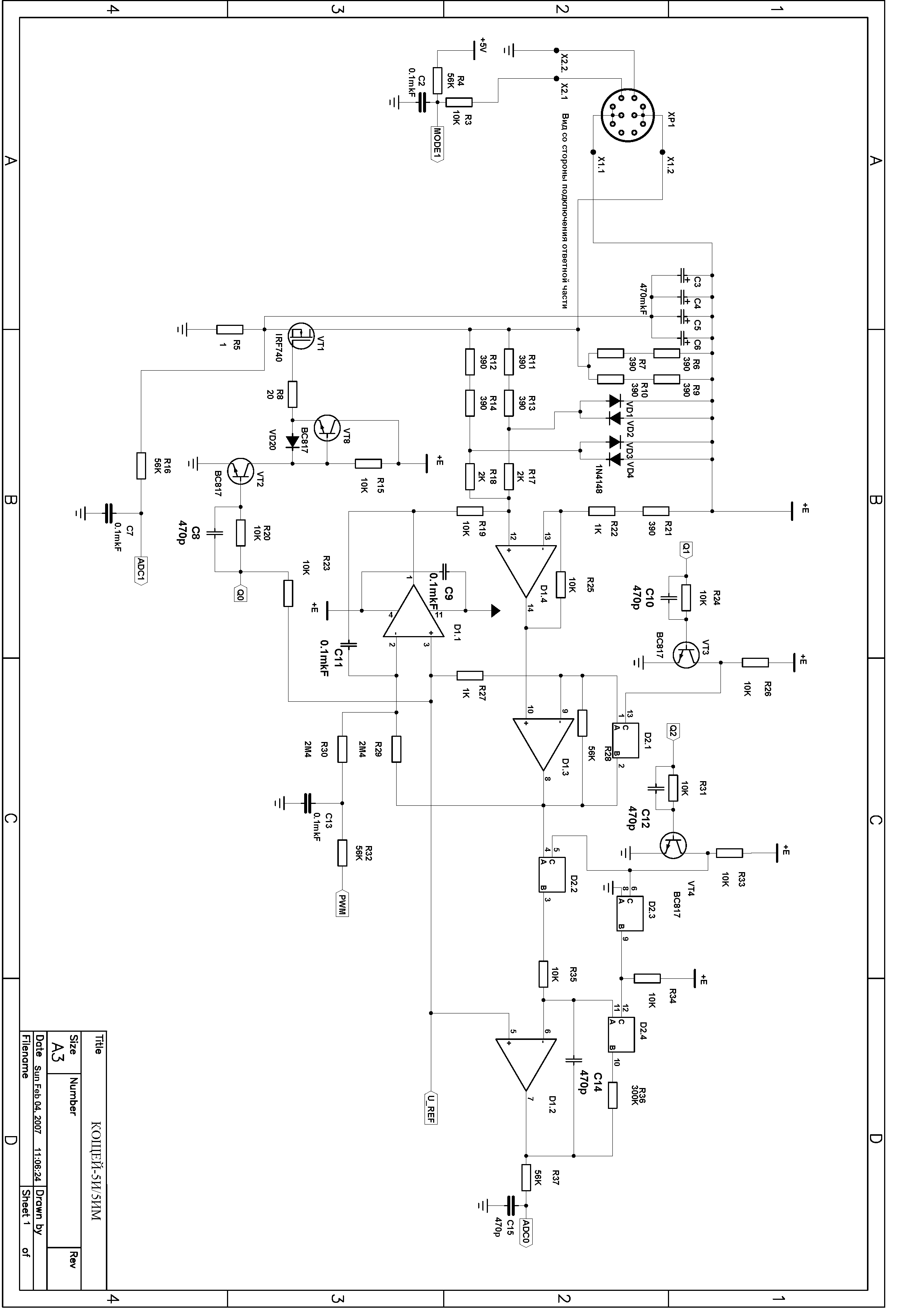

                        koschej-5im

                          ALMETA PI is clearly a Tracker PI-2
