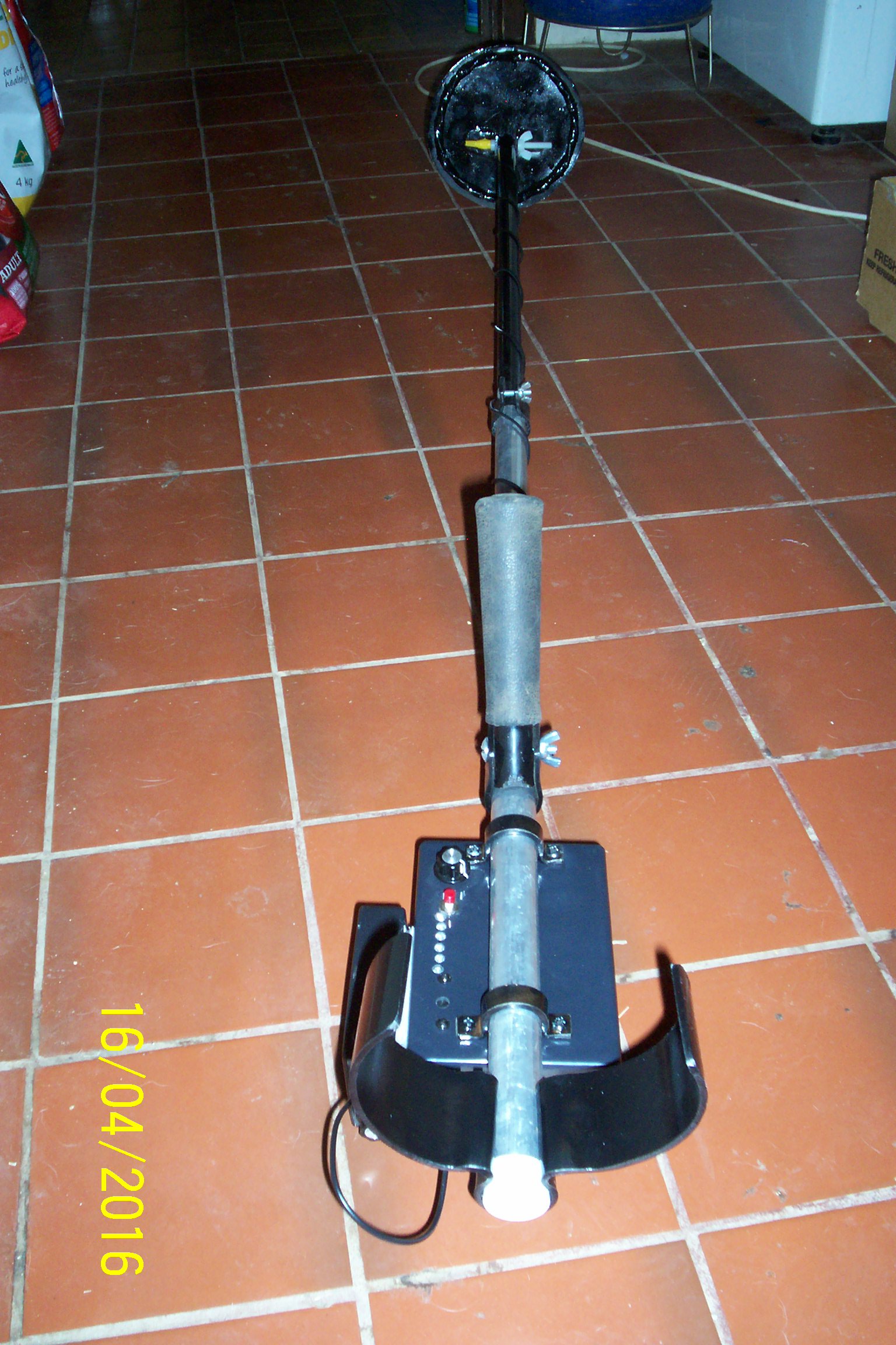

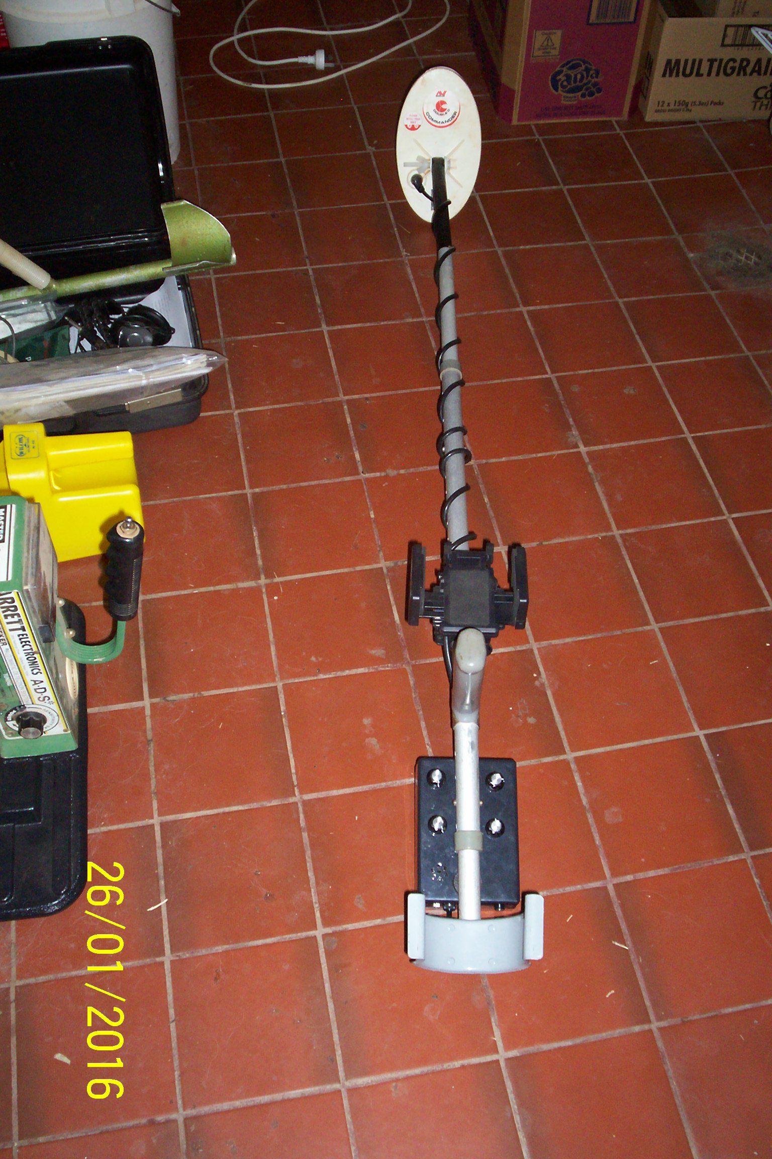

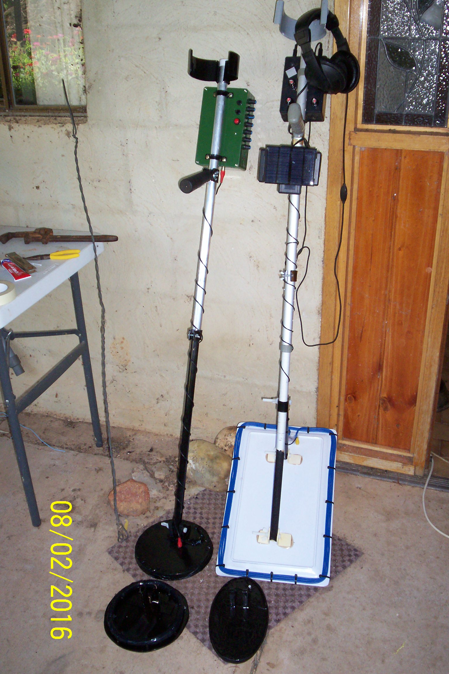

            This is my power option on all my homebuilds now. 3x18650s, with the $3 charge controller (alongside battery holder) and a $6 1amp solar panel. The bracket is a phone holder for a bike $6 You can also get a 3amp panel not much bigger.You can charge from any external 12v adaptor if you ever used it in the dark for hours.

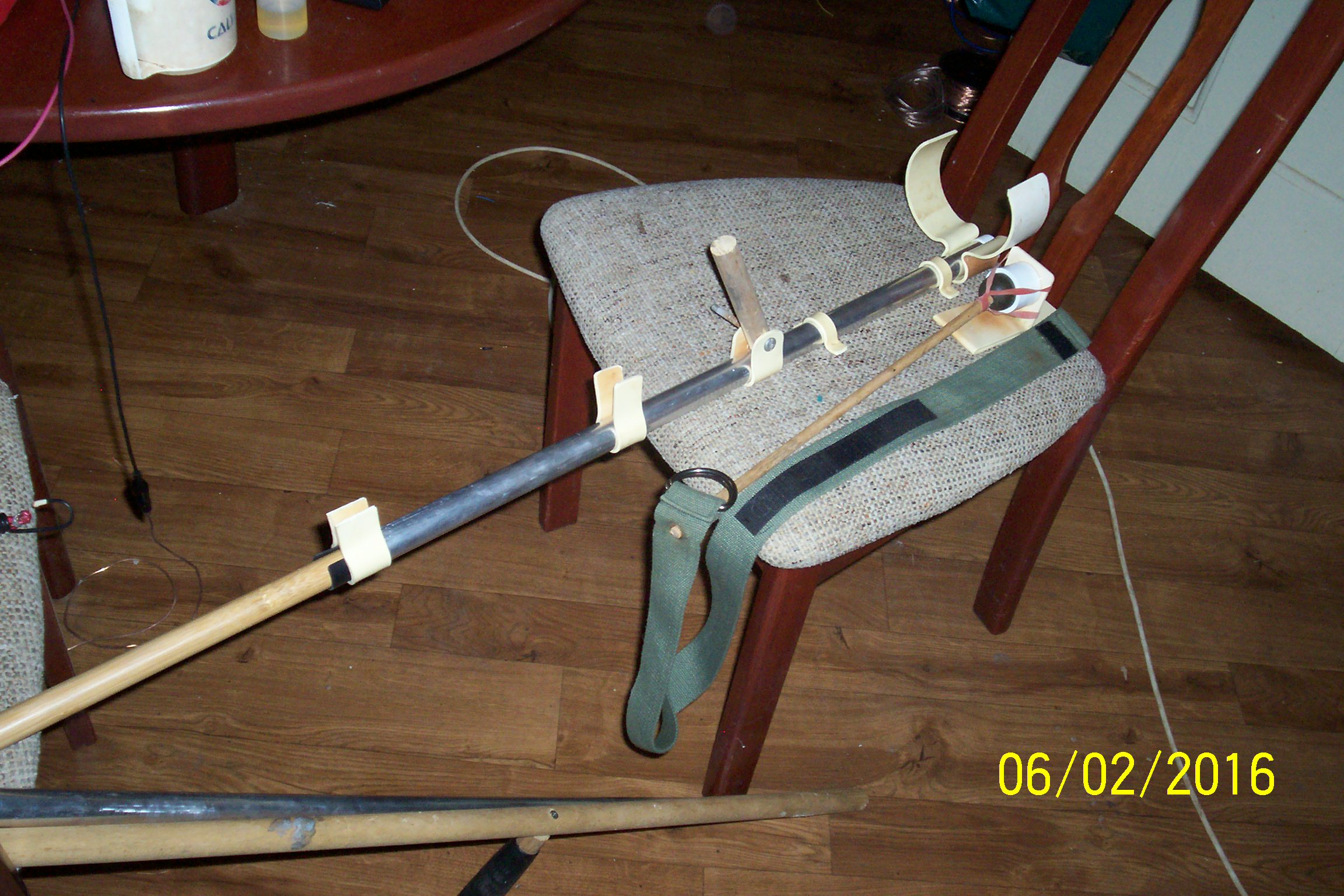

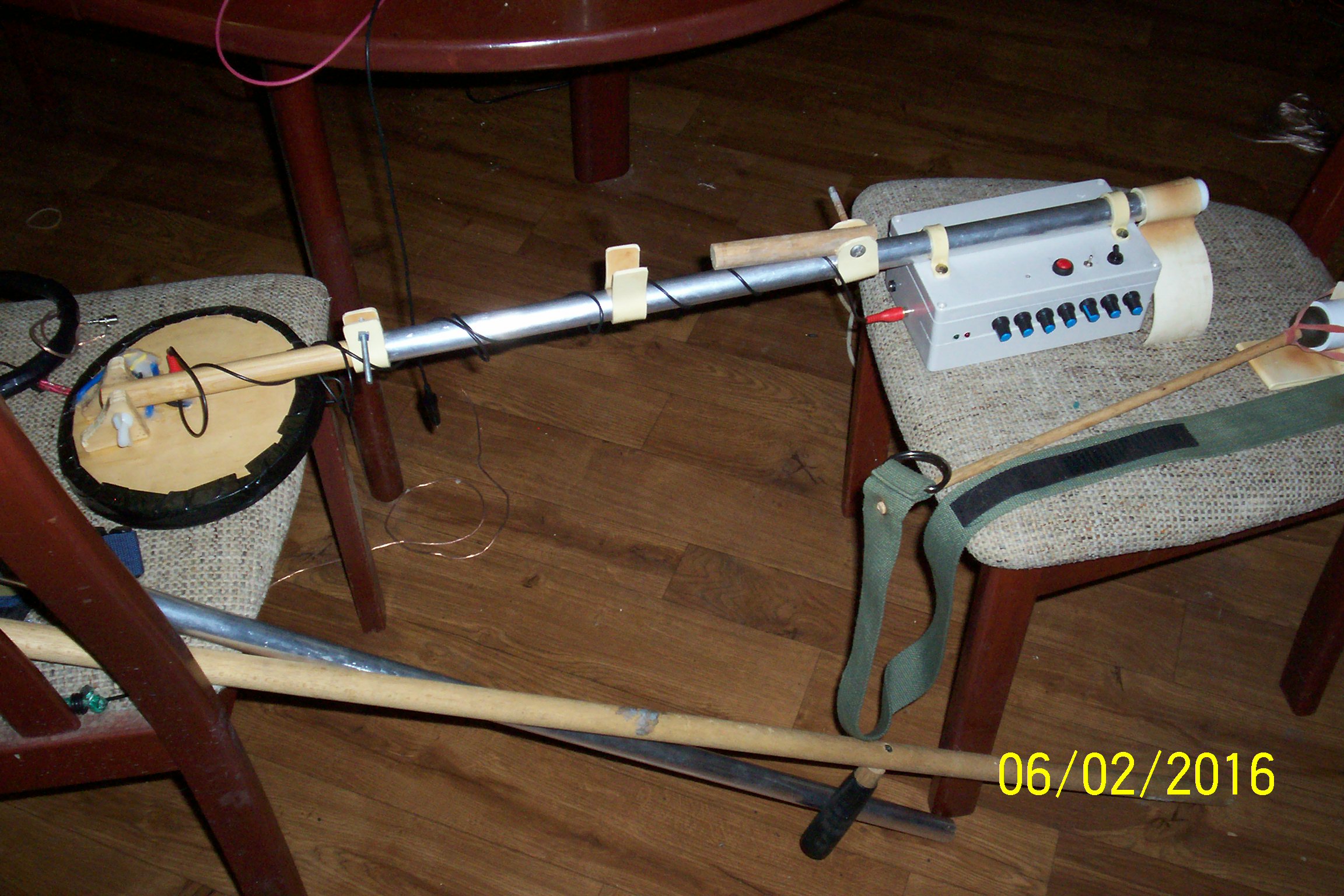

            Also now I am making my brackets and armrests from 4inch pvc shaped with a heat gun. The extra bracket is for the hipstick/bungy, for the big coil. The last coil I made, 6 inch, 3 rounds of Cat5 twisted. 380uH, (on Newhobby NH-5-last picture) can see 1.8g of flour gold at 4 inches on the SurfPro.
            If not for the broomstick lower shaft, it would be super-light.
            9v LM386 speaker/amp box-just visible in last picture.

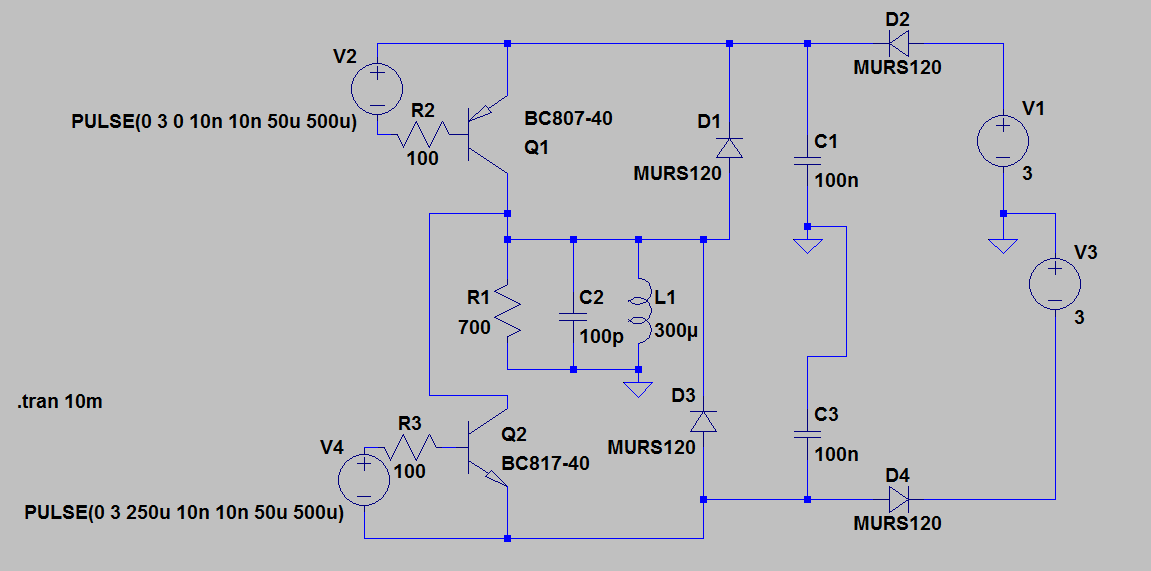

                  One option to consider is half-sine TX. It's more efficient and offers full target ID, drawback is the PI response isn't as good.
                  Carl, are there any reference designs for a half sine bipolar TX that you are aware of for study?
                    A few times I've mentioned that the Fisher Impulse TX circuit is a good candidate for people to study and play with. It will support bipolar half-sine with nothing more than a judicious choice of capacitors.
                      With a class-G styled coil switch and a capacitor snubber to power it, it makes for a fast rising coil current enabling short pulses with high excitation. Granted, works unipolar as well, but bipolar gets rid of earthfield sampling.

                          Snubbing the coil current with a relatively small, high voltage capacitor to give a high voltage "start" would give benefits relative to constant-current switch-on. The bipolar implementation is more elegant in doing with just diodes. Notice that the switch BJTs can be driven by a current sink/source at battery voltage level. Energy efficiency is not as sweet as Impulse. That is one circuit that could do with more homebuilding and basis for experimenting.
                          Playing with capacitor sizes and pulse lengths gives optimized responses to different target TC, and capacitors are something relatively easily switched "in and out" of the circuit. I see at least one PI patent that deals with constant-current driving a coil, with familiar names under inventors... Class G switching driver doesn't give equal benefits, but I don't see any current patent on it, or haven't had luck searching. However I don't believe the circuit is novel in any manner. It's also missing voltage shunt regulation or clever sampling for consistency.

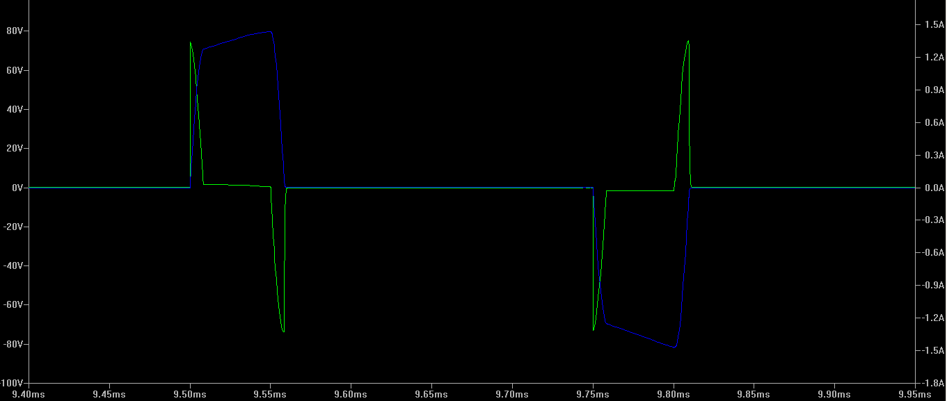

                            half-sine anybody?

                            WOW... totally by a fat fingered mistake!
                            bi-polar_sine(1).pdf
                            bi-polar_sine(2).pdf
                            I was playing around with a simulation based on a variation of Dave Johnson's latest patent design, when I fat fingered a value change and boom... this appeared on the subsequent simulation run! I will not be posting a schematic. However, I will post a link that will lead to public information about Dave's design.
                            http://www.geotech1.com/forums/showt...nson-PI-Patent
                            I will tell you that the coil I was using, was 1000uH. I have been experimenting with larger coils as a result of Eric Foster's discoveries/discussions about the Vallon mine detector, that stands on it's head the notion that large slow coils are not suitable for detecting small low conductivity targets. With innovative TX designs and DSP RX processing, almost anything is possible.
