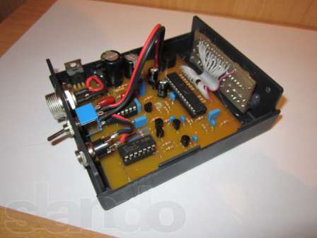

    I did clone pi W (with Atmega
    it's sensive and powerfull but it's sense all metals (I want to sense just Gold and not any other metals)
    Can you guide me (for Example) adding some circuit for this devices to only detecting gold and drop other metals
    thanks
    please help me
    You will need to build a VLF unit, search in the forum and pick project you like the most.
    No machine will give you exact rejection of "all metals but gold" you must know that, you will still need to use a "shovel discriminator" - if it beeps, dig

      Hi saber! Can you send me the pcb, pcb layout and schematic for this machine?
        here tis
          http://fandy.hut2.ru/ I think is the original designers site.

              so i need a VLF unit. can you put a sample here for me and Explanation about "shovel discriminator"
              Thanks again
                Look in the board schematics too. You can find there enough vlf projects maybe quasar vor krot XM is possible for you
                  thanks "bernte_one" your the man
                  what's your Ideas about Chance pi? i think it's suitable for this Case.
                  can you show me Which is the part that i needed in schematic, Please.
