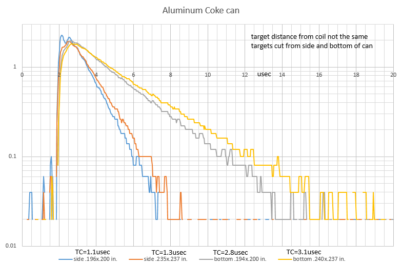

      [First of all it is quite difficult to accurately fabricate a 5mm X 5mm piece of Aluminum can side wall. I was able to make a 4.96mm X 4.99mm square, .10mm (.00393") thick target for this test. I had to hand file to the final 5mm dimensions using a fine cut jewelers file. I used a digital caliper to measure this target. reply315]
      Wondering how size effects TC. Agree, cutting the correct size is difficult. I have a vernier caliper to measure things, so I couldn't check thickness. The other dimensions are close. It's easy to see the difference between 5x5 amd6x6mm. Haven't measured the effect on distance yet.

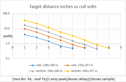

        Target amplitude vs distance for the four targets. RC feedback_.2usec
          Hi Green
          Thank you for this chart and the previous chart. They really do show how small changes in size and thickness can make big differences in detecting small objects.

              I cut a 0.25” x 0.25” (6.35mm) from the bottom of a coke can 0.26mm thick. My TDI detects it at approximately 3”. The same size from the side of the can (0.09mm) is not detected.
              The TDI was set to min delay (10us) with ground balance off and max gain.

                    Hi Chet, well cut up a 1/4x1/4 bottom piece, .26mm thick and guess what detects no probs at 4-5 inches AIR TEST on my 14x7 nugget finder,
                    (checked the size of coil , called it a 14x9 somewhere else)
                    gain maxed, 10uS, GB off.
                    tested the 5mmx5mm .1MM again , not a peep, I dont think much of the TDI standard 12 inch mono coil, its good on coins but not very good on small stuff, rarely use it.
                    How would you rate the SADIE ?
                      Hi 6666, when I set the first sample on my detector to 10us I can detect the 5x5mm at about 2cm, but if I reduce the first sample down to 8us delay the 5x5mm is detected at about 8cm.

                          I use the Sadie on a GPX5000. It works well in close spaces. But I use a Nugget Finder 14” x 9” (outside measurements) almost all of the time. A friend has an older Nugget Finder coil that is narrower than mine. I have found it just as good as the Sadie on small targets and covers more ground. The GPX gets the ¼” bottom piece at slightly over 5”; here in town with the EMI screaming in my ears.

                              Hi Chet, how deep can the 5000 detect 5x5mm side wall target using the 14x9 ?

                                6666 your comment above about the 1/4" (6mm)target cut from the bottom piece being detected at 4 to 5" in air no problem is what I wonder if is in play with the detection of a roughly 6mm X 6mm target in air in the Felajoo video. Is it in fact made from the sidewall of an AL can or is it cut from the top or bottom of the can?
                                Other than to try to answer your question about "Whose detector can get the response from the 5mm X 5mm X .1mm sidewall?", the reason I posted the thickness data from the same AL can in post #15 above is because the response from the can bottom is much larger (10 times greater) than the response from the sidewall and I wanted to point that out. This may explain how the Felajoo was able to see a 6mm X 6mm target at 4" in the video. Is there another video out there that shows Felajoo detecting a 5mm X 5mm X .1mm target because I have not seen it? There seems to be a lack of clarity about Felajoo and its capabilities on small targets.
                                Mickstv, Thanks for the follow up on taking a close look at the 6mm X 6mm target in the video. It confirms that the target is not square and is most probably larger than 6mm X 6mm.
