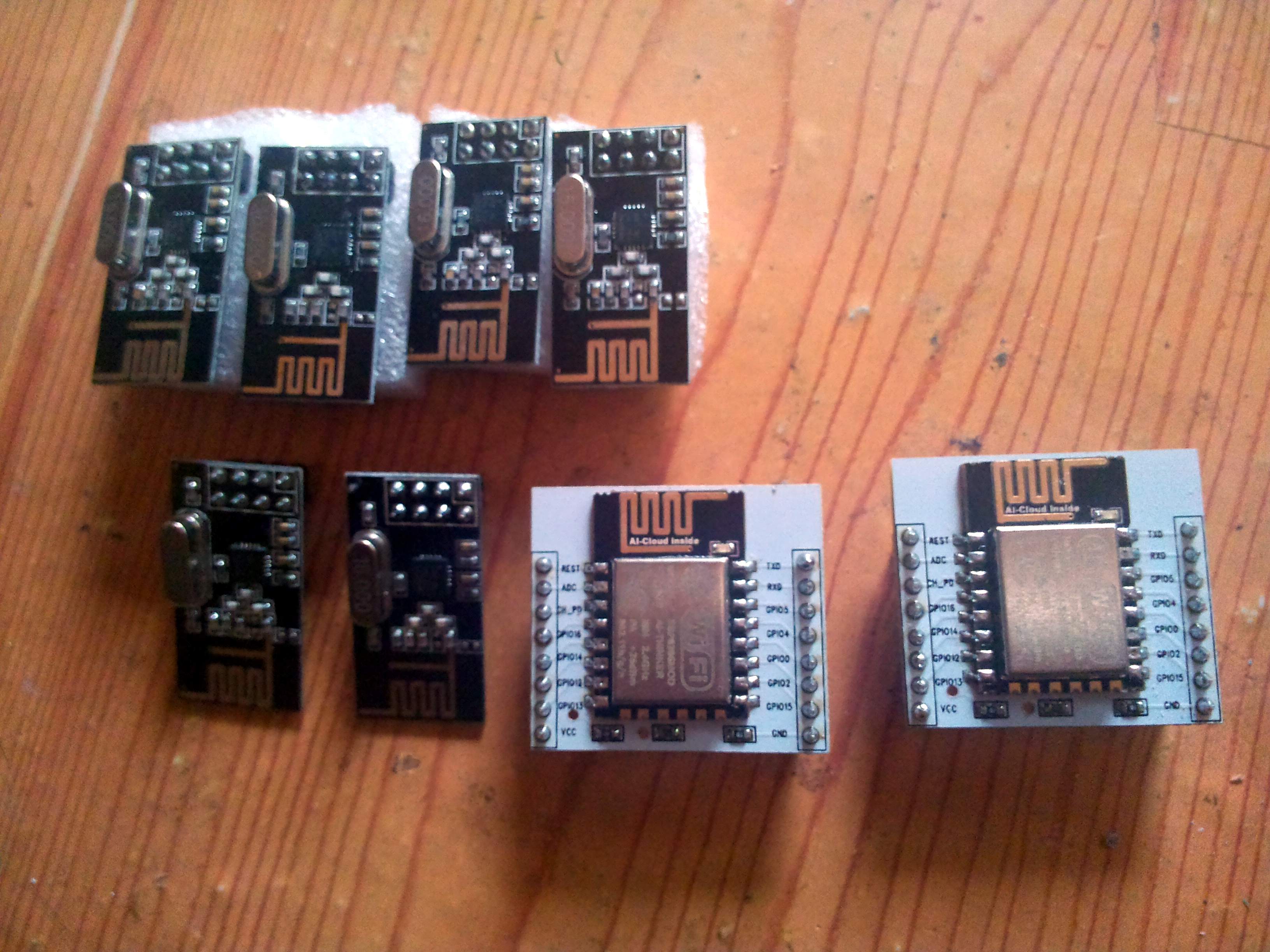

                I saw your code much more earlier on Github.
                Ever since than i am having it. Several months or so.
                But didn't have enough time to test it.
                That's for the code without your latest addition.
                I am interested in adding LCD on it and make it functional.
                But i am not skilled avr programmer yet. I can only write simple things.
                Playing with interrupts is the hardest part for me, still not learned that well.
                And i don't have nRF8001.
                I have 6pcs nRF24l01 and 2 pcs ESP8266MOD AI THINKER.
                Not sure if some of those is suitable for the task you want?
                I tested so far only nRF24l01 and it works pretty straightforward.
                ESP8266 is quite different beast... demands more serious effort.
