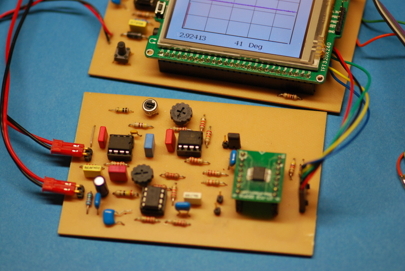

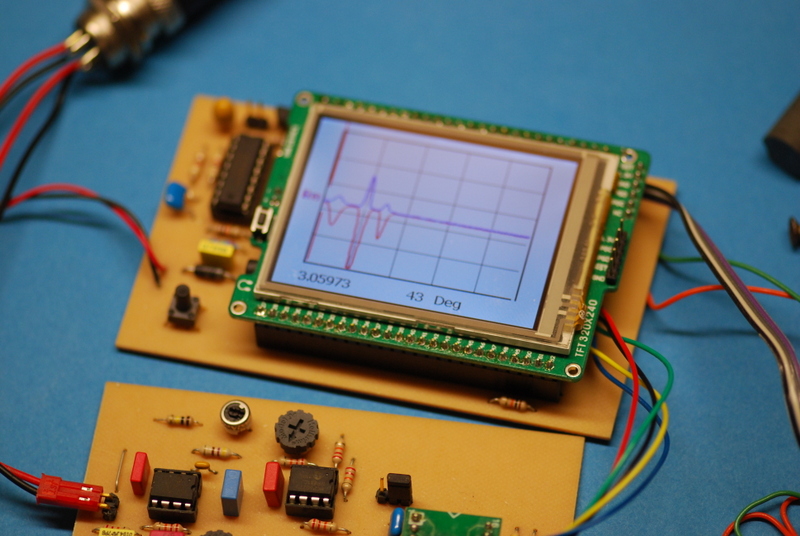

      You maybe able to adapt this prototype front end I built for a dsp vlf. The ad5933 has a bulit in dac that generates a 3V sinewave output. This output is ac coupled through C8 and R17 to the non inverting input of a TCA0372 power opamp. The Tx gain is adjusted for a symetrical, non distorted output on TP (approx. 10V). R19 and C15 filter high frequecy noise, which I did on a trial and error basis depending on the tx frequency and coil. The TX coil should have inductance in the 500 to 1000uh range. C13 on the tx virtual ground caused uncontrolable oscillations as drawn in the schematic. It should be increased to 100uf or disconnect from pin 6 and connect to pin 2. The circuit actually worked well and was able to gb and target ID. But I was using a TFT display and it turned into a user interface project and then got side tracked on something else.
        @Altra: Thanks a lot for sharing your schematic, really interesting project - very close to what I'm trying to achieve I didn't know such high current output op-amp exist, could be a good candidate since I don't need any amplification at all, a buffer would be good enough.

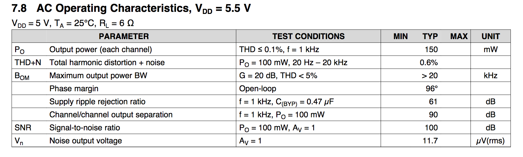

        What I've found in my parts bin is a TPA6111A2 (http://www.ti.com/product/tpa6112a2) which is able to drive 150mW into an 16Ohm load.
        Interesting fact is the datasheet of the TPA6111A2 has a section for a 6 Ohm load (I'm not sure whether this is a typo):
        So my plan is to add a voltage divider to the DAC's output to linearly map the 1Vrms to an achievable range for the amplifier.
        Question is whether the TPA6111 is unity gain stable
