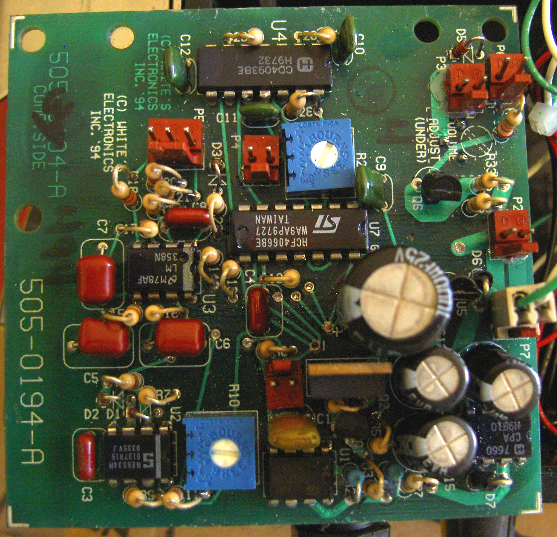

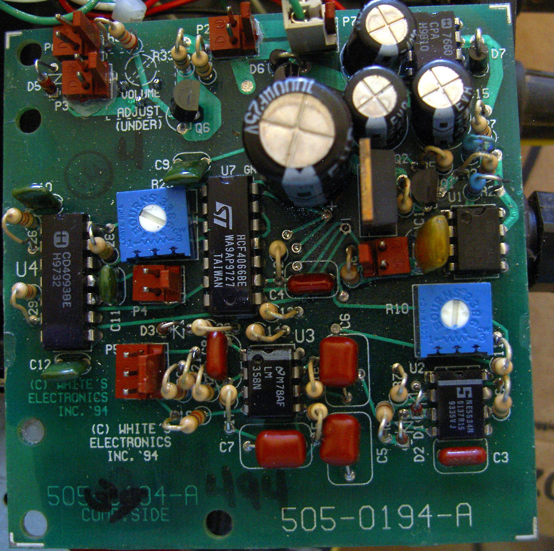

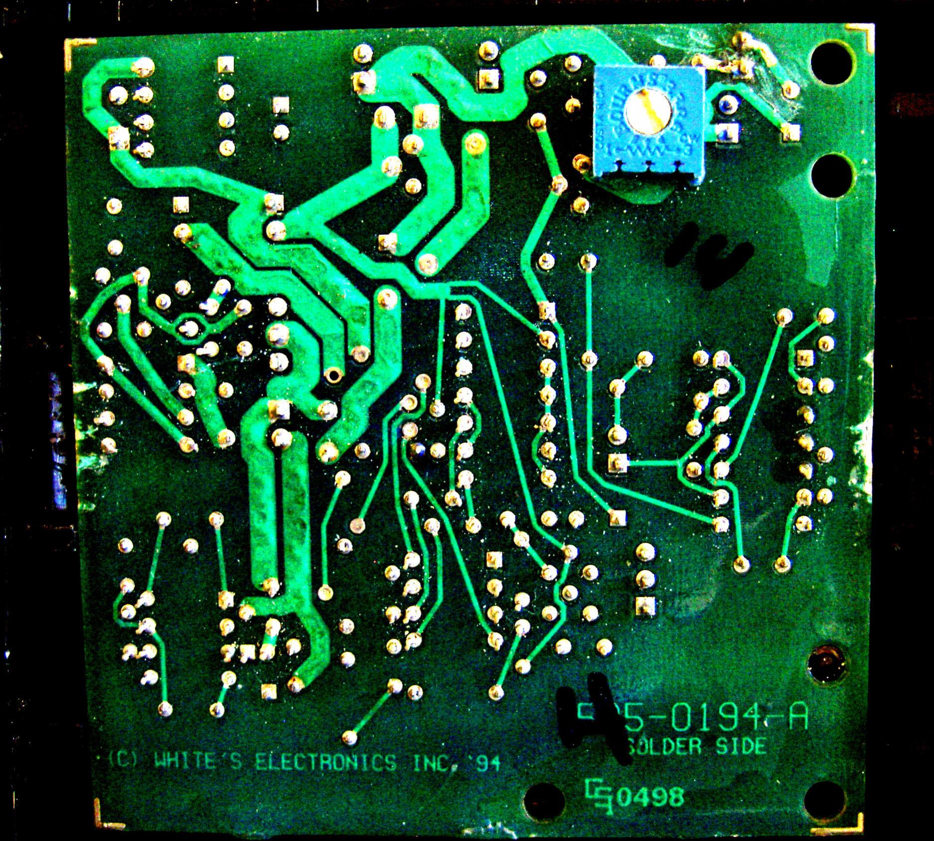

                  hi , as i tell before , here the principal components of my SMPI
                  -U1 = MAL TSS55CN
                  -U2 = NE 5534N
                  -U3 = LM358N
                  -U4 = HC4066BE
                  -U6 = 7660 CPA
                  -U7 = HCF4066BE
                  searchhead driver = TIP32 and nearest : 2N3906
                  soon as possible i'll send you pics
                  bye
                    could you also post the pics here on the forum if possible?
                      hi ! dear friends here the pics , sorry for resolution , it' s my only camera

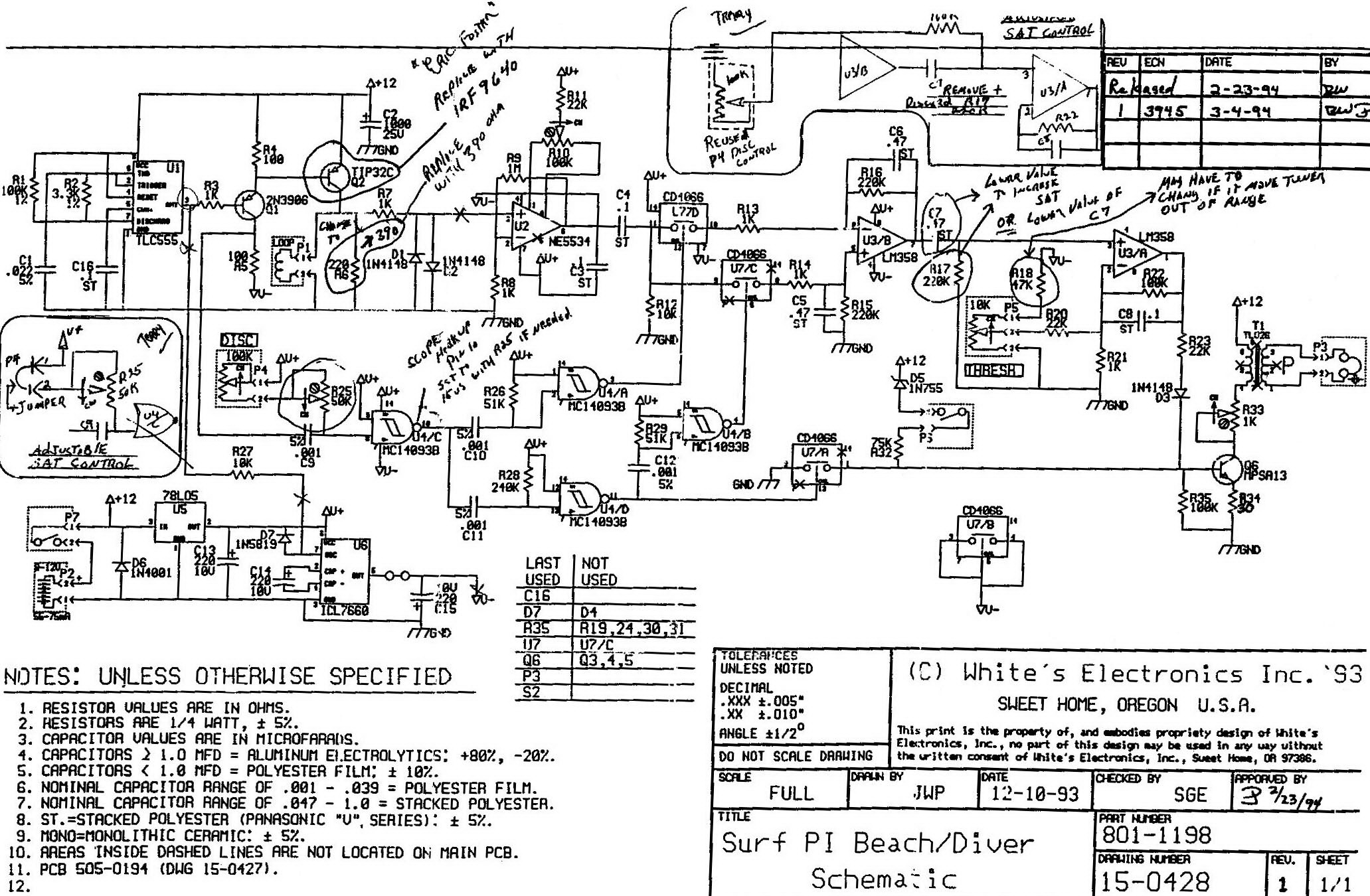

                        thank you lots AK48. i have pics of '505-0227' board signed and your one seems upward just cause your is '505-0194'.
                        probably your board is fully matched with the schematic attachedSurfmaster_PI_sch.pdfClick image for larger version

                          hi ! you're right man , my board matched with your attached pic ,
                            hi! i've got à good question for good technicien , if my board is " 505-0194 " and the coil driver is a TIP32 , i want to upgrade it with the IRF9640 !!! can i do , what will be the result ? my SMPI will go deeper ? will i used the same coil ? the rest of the components seems the same , can you show me what componentes i must replace and show me the final board scheme , thank you . AK48
                              simply replace tip32 by irf9340 and resistor 220 by 390.
                              Result is best gold sensivity.
