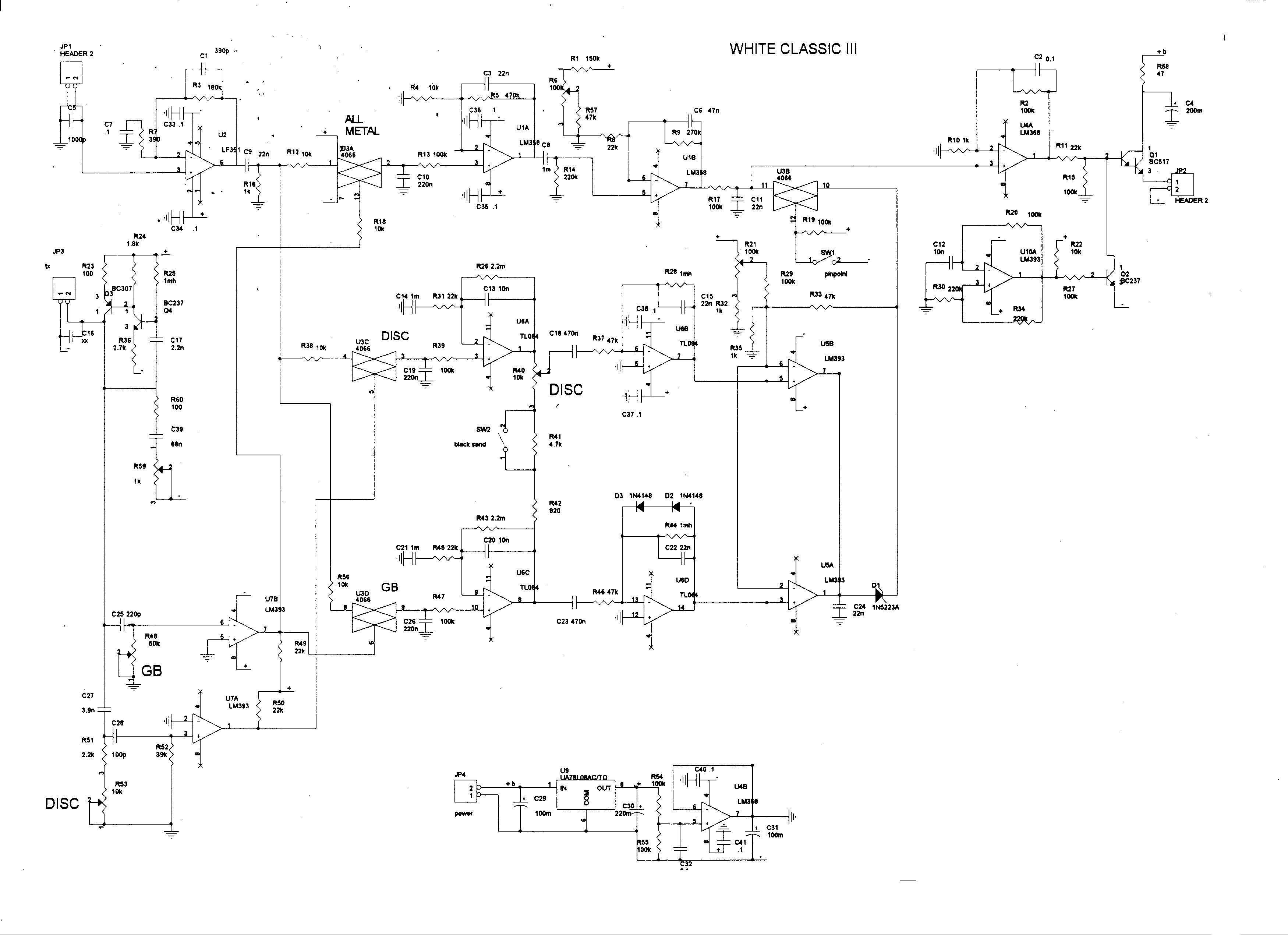

    Hi all
    I'm building classic III as a schematic find on a russian site but i'm not sure if this schematic is correct.
    No one have a classic III schematic?
    Here is my schematic.
    Thanks in advant for any suggestion or correction.
    Bye Max
    Re: White Classic III
    MAX,
    the device was been back-engineering by our collegue Ivan K. I has did a comparision with Classic I shematic that was been sent at the forum (great thankings!) and it was all OK.
    yours
        Hi Kt315
        The design i post on forum is a my mix from schematic of classic III and I.
        I take bf stage from classic I e put same decupling capacitors on power pin of operationals.

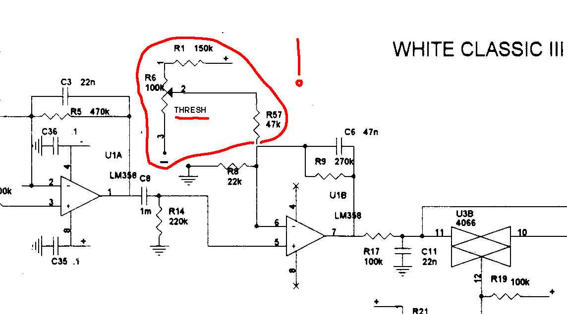

        For sure in my design there is a my error, i connect r33 on pin 6 of u5 instead on pin5.
        I built this device but seem there are same problems on all metal channel , i'm not a electronic engineer but find strange the connession of r1,r6,r57, in this way pin 6 u1b is always at ground.
        Other problem is that i cant ground balancing and disc, even in disc mode the device act as in all metal, i presume there is same phase problem.
        Bye Max
          Re: error !
          Hi sevzirfo
          I havent see before yours hint.
          Now is clear, as i said at Kt315 i suppose that there was a error in this part of schematic but i was not sure how solve the problem.
          Thank a lot
