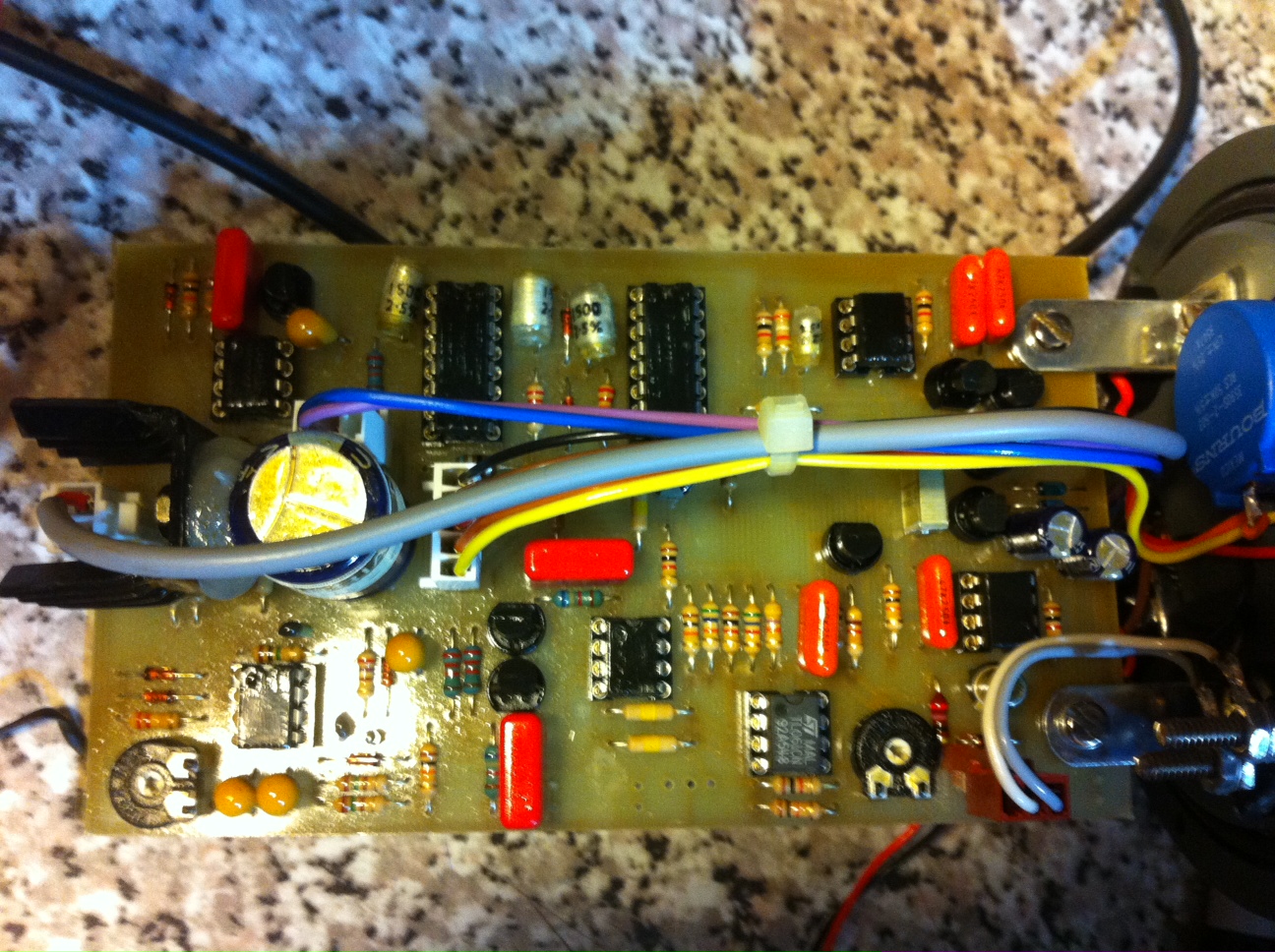

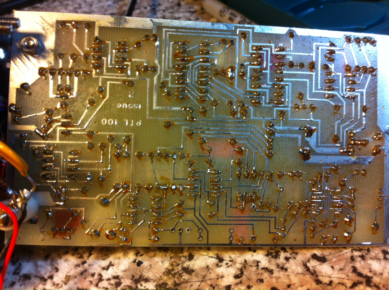

    to my sorry some man name Nelson L. did refuse me to give high resolution pics. this is a cause we still have not good schematic.
    Nelson wrote:
    Hello Anatloy
    Well i was a little busy with lots of things in mind and also to much work to do. It will be nice for me to have full of my time to work on metal detectors, but unfortunally i have to work, be incharge of my family and also taking care of my wife health that now is much better. So far i will try to get new pictures from aquapulse and then i will send it to you.
    About Whites TDI, do you have the schematics for it?
    Thanks for taking the time to write me and i will be back has soon has i can take the pictures.
    Best regards
    Nelson
    2014-10-29 19:01 GMT-03:00 <[email protected]>:
    hello Nelson,
    this is kt315 writes you now. I do reply on your request. I got from you - two blur pics
    low resolution of pcb while I asked you hight resolution pics, at sunny day, both side,
    if possible of desoldered pcb, part list, measured details values.
    on this point you disappered.
    best regards
    Anatloy

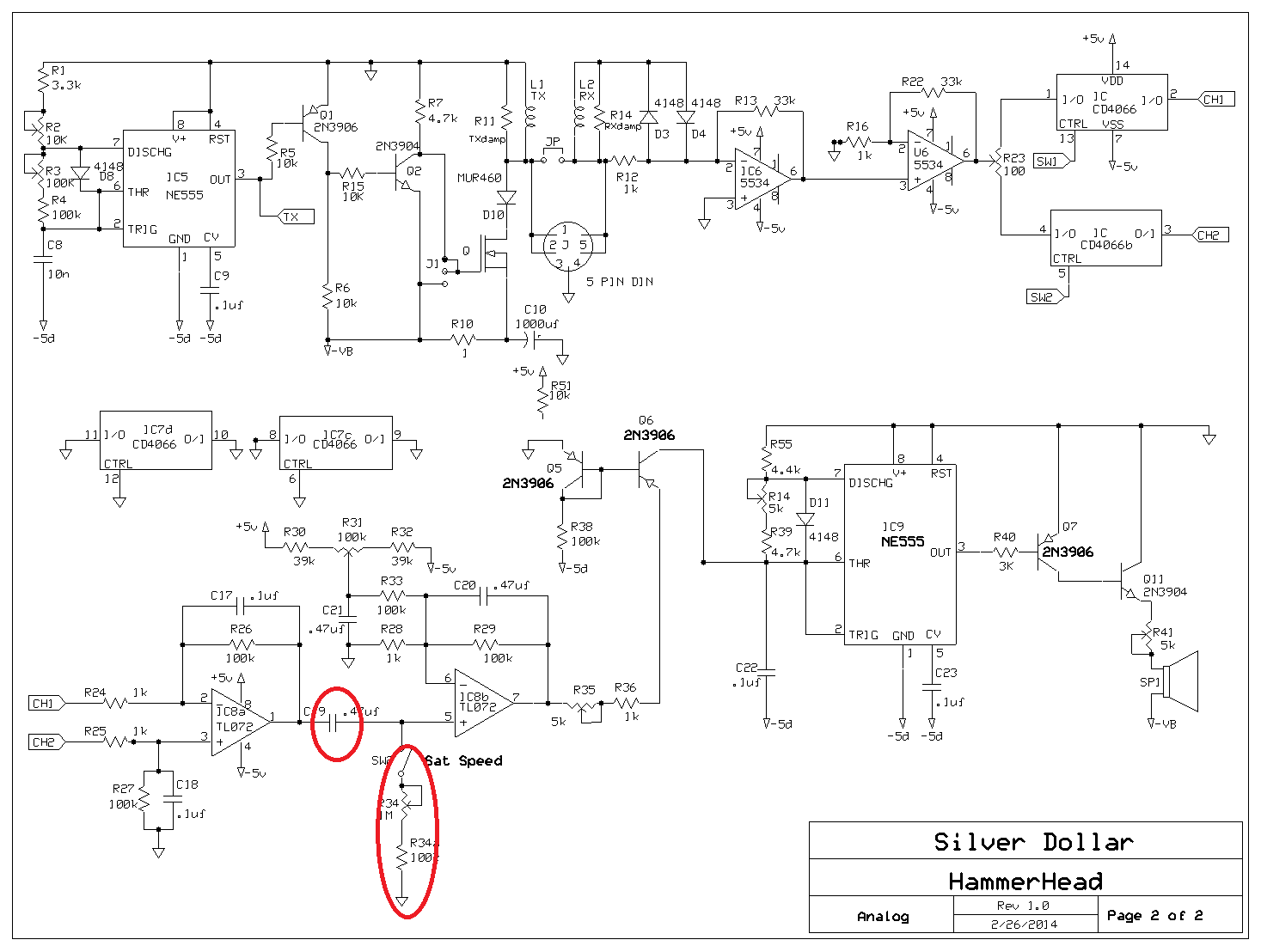

          A better answer is that the schematic has never been published so it is hard to help you
          as you need to add a cap and resistor to the correct place to create a SAT.
          Here is the HammerHead with the SAT components circled. If you can draw a schematic
          or partial schematic to locate where the parts need to be added then it's easy to do!
          If Ferric Toes is around he might be able to point you in the right direction...

            moderator, i ask AGAIN to BAN this poster ivconic for idiotic constant flood under every my posting.
              [ATTACH]36765[/ATTACH][ATTACH]36766[/ATTACH]
              You only have to ask me, my big friend, Anatloy.
              I gladly do it for you.
              Here you have the very crisp high resolution pictures in bright sun light.[IMG][/IMG]
              [IMG][/IMG]
