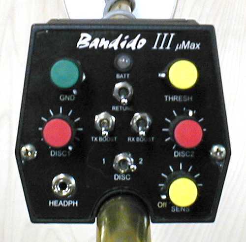

      Wait! Bandido II pic...
      What are the two center switches?
      What switch is all metal mode?
      I have a momentary labled pinpoint. Another is disc/all metal. When in all metal it is in the auto mode only. The pinpoint will activate the normal mode which will also interrupt the disc mode. I thought it was a neat way to do the normal mode.
        Re: Wait! Bandido II pic...
        TX boost & RX boost. They are unimplemented right now.
        It is a trigger switch (on-off-mom) under the box, sorta like a White's.
        - Carl
          Bandido III
          Ahh.
          Then you must have an idea for such a boost?
          More depth?
            Re: Bandido III
            For RX boost, I had planned to up the front-end gain. Might work for low-noise environments, where mineralization is also low. For TX boost, I was going to twiddle the Colpitts bias current, but as I recall, it's alread maxxed out. So now maybe convert that switch to salt mode!

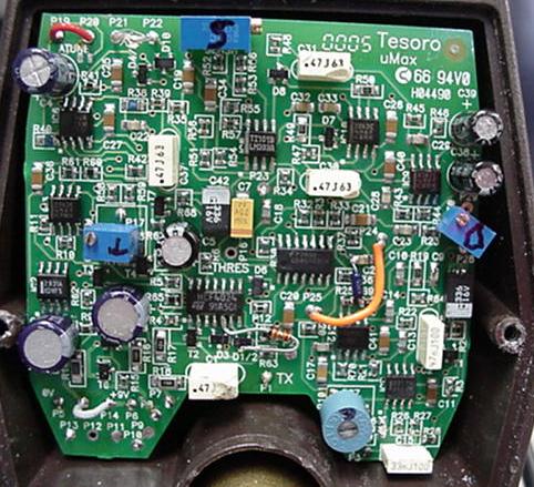

                    Component side
                      Re: Component side question ....
                      Hi
                      This component side is from Bandido II ?
                      Goodrat You have a pic. of bottom side ?
                      sog
                        It's a Cutlass II converted to a Bandido II and all the pots are put on board.
