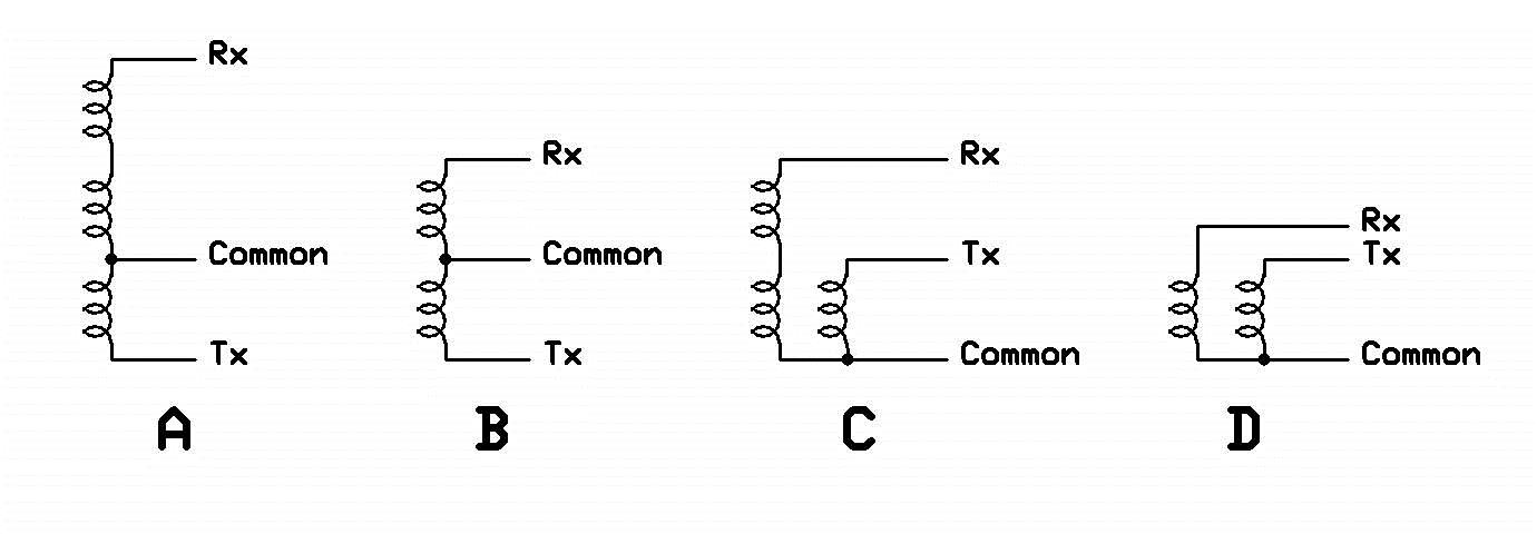

              Now... i can think on at least four different cases:
              Would be interesting to do a "study" and analyze each one of the cases; benefits and drawbacks.
              Small and simpler PI design such as Barracuda is; would be suitable as experimenting platform for this.

                        I wonder; would my "cases" makes any sense?
                        Now on second thought; i think it would mainly depends on how TX and RX front end are designed.
                        With common approach there should not be any problem to try either of cases.
                        In TX period; RX is clamped with diodes anyway.
                        When TX is shut off; RX will pick up only the RX "side" of coil, regardless what's happening or was left in TX "side" of coil.
                        Hmmm... does this makes any sense?
                        • #57
                          "...When TX is shut off; RX will pick up only the RX "side" of coil, regardless what's happening or was left in TX "side" of coil..."
                          On second "second" thought; this is not true!
                          Since TX and RX are close parts of the same coil; RX will be also inductively coupled with TX!
                          Cases "A" and "B" are presenting coils wounded in same direction, cases "C" and "D" in opposite.
                          So... in cases "A" and "B" we will have directly picked RX signal with additional portion of induced signal with same polarity.
                          In cases "C" and "D" we will have directly picked RX signal with additional portion of induced signal with opposite polarity.
                          Story complicates even more in cases "A" and "C" where RX coil is having more turns than TX coil...
                          Sheeesh! I am lost!

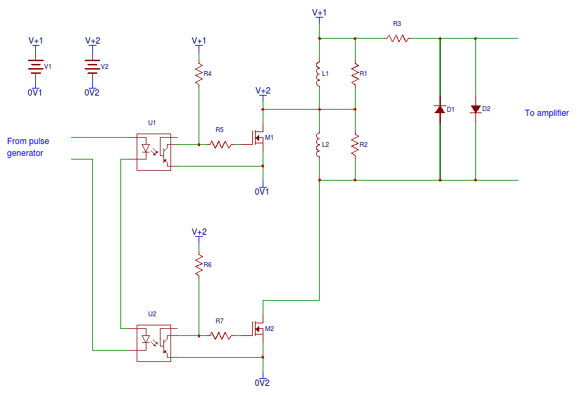

                              Just a thinking to have less TX inductance but more on RX...
                              • #60
                                That makes sense.
                                From your schematic is obvious that L1 and L2 must be identical.
                                Would be interesting to see such coil in "OO" arrangement!
                                Remember the "8" coil benefits!
