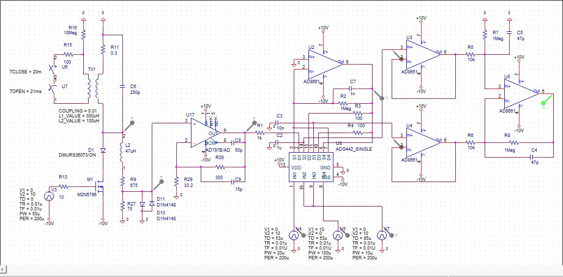

                          Originally posted by Phiphi View Post
                          Next time, I'll present my ideas for the receiver following the preamp.
                          Here is coming what I have imagined for the receiver part. I think it's quite original and I'd like to have your feeling about this idea.
                          The schematics of the PSpice simulation is below :
                          Let's me describe this schematics.
                          On the left you have recognized the Tx I have described in my previous posts. Between 20ms and 21ms, U6 is closed to simulate a target entering below the coil.
                          The output of the preamp enters in an integrator done with switches S1-D1 and S4-D4 of the ADG442 (a 4 SPST switch with low charge injection). The integration begins 3 us after Tx off for a 20 us duration. After that, the integrator is reseted thanks to S4-D4.
                          The integrator output is sampled, during 10 us, 35 us after Tx off with two different time constant. The first time constant (S3-D3) is low, 1 us (100 ohms, 10 nF) so the signal sampled reacts quickly to level variations. The second time constant (S2-D2) is high, 100 us (100 ohms, 1 uF) so the signal sampled doesn't react to slow variations as those coming from ground response.
                          The three opamps group (U3,U4 and U5) acts as an instrumentation amplifier and amplifies the difference between the sampled outputs with a 100 gain. So with no target, the output is near zero even with a ground response varying slowly but when a target pass under the coil, there is a quick variation detected by the fast sampling and the output varies allowing the detection.

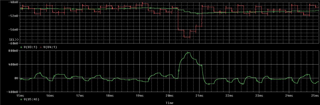

                          Below are some waveforms issued from the simulation :
Name:	Receiver out waveforms.JPG
                          The green waveform at the bottom is the output of the instrumentation amplifier showing the variation between 20 ms and 21 ms when the target is present.
                          The two waveforms on top are the two sampled outputs with high RC (in green) and low RC (in red)
                          The different time constants are chosen approximatively and need likely to be adjusted but I wanted just to present the idea: amplify only the difference between integration with two different time constants.
                          Don't hesitate to ask me more waveforms or explanations because I am not sure to be very clear !
                          • #88
                            Hi Phiphi,
                            With that sampling method you'll have issues with Earth Field response, when the coil is swept over the ground. The same will happen in areas containing highly magnetic ground like seen in Australia.
                            • #89
                              R9 and R27 are forming a voltage divider so the input to your first amplifier is 1/10 vcoil. The first amp gain is approx 10 ... so your amplifier gain is effectively lost by the input divider R27/R9.
                              • #90
                                Hi Phiphi,
                                Could you explain why ? I suppose that these responses have only slow variations in the sweeping range of the coil so there won't be a significant signal at the output of the differential amplifier.
