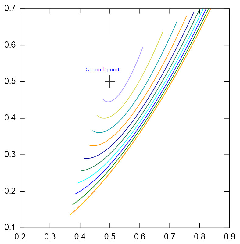

    The solution I propose is to use 3 successive samples s1, s2, s3 at times t, 2t and 4t. In the presence of pure ground (thus no targets) and assuming the usual invariant 1/t ground response, the amplitude ratios of successive samples is as follows:
    s2/s1 = (1/2t)/(1/t) = 0.5
    s3/s2 = (1/4t)/(1/2t) = 0.5
    We express this as the point (0.5, 0.5) on a plane. This is the Ground point.
    GP = (0.5, 0.5)
    A target with TC = tau will have the following ratios:
    s2/s1 = exp(-t2/tau)/exp(-t1/tau)
    s3/s2 = exp(-t3/tau)/exp(-t2/tau)
    We express this as the target point (exp(-t2/tau)/exp(-t1/tau), exp(-t3/tau)/exp(-t2/tau)) on a plane. This is the Target point.

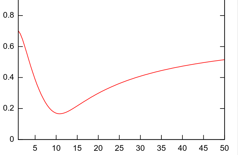

    This is a plot of the euclidean distance between the Target and the Ground point. They never meet, which solves the problem of the GB holes.
    sqrt((exp(-10/tau)/exp(-5/tau)-0.5)**2 + (exp(-20/tau)/exp(-10/tau)-0.5)**2))

          The following chart shows how different mixtures of target and ground behave. The TCs vary between 5us and 30us.
          The outer (orange) line is 100% target, the next line is a mix of 90% target and 10% ground ... then so on until the last line which is 10% target 90% ground.

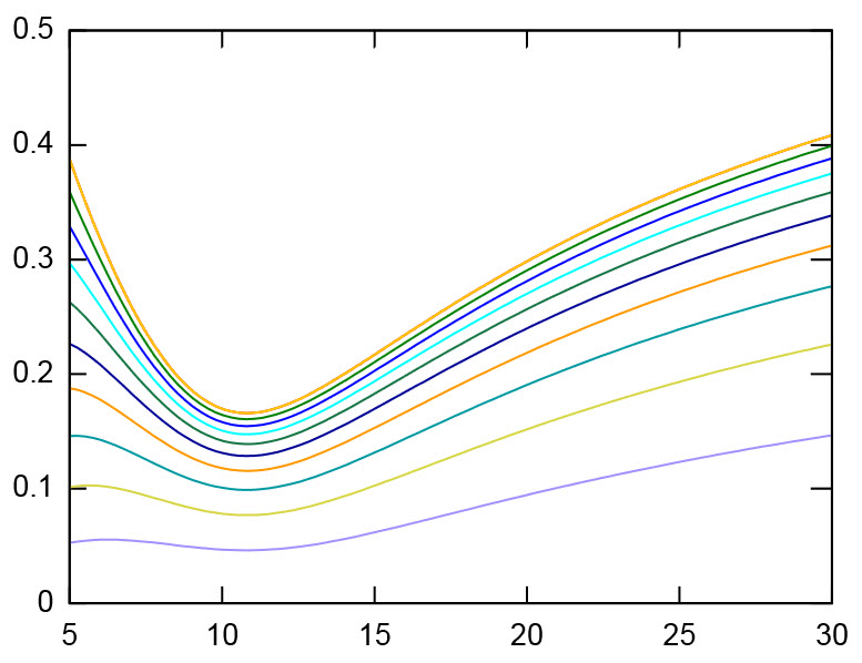

          in this plot we see the distances to Ground Point of all the above target/ground mixtures:
          We see that a distance threshold of about 0.1 can tell a target in a signal that's 70% ground. A threshold of 0.05 works in 90% ground.

          gnuplot of the above graphs:
          Code:
          set terminal svg size 400,400 enhanced fname 'arial'  fsize 10 butt solid
          set output 'out.svg'
          set style fill transparent solid 0.35 noborder
          set style circle radius 0.02
          set parametric
          set xrange [0.2:0.9]
          set yrange [0.1:0.7]
          unset key
          plot [5:30] (1*exp(-10/t)+0/10)/(1*exp(-5/t)+0/5), (1*exp(-20/t)+0/20)/(1*exp(-10/t)+0/10) with lines, (0.9*exp(-10/t)+0.1/10)/(0.9*exp(-5/t)+0.1/5), (0.9*exp(-20/t)+0.1/20)/(0.9*exp(-10/t)+0.1/10) with lines, (0.8*exp(-10/t)+0.2/10)/(0.8*exp(-5/t)+0.2/5), (0.8*exp(-20/t)+0.2/20)/(0.8*exp(-10/t)+0.2/10) with lines, (0.7*exp(-10/t)+0.3/10)/(0.7*exp(-5/t)+0.3/5), (0.7*exp(-20/t)+0.3/20)/(0.7*exp(-10/t)+0.3/10) with lines, (0.6*exp(-10/t)+0.4/10)/(0.6*exp(-5/t)+0.4/5), (0.6*exp(-20/t)+0.4/20)/(0.6*exp(-10/t)+0.4/10) with lines, (0.5*exp(-10/t)+0.5/10)/(0.5*exp(-5/t)+0.5/5), (0.5*exp(-20/t)+0.5/20)/(0.5*exp(-10/t)+0.5/10) with lines, (0.4*exp(-10/t)+0.6/10)/(0.4*exp(-5/t)+0.6/5), (0.4*exp(-20/t)+0.6/20)/(0.4*exp(-10/t)+0.6/10) with lines, (0.3*exp(-10/t)+0.7/10)/(0.3*exp(-5/t)+0.7/5), (0.3*exp(-20/t)+0.7/20)/(0.3*exp(-10/t)+0.7/10) with lines, (0.2*exp(-10/t)+0.8/10)/(0.2*exp(-5/t)+0.8/5), (0.2*exp(-20/t)+0.8/20)/(0.2*exp(-10/t)+0.8/10) with lines, (0.1*exp(-10/t)+0.9/10)/(0.1*exp(-5/t)+0.9/5), (0.1*exp(-20/t)+0.9/20)/(0.1*exp(-10/t)+0.9/10) with lines, (1.38777878078145e-16*exp(-10/t)+1/10)/(1.38777878078145e-16*exp(-5/t)+1/5), (1.38777878078145e-16*exp(-20/t)+1/20)/(1.38777878078145e-16*exp(-10/t)+1/10) with lines
          set terminal svg size 400,300 enhanced fname 'arial'  fsize 10 butt solid
          set nokey
          set xrange [5:30]
          set yrange [0:0.5]
          plot sqrt(((1*exp(-10/x)+0/10)/(1*exp(-5/x)+0/5) - 0.5)**2 + ((1*exp(-20/x)+0/20)/(1*exp(-10/x)+0/10) - 0.5)**2) with lines, sqrt(((0.9*exp(-10/x)+0.1/10)/(0.9*exp(-5/x)+0.1/5) - 0.5)**2 + ((0.9*exp(-20/x)+0.1/20)/(0.9*exp(-10/x)+0.1/10) - 0.5)**2) with lines, sqrt(((0.8*exp(-10/x)+0.2/10)/(0.8*exp(-5/x)+0.2/5) - 0.5)**2 + ((0.8*exp(-20/x)+0.2/20)/(0.8*exp(-10/x)+0.2/10) - 0.5)**2) with lines, sqrt(((0.7*exp(-10/x)+0.3/10)/(0.7*exp(-5/x)+0.3/5) - 0.5)**2 + ((0.7*exp(-20/x)+0.3/20)/(0.7*exp(-10/x)+0.3/10) - 0.5)**2) with lines, sqrt(((0.6*exp(-10/x)+0.4/10)/(0.6*exp(-5/x)+0.4/5) - 0.5)**2 + ((0.6*exp(-20/x)+0.4/20)/(0.6*exp(-10/x)+0.4/10) - 0.5)**2) with lines, sqrt(((0.5*exp(-10/x)+0.5/10)/(0.5*exp(-5/x)+0.5/5) - 0.5)**2 + ((0.5*exp(-20/x)+0.5/20)/(0.5*exp(-10/x)+0.5/10) - 0.5)**2) with lines, sqrt(((0.4*exp(-10/x)+0.6/10)/(0.4*exp(-5/x)+0.6/5) - 0.5)**2 + ((0.4*exp(-20/x)+0.6/20)/(0.4*exp(-10/x)+0.6/10) - 0.5)**2) with lines, sqrt(((0.3*exp(-10/x)+0.7/10)/(0.3*exp(-5/x)+0.7/5) - 0.5)**2 + ((0.3*exp(-20/x)+0.7/20)/(0.3*exp(-10/x)+0.7/10) - 0.5)**2) with lines, sqrt(((0.2*exp(-10/x)+0.8/10)/(0.2*exp(-5/x)+0.8/5) - 0.5)**2 + ((0.2*exp(-20/x)+0.8/20)/(0.2*exp(-10/x)+0.8/10) - 0.5)**2) with lines, sqrt(((0.1*exp(-10/x)+0.9/10)/(0.1*exp(-5/x)+0.9/5) - 0.5)**2 + ((0.1*exp(-20/x)+0.9/20)/(0.1*exp(-10/x)+0.9/10) - 0.5)**2) with lines, sqrt(((1.38777878078145e-16*exp(-10/x)+1/10)/(1.38777878078145e-16*exp(-5/x)+1/5) - 0.5)**2 + ((1.38777878078145e-16*exp(-20/x)+1/20)/(1.38777878078145e-16*exp(-10/x)+1/10) - 0.5)**2) with lines
