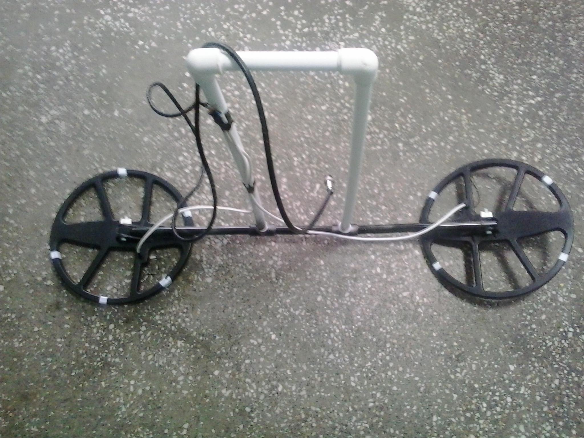

          Do you know Eric how to build a double coil for the XR-71? Because between trees is difficult use the big coil like 1x1mt
            This works !
            But he lost much of sensitivity !
            For how many laps more RX coil and whether the same thickness of wire ??Click image for larger version

              You should be able to use 1.5 - 2.0 times as many turns and much thinner wire on the RX, as there is no need for low resistance. The RX damping resistor can also be a higher value. You will have to experiment to find the best value.
              Remember, you will not detect small items such as single coins with this arrangement. Only good for cannonball size and upwards, e.g. treasure chests, metal boxes, helmets, armour, weapons, coin hoards, large metal pipes.

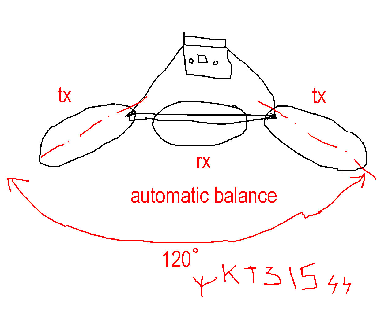

                    offer new sctructura design (C) (kt315)
                    you get the balance basically AUTOMATICALLY!
