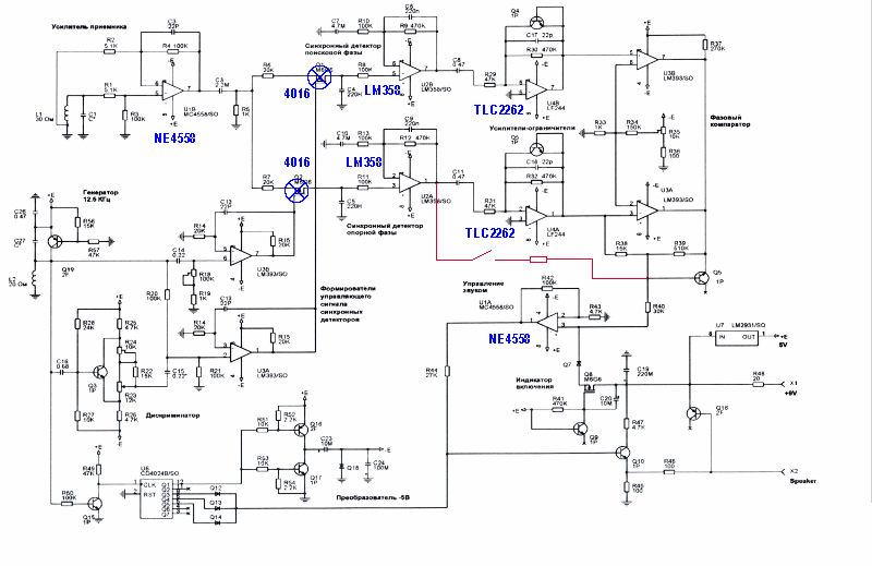

        Does someone have a Circuit diagram ?
        greetings, Carsten
          any forum in global net has a search engine. are you so beginner to begin use it?Click image for larger version

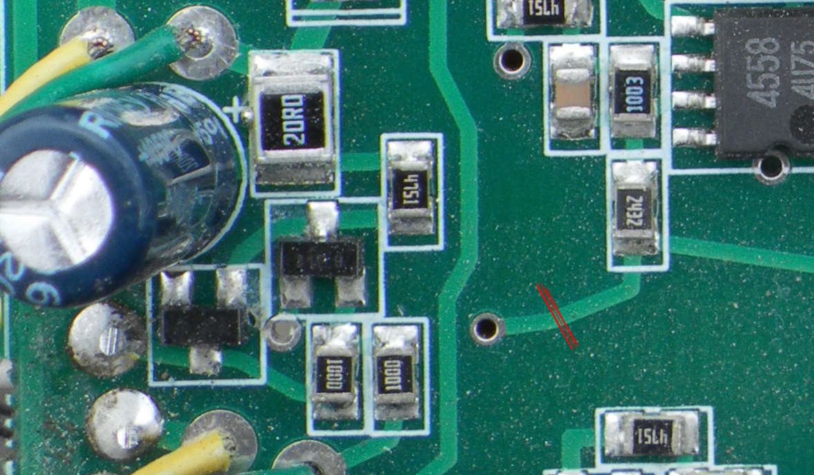

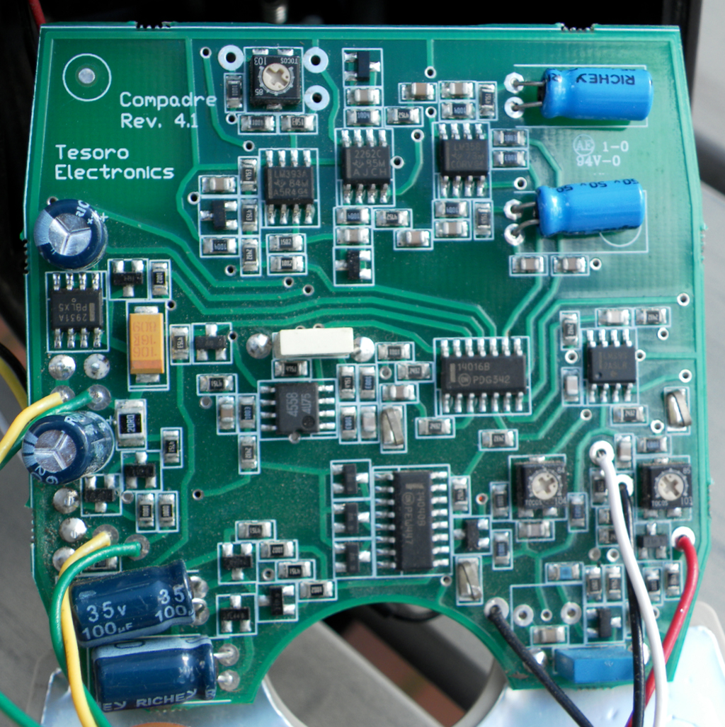

          can you give me hi resolution pics of your board from 2 sides, at sunny day light?

            Hi kt315,
            thanks for your reply.
            Yes I've found this picture you have posted , but I thought it was for the older compadre.

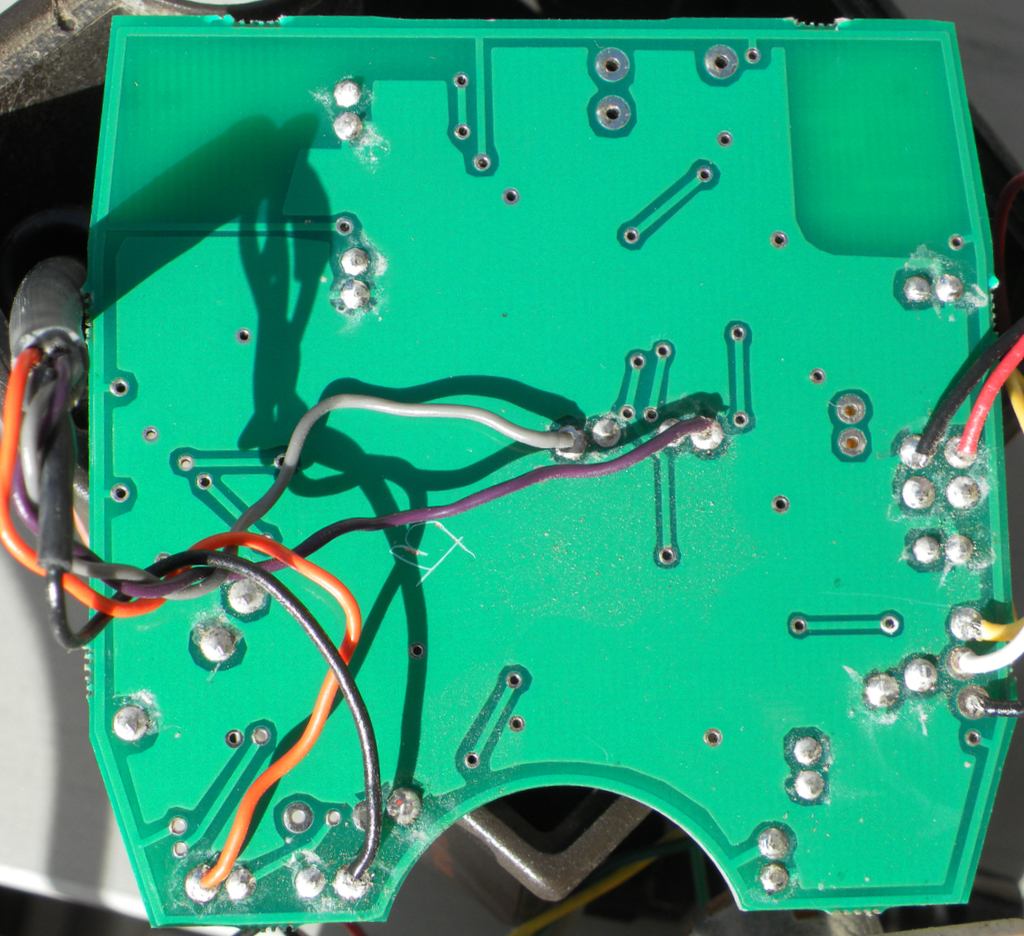

            I put the pictures of the two sides as attachment, hope the quality is ok.
            greetings Carsten
              hello Carsten, thank you. can you do more resolution pics and more lighten? pls send its to me on [email protected]

                  a schemaic above is Amigo, while some geotecher corrected it to Compadre. i can not claim you it seems all right on mistakes...

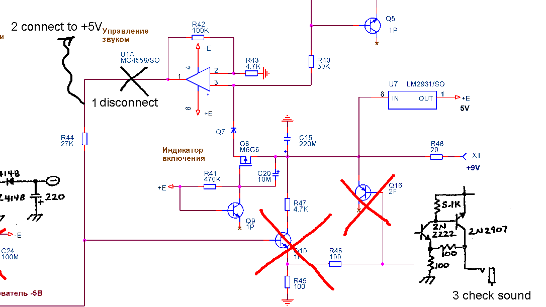

                      check sound. look at circuit Click image for larger version
                      (do not resolder transistors)
                        I try it tomorrow.
                        thanks a lot, Carsten
                          Most Tesoro's do nothing if the TX isn't correct.
                            hi kt315
                            I disconnect it , see the picture and put 5 V on the left side.
                            i've check the sound but no sound come out.
                            Only a klick sounds when i put 5 V on it.
