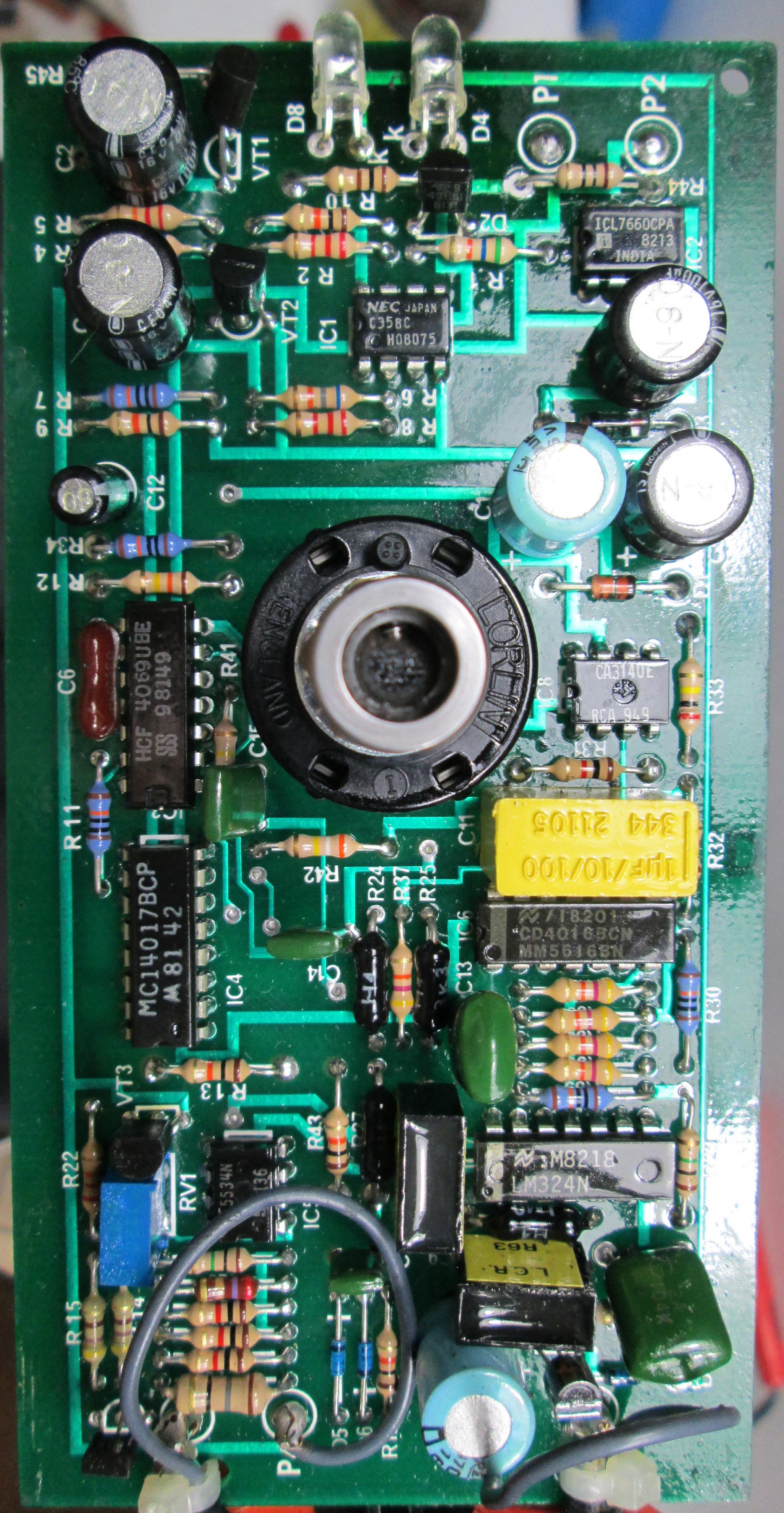

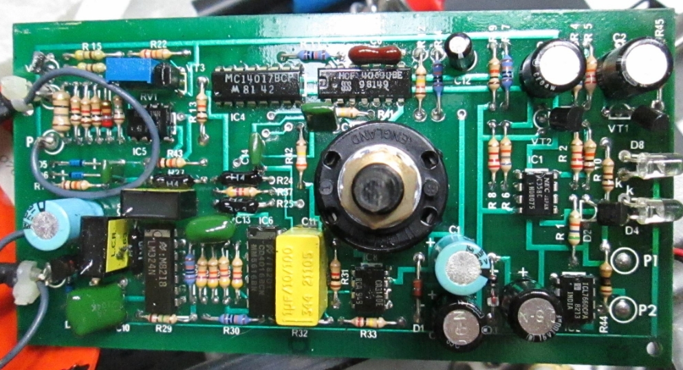

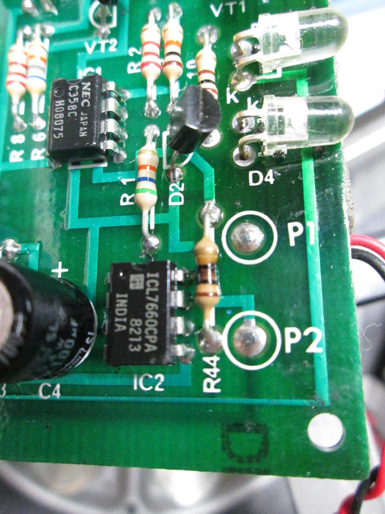

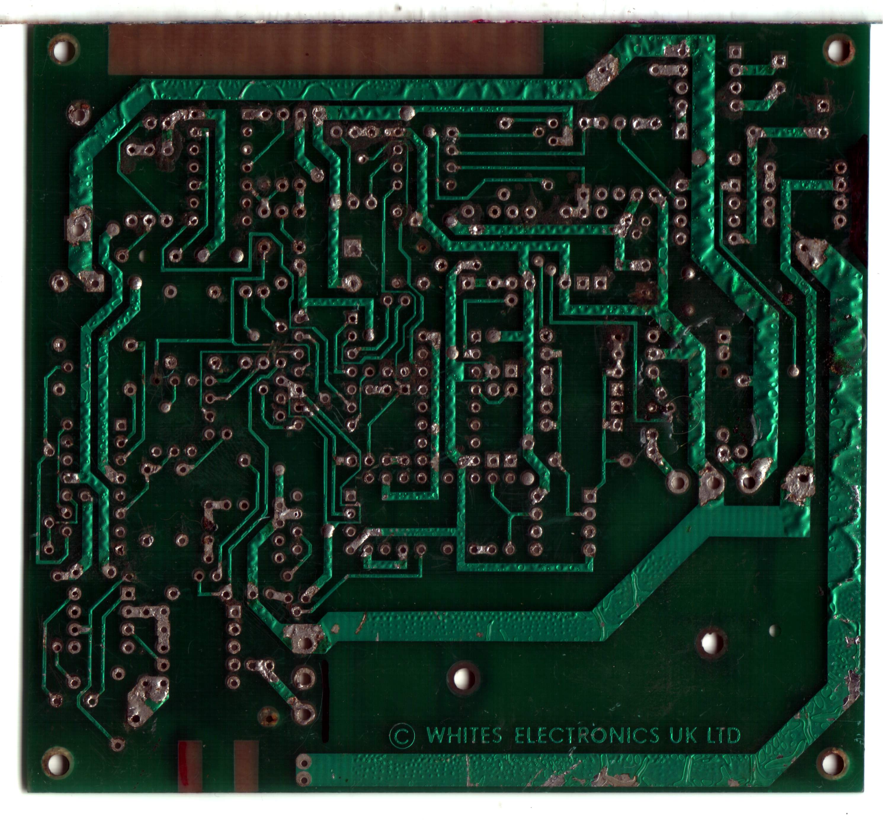

    Anybody recognize this one:
    3900
      Surf PI dual field
        mine detector
Name:	AF108 Mine Detector_sch.jpg
ID:	346837 look on q2 and q6
          It is not 3900 for sure.
          Most likely it is PI and something as SurfPi.
          I haven't seen original pcb from it anywhere so far, that's why i am not sure.
          It is also not AF108 because i have photos of original AF108 pcb.
          Could it be SurfPI?
          Most probably is... or some variation.
          Anybody have photos of original SurfPI pcb?
            And yet...!?

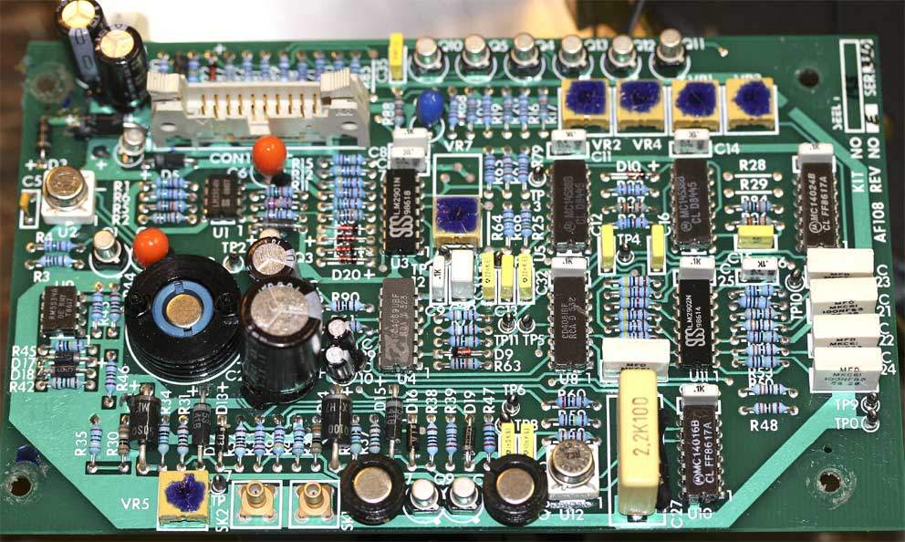

              AF108:
                Judging from IC's and other component's, should be Surf pi 99%.

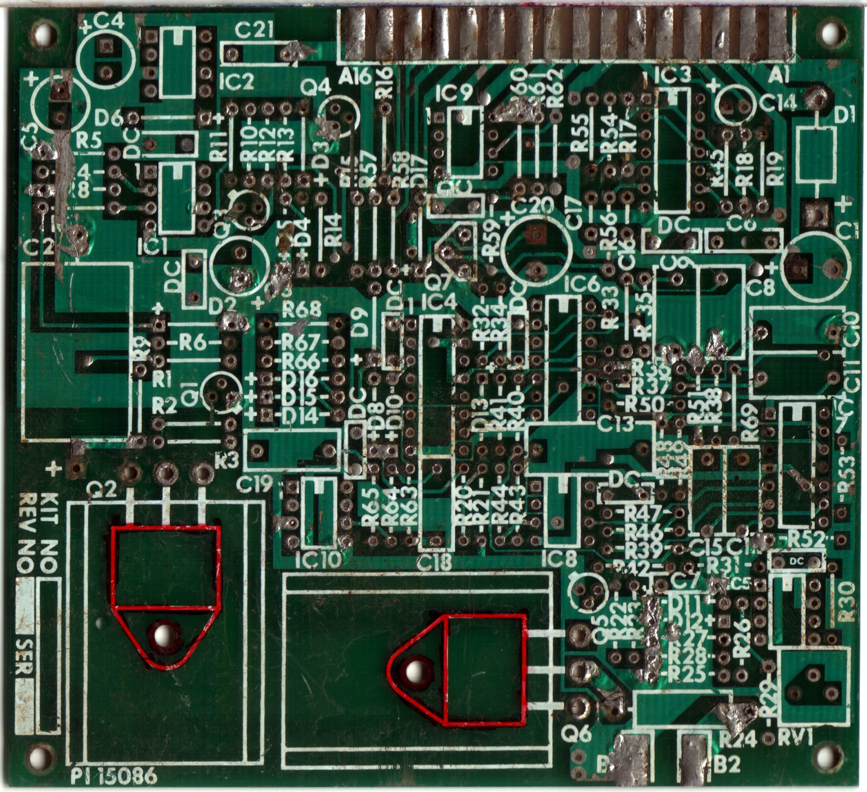

                  White's-UK developed several PI detectors independently of White's-US. I have a "PI-1500" pipe locator which is what I first thought your board might be for, but the board is too big (looks to be ~10cm square) to fit in the box. White's-UK also developed the old PI-1000 through PI-3000 diver models, I'm not sure how big the enclosures were but they might be big enough. And UK also designed one of the PI mine detectors, but I doubt that's what you have. I can say very confidently your board is not any variant of the Surf PI, which was designed and built only by the US factory. Plus this board looks too old. My inclination is the PI-1000.
                    Yes, i missed to mention the dimensions, those are 12x10cm.
                    It also has a "slot" type of connection on one side, as on photo, typical for much older White's designs.
                    I've seen such "slot" last time on 3900, though not used there too.
                    Since it has clearly marked two power transistors; 99% is a PI detector and not IB.
                    PI-1000 that you are mentioning is very good lead! I will try to compare and trace some parts.
                    Thanks!
                      I guess i will have to completely remove the paint, to be 100% sure in traces and vias.
                      The way it is now; i can only sketch it up roughly, maybe good enough to recognize it.

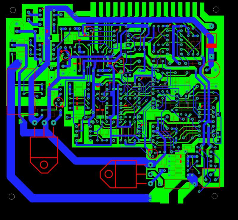

                      So i did fast preliminary sketching.
                        PI-1000 board
                        4pcs DIP8, 3pcs DIP14, 1pc DIP16
                          Could there be a clue bottom left "PI15086"
                          PI 150. In 1986
                          Just a guess
                          Pulse Induction detectors are now widely used in the construction industry; the Whites PI-150 is an industrial machine which can detect large objects to 10 feet, using a 12 or 15 inch coil.
                            something industrial IMO... good for release if there is existing full BOM...

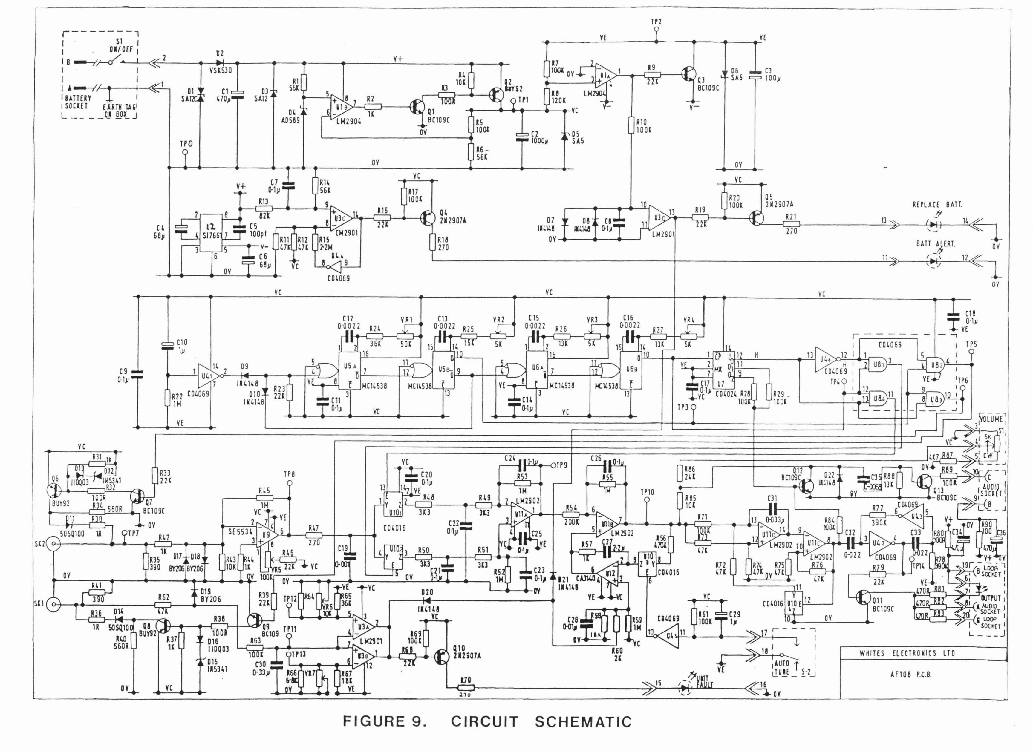

                              pi1000 schematic
                              whites pi 1000.pdf
