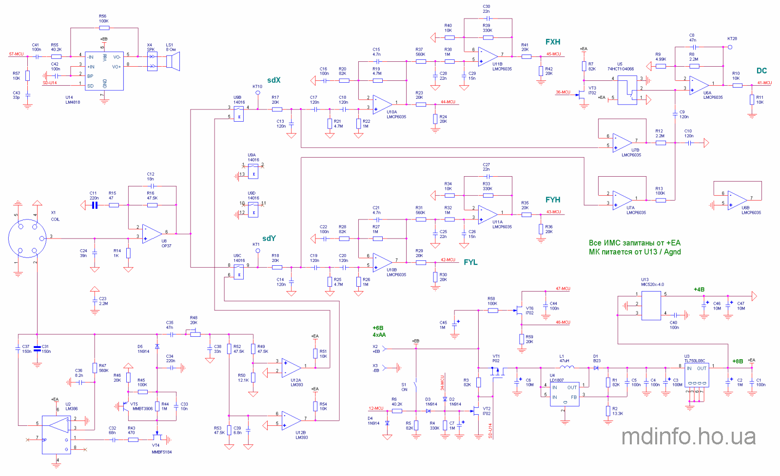

    I've bee thinking since few month of a vlf detector working with 2 MCUs (ATMEGA328P for example).
    The first one would generate the transmit signal (PWM), acquisition (12 bits SPI ADC) and generate interrupts.
    The second one would takes care of the signal processing and VDI display when an interrupt is received.
    The idea comes from the very low price of ATMEGA and its memory limitation.
    Before starting the project, i want to collect your ideas about that.
    I like the KROT2 TX circuitry
    xlt on steroids. good plan although...
      I started yesterday making the layout.
      The schematic is in my head, i'll edit it soon.
      The two ATMEGA328p will be linked together by serial link.
      The TX/RX MCU uses tho PWM lines, the first one is for TX generating and the second one drives a transistor and a RC cell wich will provide a negative DC supply for the VCA gain adjustment. The more signal width = the more negative signal = the more gain.
      I'm planning to use a SPI 12 bits ADC or maybe, the 8 bits internal ADC will be ok ... i don't know. The KROT project use internal ADC so, it should work like this. I'd like to have advices for this please.
      The second MCU will drive a 160X128 pixel LCD with touch screen... sounds good.
      The 1st MCU out the clock on CLK0 for the second one set to external clock.
      The all project will be FREE and the sources code will be available for everyone.
        maybe do you want to continue QED project? only question.

                          garret ace-250 uses very simple concept. all does analog part, uchip used only for LCD.
