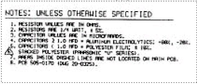

    Who could read the text?
    Re: Classic I Schematic
    Hello
    What i read:
    1. resistor values are in ohms
    2. resistor are 1/4 w, ????
    3 capacitor values are in microfarads.
    4 capacitor > 1.0 MFD Aluminium electrolytics??.
    5 capacitors < 1.0 MFD polyester film +/- 10 %.
    6 STACK polyester panasonic "U" SERIES".
    7 aera inside dashed lines are not located on the main PCB.
    8 PCB 505-170 1DUG 2D ????????.
