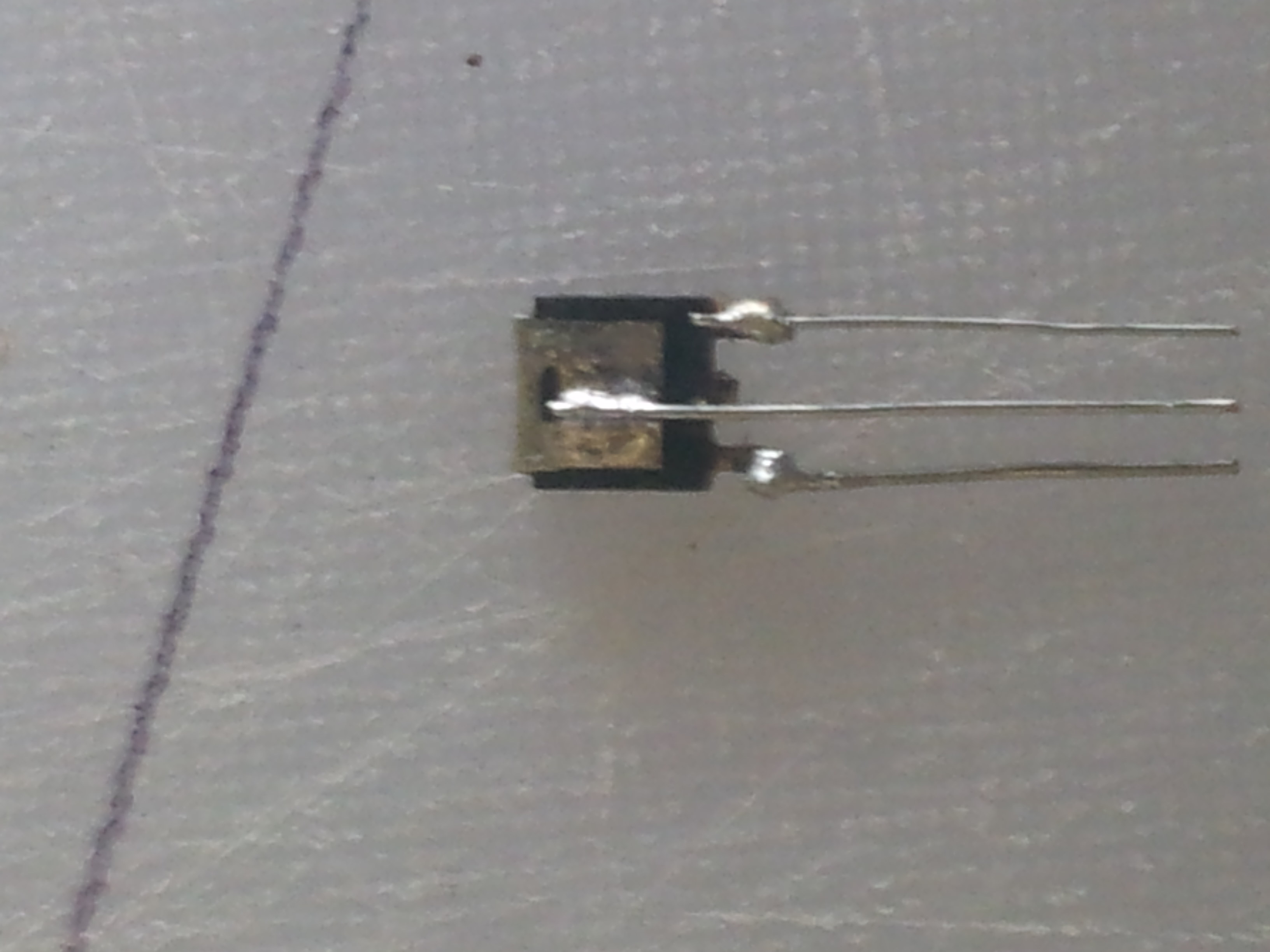

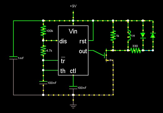

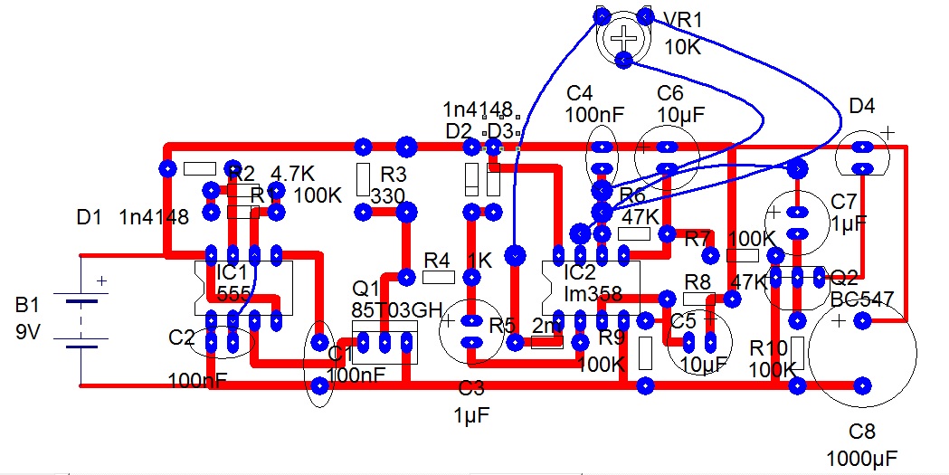

im trying to make a low powered pin pointer using a 70t03gh fet, you can salvage lots of them of motherboards, they are smd and switch at 3v so i though i would use them to run of a pp9, but here is my problem if i use a coil less than 500ohm the fet heats up and if i use a dampening resistor less than 500ohm that heats up to, so how do i work out a balance between the coil and fet so its not killing the fet and battery

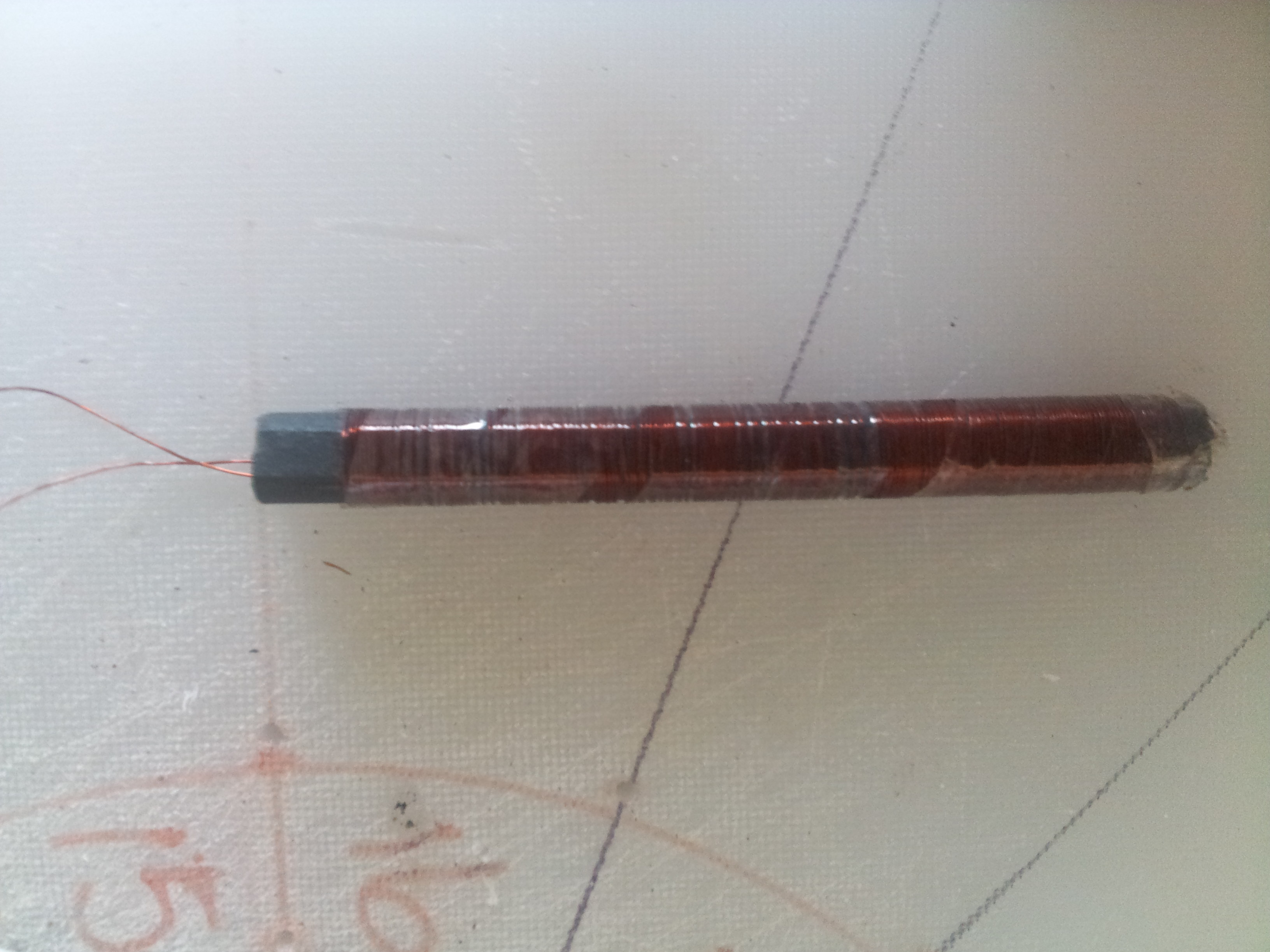

using a 600ohm coil im getting about 2" but that's a lot of wire lol
