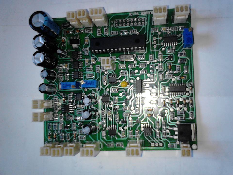

      Maybe the new Greek detector is an upgraded Superscan, which has been made in Greece for some years. The control box looks downsized so I guess modern batteries have been used rather than the lead acid gel ones used in the Superscan. Does anyone know the name of the company which makes the new detector?
      Eric.
      Hi Eric.
      The company name is MPROS1 and the site is http://www.mpros.eu/en/.
        Power-Delay-Thresh-Filter-Adj manual-Adjust-Audio. An auto/manual switch and auto reset button. A 24V Delta Pulse...???
          for what 24V?? if you want more depth (more TX power in coil) you have to increase PULSE WIDTH but not the power supply voltage. DP has 500us max, its enough, you can
          increase to 1000us and get Eric Foster's Aquapulse towed 1000uS. though with this width i deeply DOUBT its useful on the soil. Aquapulse towed 1000uS was used only for ocean/water environ, not for soil.
            thank you again for the mention of my alias in arabic context.
              "If it looks like a duck, swims like a duck, and quacks like a duck" ... probably we can assume it's not a pig!
              "Filter Knob" is probably "Gain" Pot in Delta Pulse because when you can call it a "Filter" - when turned down (lowest resistance) it has more chatter and and noise,
              and again if you increase it (higher resistance) you get less noise and less sensitivity..
              Delta Pulse is pretty much tapped out in terms of improvements. In my last DP build I've removed 556, 4538 (both) and associated parts and placed a MCU
              and still it's Delta Pulse so... the one thing that can be looked is the Autotune/SAT section which I doubt anyone understands how it works so... I'm willing to throw a bet it's what we say it is = Good Old Delta with new name & fancy Voltage meter on the front panel

                  Yes very good KT and Orbit. Yes Eclipse Autotune/SAT could be a bit quicker (or adjustable). I think Benhams document mentions how to speed up response time. These would be useful improvements for KT Marauder v.? maybe...
                  Perhaps experimenting with components/settings could eventually warrant 24v...Or perhaps it is just +/- 12v ?

                          My Sniffer, from Sinko aka Crazytech, one sided design, will detect an aluminium can at 1.2M (air test) with only a 30x45cm coil (3 flat winds cat5, tapped at wind 22, last 2 winds shielding). You should be able to adjust your components/coil to achieve this Foinikas. Check it against KT schematic and others. Or maybe KT has some boards for sale??
