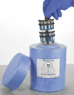

            Cryo Supplies and Accessories:
            https://www.emsdiasum.com/microscopy/products/cryofixation/cooling_chamber.aspx

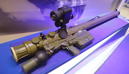

              Russian Verba 9K333 Man-Portable Air Defence System
              The seeker has two detectors - a nitrogen cooled MWIRInSb detector for detection of the target and uncooled PbS SWIR detector for detection of IR decoys (flares). The built-in logic determines whether the detected object is a target or a decoy.
              On the picture
              frontlet cylinder is Nitrogen cooled Cryogenic Chamber with InSb detector inside.
              On this way dramatically suppression of all kinds of noise was solved on genius way.
