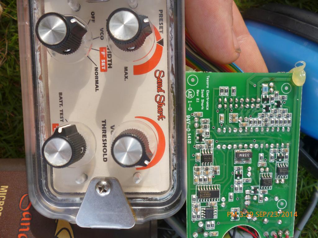

    What brings me here is that I have broken Sand Shark… bought used from ebay (so I don't have warranty), died after few days… just started smoking from it. I saw that one resistor became darker due to the influence of heat. I decided to take it to my friend, who is professional in repairing electronic things. He noticed that not only the resistor is black but also one transistor which is placed near. So I contacted Tesoro and they gave me the info about burned parts… (The R2= 20 OHM 1/4 watt and Q2= 2N2907). Friend changed the parts but problem remained, he changed some other parts but with no success… I found partial schematics of SS PCB on this forum, so I will once again ask my him to try fix it.

    hi. i remember Carl shared schematic. can you send hi resolution pics of your board to me under the light both sides?

      the board is still at my friends workshop, he is out of the country for hollydays so I have to wait... I don't know when he is back and I can't reach him on the phone... I will send as soon I get it

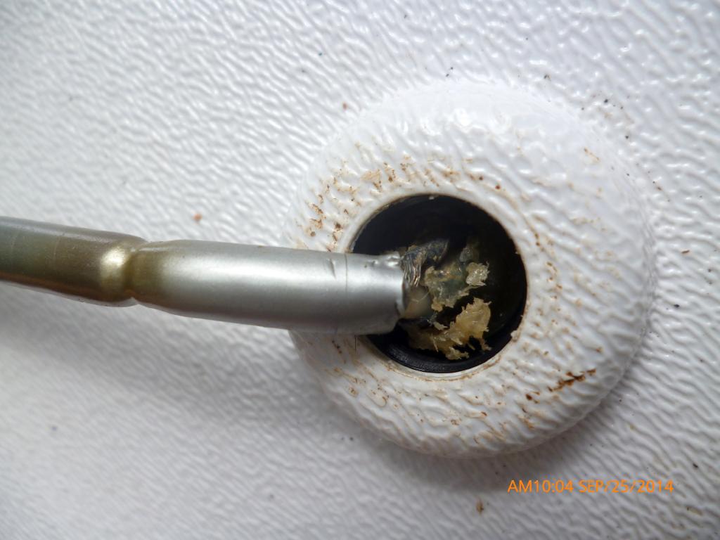

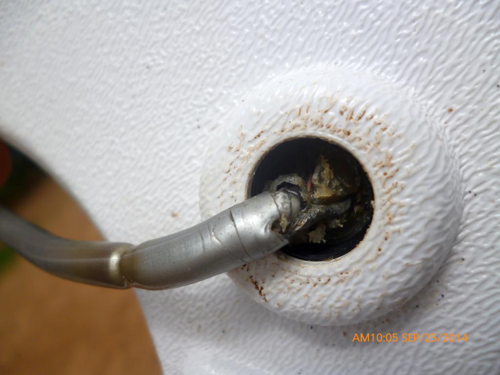

              you are strange guy. you are not able to upload not one pic. so then what you ask for???
              nobody is able to help you if you do nothing.
