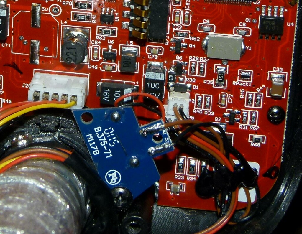

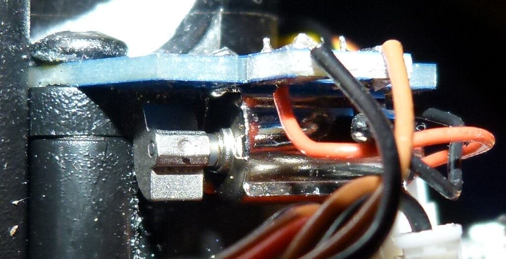

        Funfinder, what are the characteristics of the vibrations - any discrimination ability or does every target signal the same and you look at the ID?
          Also, what and where is the vibration device? I don't see it in your other thread with pcb photos.
              First I'm using the main disc - per instance set to Metal-ID 25 so rusty nails are rejected but steel, coins etc. give a signal.
              The next "discrimination" comes from the vibration - when I'm looking for large finds I don't care about any short vibrations.
              But this is what you wanna know:
              Large finds start with a soft or weak vibration and while slowly sweeping, the detector gives almost a constant vibration
              signal over the whole "find area", even if its a motion-circuit. So its pretty simple to estimate the size or even depth of
              the find if you hold the coil at an angle of 30°-45°. While coins per instance give a very short and intensive vibration.
              Step 3 would be to pinpoint the signal to get an exact metal ID value but I don't use this very often.
              Some regions where I search are so empty that its better to collect everthing I can get there anyway.
              But of course for people who wanna find with vibration special stuff like coins only, this is a very good method
              to dig just the stuff which shows already some pretty good metal ID - like 80-100 for silver per instance.
              And last but not least:
              The most highest sensitivity is reachable while holding the pinpointing-switch - this way the finest
              ground-balance differences are adjustable and will trigger the vibration already at super weak finds.
