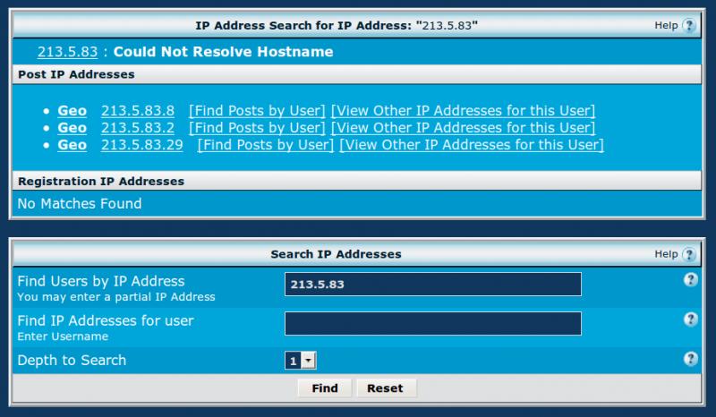

                Always tempted by a challenge ... I searched the database using the IP address of the "guest" (213.5.83.105). There were no matches; so I searched again using a partial IP address ... and voila! ... see below:
                By the way, you have used more than 800 separate IP addresses over the years while using Geotech. They're all there in the records. So my initial assumption was wrong. I could have tracked you down after all.
