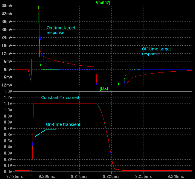

    By "on-time" I mean sampling the target's signal while the Tx coil is carrying a constant current.
    Off-time is the classic method of sampling after the Tx current has dropped to zero.
    Advantages of On-time sampling:
    1. A short pulse (30us) follow by a long off-time (1ms) maximizes the response of both short and long time constants.
    2. Ground response is full, allowing cancelling by a 1/t approximation.
    3. Tx transient is faster because damping is unnecessary (Tx coil is always connected to a low impedance).
    Disadvantages:
    1. Separate Rx induction-balance coil is required.
    2. Additional control circuit to maintain a constant current in the Tx coil.
    3. Additional circuitry to quickly charge-up the coil (high voltage).
    4. Variation in inductance by magnetic permeable and ferrous objects cause false signals.
    5. Sampling takes place while the magnetic field in the T coil is moving, causing false signals (true on false????)
    What are your thoughts, people?

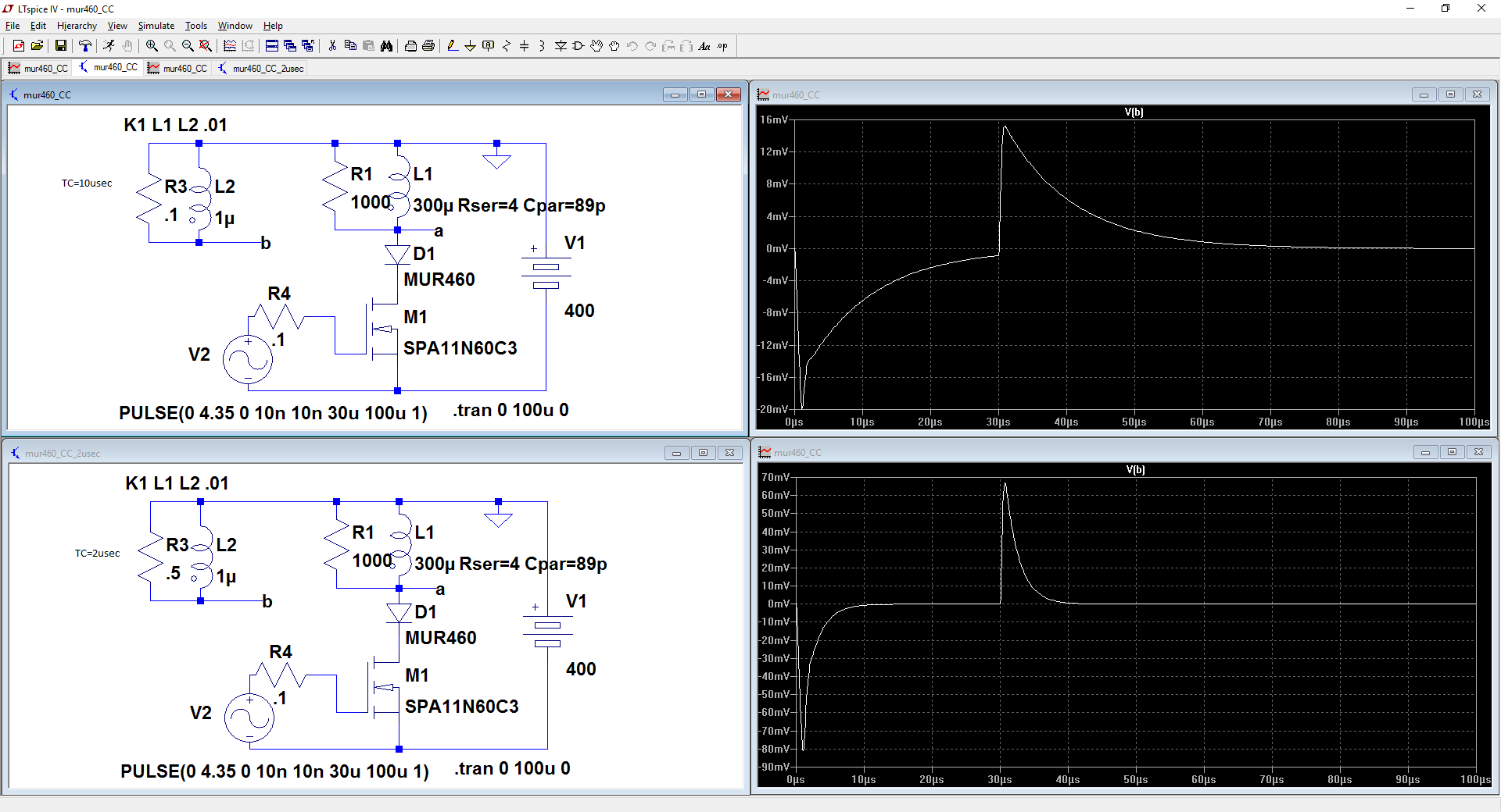

        Looks interesting. Some thoughts, might be all wrong. Including spice simulation to compare signal at CC and after turn off. Don't see a big difference with 2 and 10usec TC targets. Depending on sample time 30usec on time might not be enough to do GEB. Have you tried the circuit on the bench to see how much it gains in signal strength?

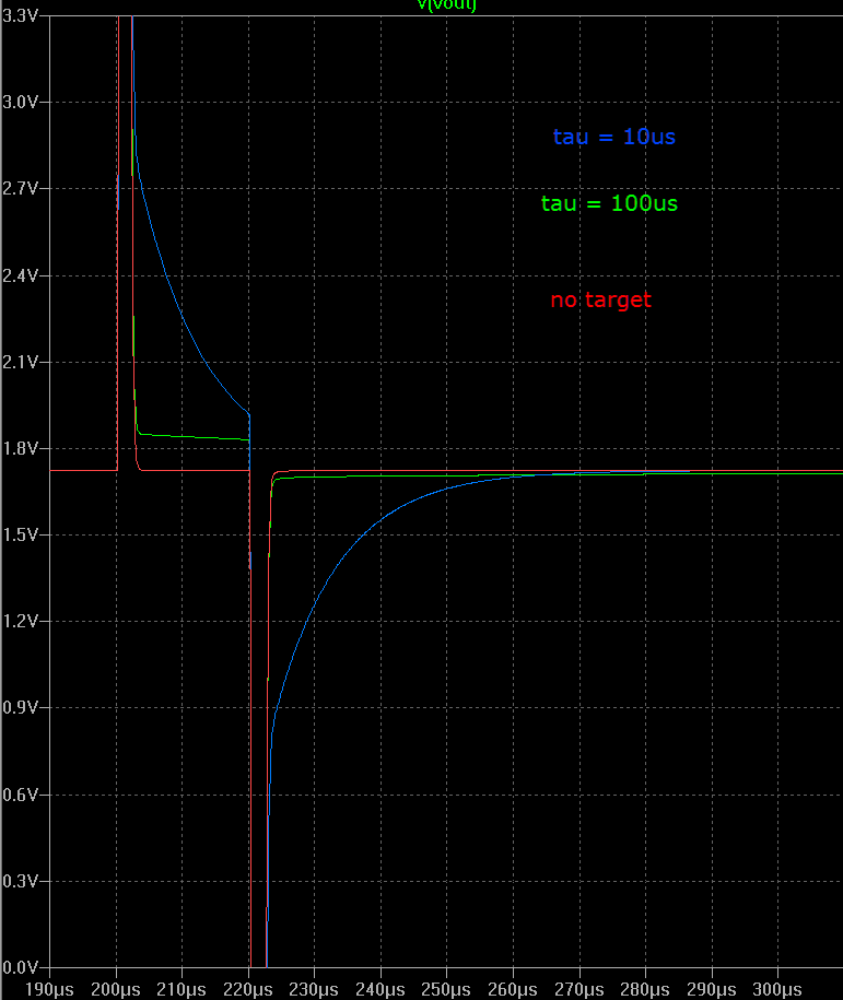

          Simulation for 10us and 100usec target, Tx pulse is 20us with a 2ms period. Polarities are opposite for on-time and off-time signals. Left (+): on-time, Right(-): off-time.
          There's a 16.25dB gain on the 100us signal (6,5x)
            There's a 10.5dB gain on the 100us signal (3,3x)
            Your simulation for the 10usec TC target is similar to mine. I didn't include higher TC targets because the most of the higher TC targets I've charted don't chart a straight line on a linear log chart. Closer to a straight line on a log log chart with slope varying with coil on time, the reason for the question about bench testing.
              Yes, that's expected when you smple off-time. When you sample on-time is the opposite, the slope is proportional to off-time The longer the off-time period, the larger the on-time signal.
