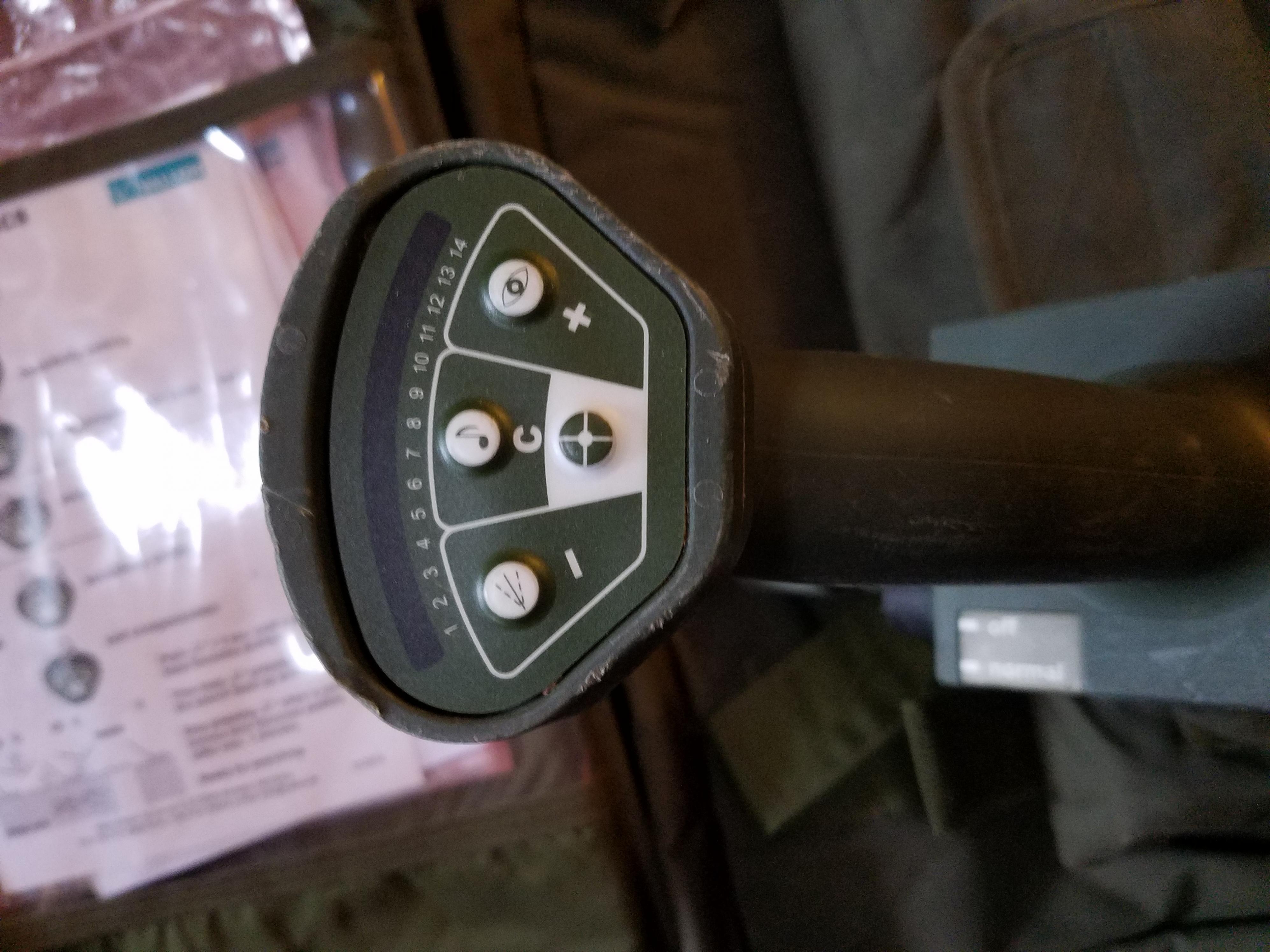

        Hi Jaypay,
        There is a piezo speaker inside the main body just behind the circular lable. This squeeks from a low to a high pitch when passing over metal. Additionally there is a vibrator so that you can feel the signal when you hold the handle, so this is probably the buzzing noise. It is certainly not any inductor. You then have the visual indicator for the signal by means of the LED bargraph. All these can be turned off, and I would suggest that the vibrator is off as you don't need it and it wastes a bit of current. Press the C button and the + button together and then switch on the detector. Only the LED and speaker/phones will then operate.
        The channel settings are done by switching the control to the speaker symbol then press C and keep it pressed until you get a short beep. Keep pressing and then also press + or - to shift to higher or lower channels. Stop pressing C and the channel is stored. Switch back to normal or mineral for searching.
        As to the filter adjustment, the ones one the market do not appear to have the facility to do this. I enquired of Vallon and they said the re-programming had to be done at their factory. I didn't dare enquire what it would cost. It's a shame as varying the filter would have been useful. A slower one would be good for coin and ring hunting as the default re-tune is very fast.
        Eric.

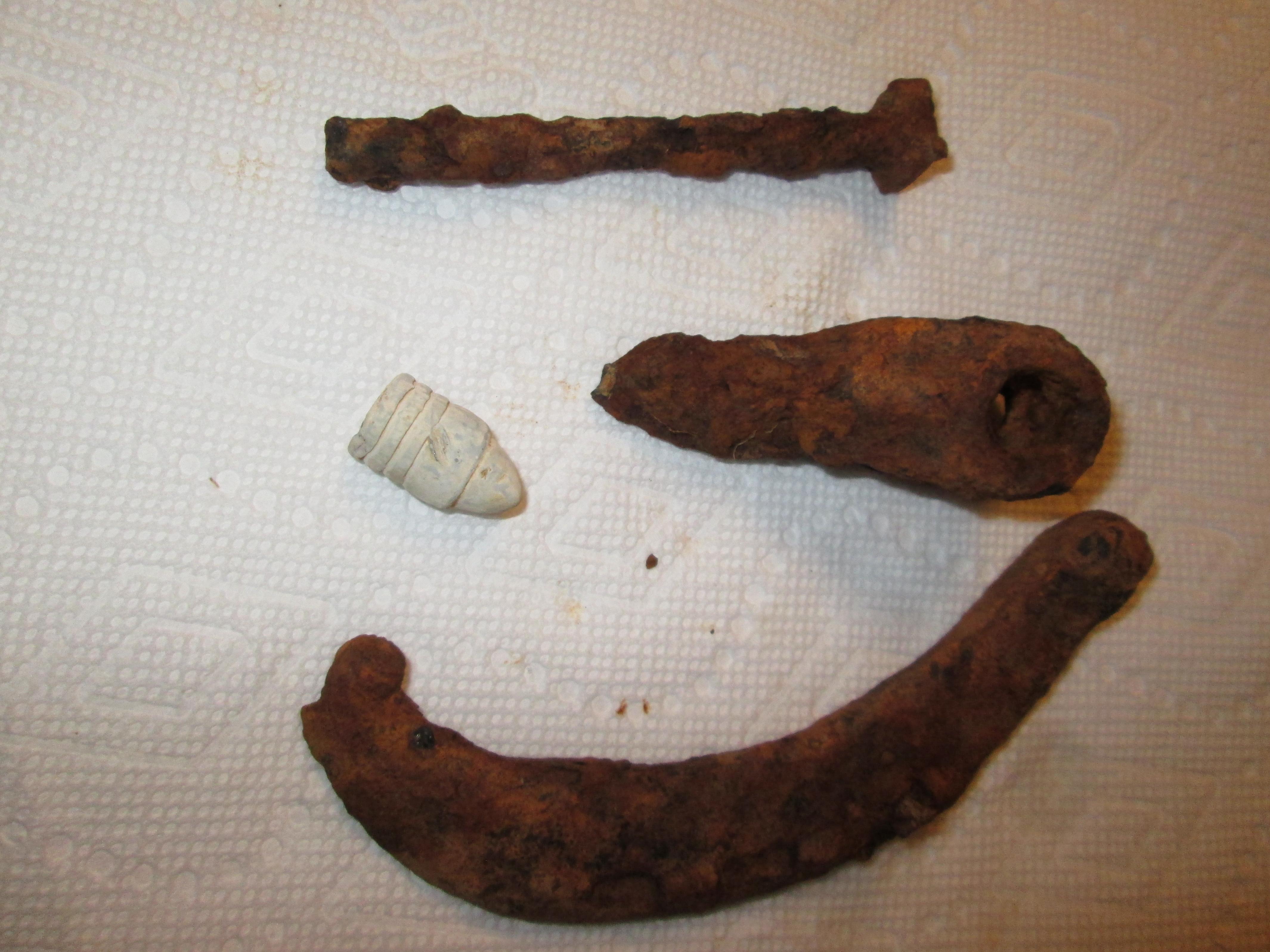

                    The high pitched soft noise was present well away from power lines. Further investigation seems to indicate it originates in the electronics as it is present even when the speaker is muted by plugging in the earpiece. Also, is not affected by the sensitivity or volume settings. Attached is a pict. of my finds, too cold and windy to be out for long. Fired Civil War 3 ringer, half a horseshoe, and ??

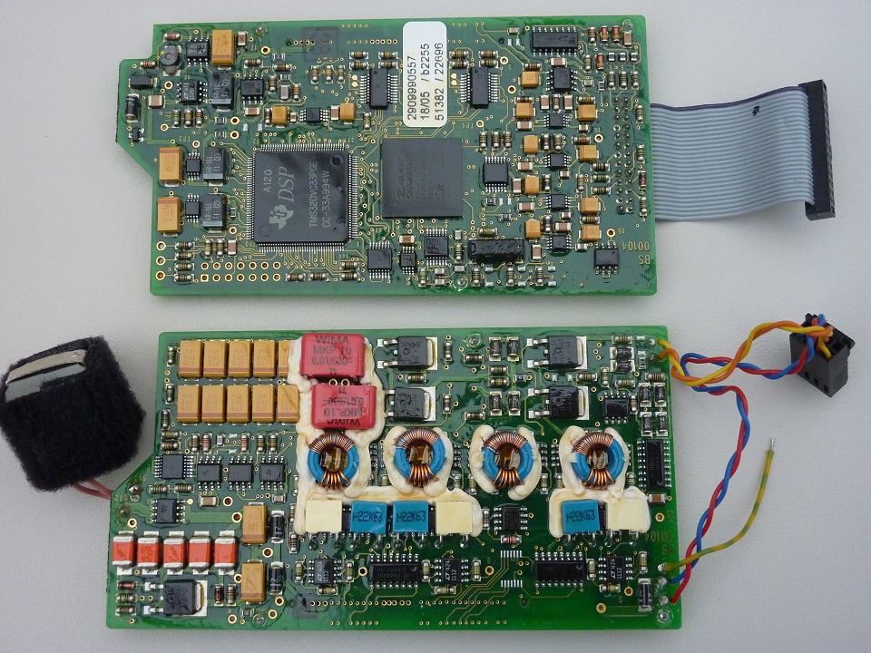

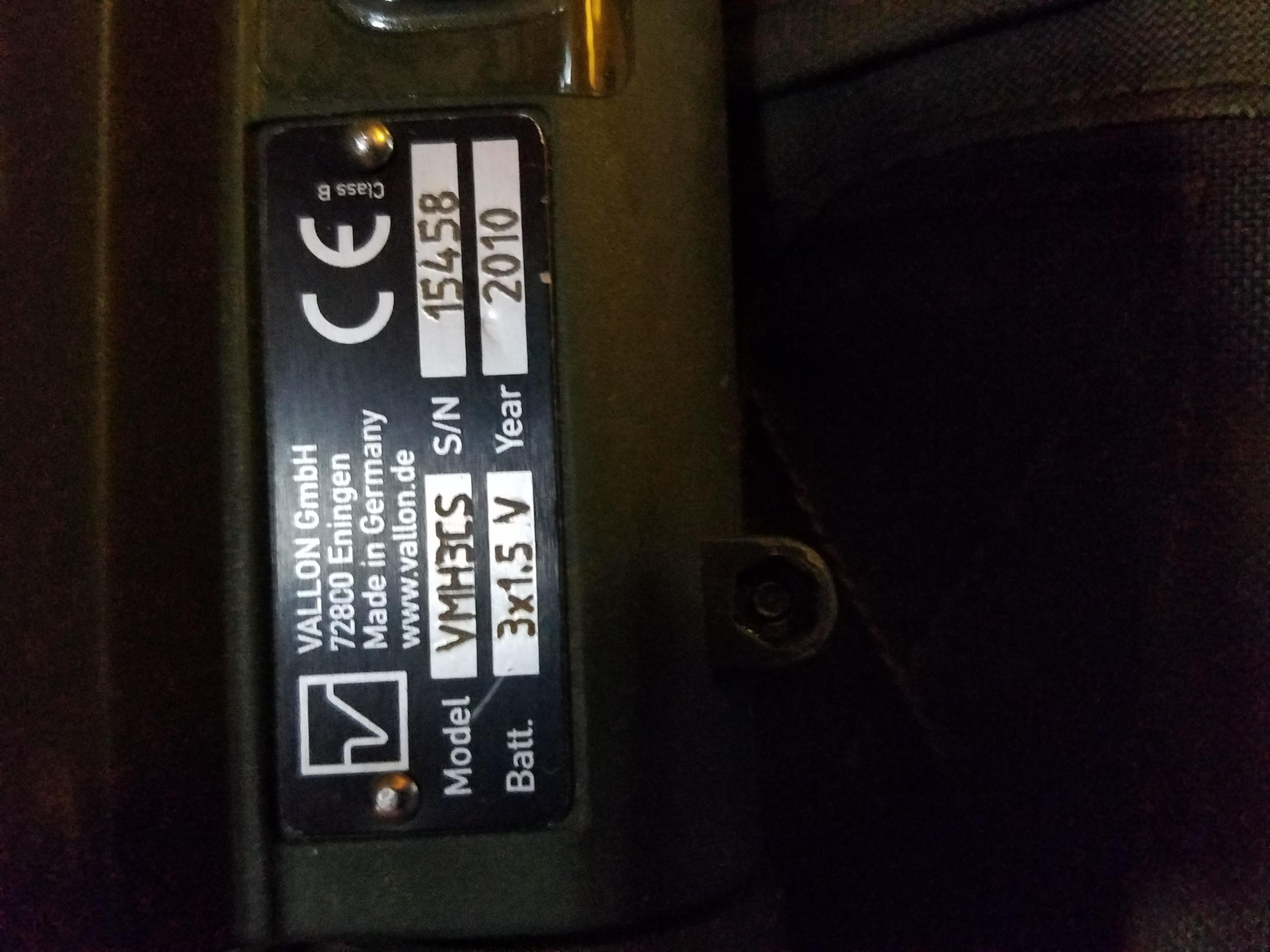

                      What year is your Vallon? It will be on the manufacturer's plate, or if that is missing, on the circular label stuck on the back end of the main box. There is a hole punched in the label at the year number. 06, 07,..........10. Most of mine are 2010, but I had one 2006 model that had a larger inductor at the front end of the electronics module.
                      The inductor in question is wrapped in velcro and sits against the end of the internal shielded plastic box. This is the only component that I can think will make a noise. I assume it is associated with the main voltage converter but at what frequency, I have not investigated as yet. In later years the inductor is considerably smaller and mounted on the end of the pcb where the recess is.
                      Eric.

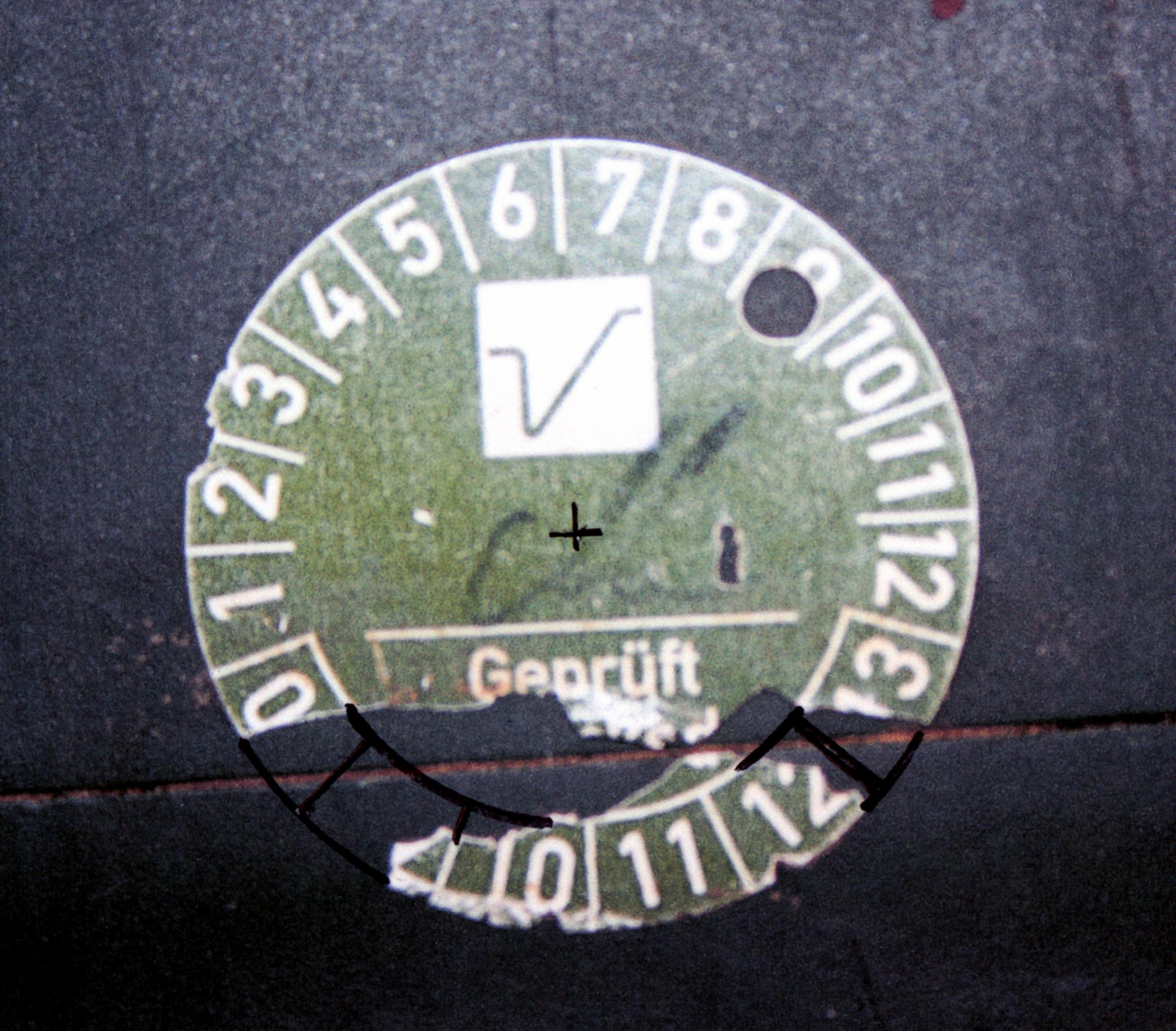

                        The side plates have been removed and the date code scratched thru. Am attaching a photo. Looks like the year was 08 or 09. Thanks for writing me back.
                          I think we have to assume that the noise is normal, otherwise the detector would flag a fault when switched on. I will check the frequency of the inverter and post the result. Also it will be interesting to see if the 2010 units with the smaller inductor run at a higher frequency.
                          Eric.

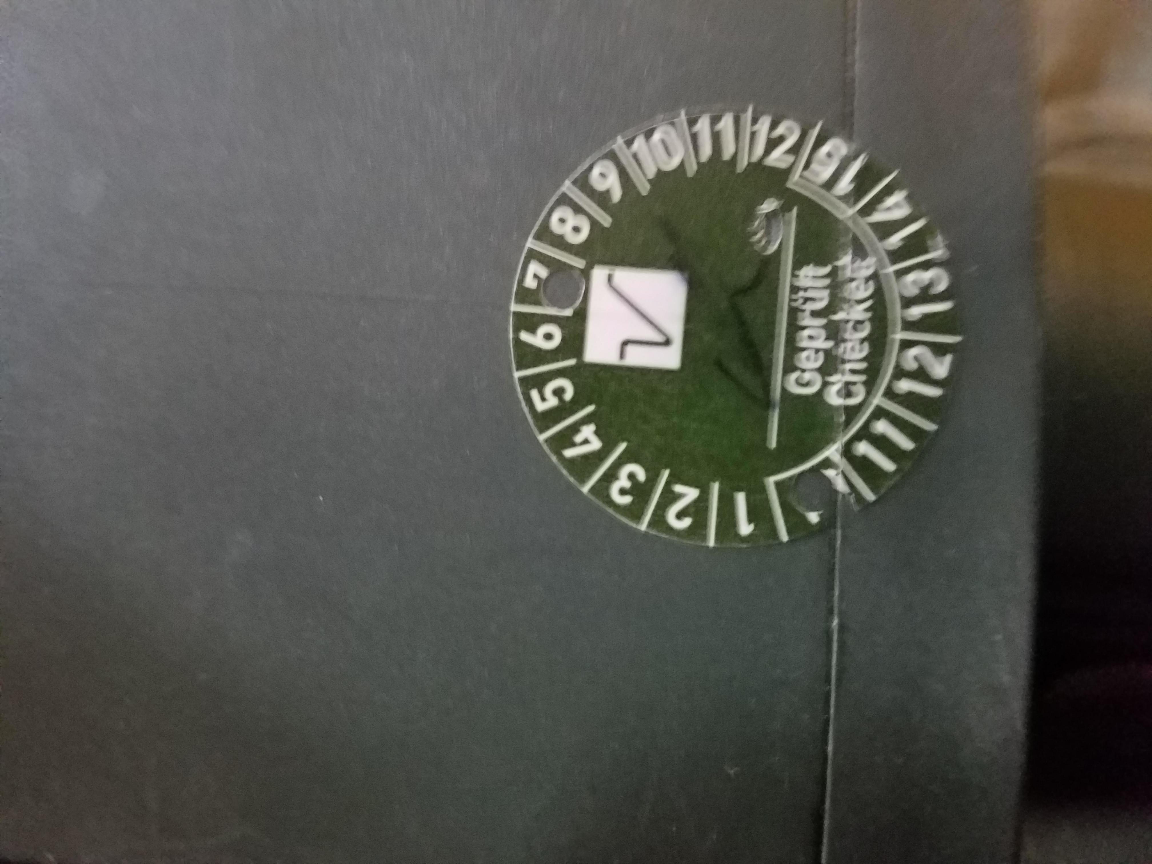

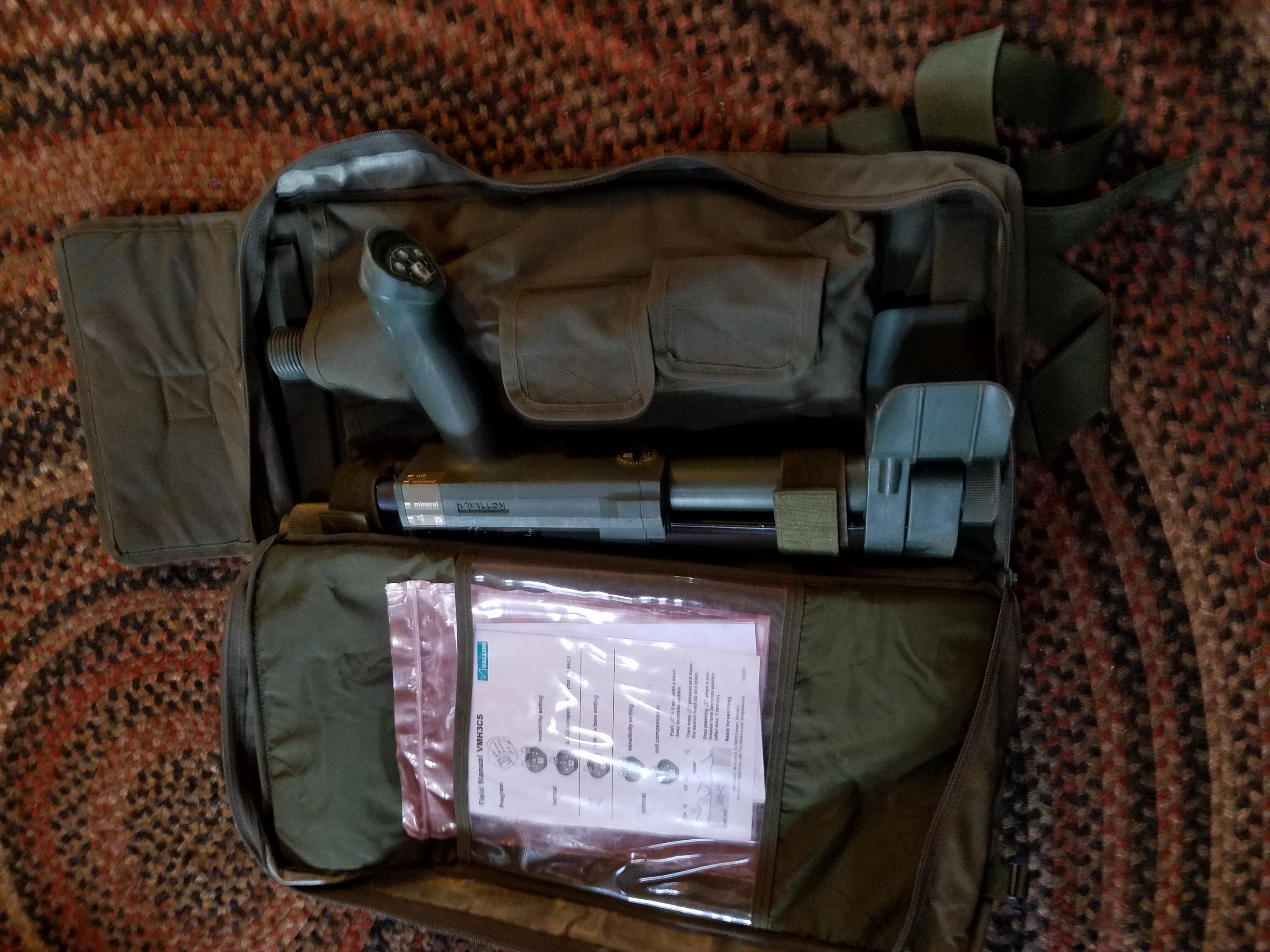

                              Received my Vallon VMH3CS today. Unit is in exceptional shape... minimal Afgan dust. Date code is 7/2010. At $270 delivered to my door, I am well pleased.
                              No hum/noise coming from unit other than alert tones.
