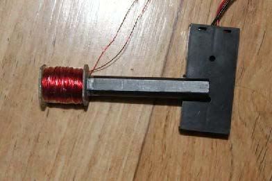

                      By the way, I savaged a 10mm diameter 122mm long ferrite rod, could I use it for this project? The second coil in the minimax pdf says that 400turns of 0.35mm on a 10mm diameter 80mm long rod it's enough to detect a coin from 7cm. I was planning to use 0.4mm cable as when I finish making the search coil for the barracuda I will have about 8 meters of it left (hopefully if everything goes right). But I have never winded anything so I don't know how the longitude of the ferrite rod affects in the turns "equation". Do I have to wind all over the rod? or just using a part of it? Do I wind it directly on the rod or do I have to use a small reel like in the pictures Click image for larger version
ID:	347802. If so, how long do I have to make that reel? Wow so many questions. I'm sorry
                      Also, there's a 33uH coil in the schematic (L2), can I wind that coil in the same ferrite rod? If so, where do I wind it? Maybe each coil on each of the rod's side? or one on top of the other? I don't see that coil in the pictures.
                      I may buy a cheap coil meter so I can test how many turns do I have to give it to make it 33uH

                        I only put the details of the components I used, away from home for a month, nothing seemed critical transistors I used were just what I had in spares box. Any npn or pnp should work fine the coil was wound as in the post. Oscilator was on a vero board strip along with the diode and smoothing caps, rest of components on a second board. Layout is not important just keep the leads from coil to oscilator short. If needed will post pictures when I get back home.
                        Thanks, I didn't know any npn or pnp would work, But I'll try to buy the ones listed on the schematic. Though, if you got it working with other transistors/parts, a component list would be appreciated. Also it would be nice to see pictures when you can post them, Thanks
