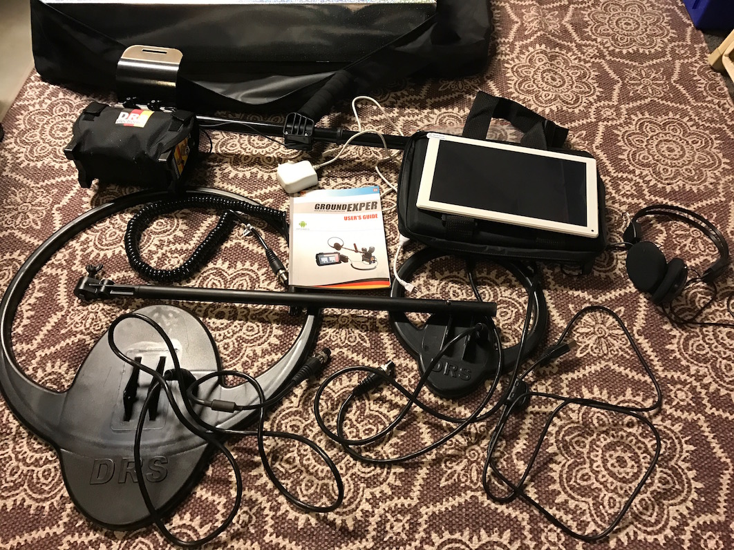

    Been doing extensive testing and will be publishing my results very soon.Click image for larger version

    Here's my first experiment on making this machine "sing" for coins, even though it's not designed for coins, I still want to take it's unique discrimination to task when the snow melts. That being said, here's part 1. https://youtu.be/NKnBhoU6p-k
