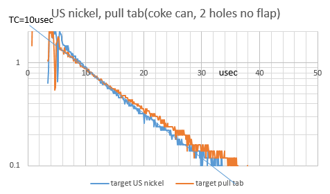

                          If you select a ring and a pull tab, both having same ID on the CTX, will their PI coil flyback (detect) profile be identical?
                            Charted amplifier out decay, US nickel and a pull tab. Don't know how they would ID with a VLF detector. I charted a nickel and pull tab awhile back, thought they charted closer but this is what I got today. Both targets in same location. Tab from a recent purchase.
                              I was referring to VLF but looks pretty dang close on the PI as well. People use a U.S. Nickel as Substitute to see if there PI will detect a nugget.
