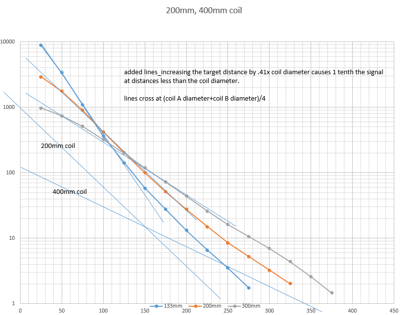

    ok. it was Eric answer done in Findmall forum. i repeat it. with text.
    [ATTACH]39106[/ATTACH]
    Re: Question on coils
    Posted by: Eric Foster
    Date: May 18, 2005
    Here are the curves I have used for many years. The range reaches a maximum when it is equal to the radius of the coil. Coils larger or smaller than this optimum will result in less range. To show how this works, along the bottom axis you see coil diameter, which is obviously 2 x the radius. So for an 11in coil, if we go up the vertical scale to A, we have 5.5in. Also note the diagonal line and the series of ever increasing semicircles. Everything to the left of this line shows increasing detection range up to the maximum where it intersects the line, then decreasing range to the right, where the semicircles are shown dashed.
    If a certain metal object is just detected at 5.5in with the 11in coil, then going larger in coil size will cause a reduction (going down the dashed side), and going smaller in coil size will have a similar effect. Initially, it won’t be much, i.e. going from an 11in to an 8in coil will only make 0.5in difference but below 4in diameter, the range will drop rapidly.
    Now, suppose with the 11in coil, you can detect an object at about 12.5in (B on the vertical scale. This indicates that the coil is not an optimum size for that particular object. If we carry on up the curve (direction of arrow) we can see that by using a 20in coil, we could gain another 2.5in (C). The curve peaks at 15in with a 30in coil. But the extra inch gained hardly makes such an unwieldy coil worth while.
    Other factors come into play of course. The curves assume that the number of turns and the coil current is the same in all cases; which it isn’t necessarily. For the same inductance value, a smaller coil has more turns, which counteracts to some degree the loss in range. Also a smaller coil will pick up less electromagnetic noise, earth’s field noise and ground effect, which make for a smoother threshold.
    The end result is, that with a small nugget that can be detected at between 5 and 7in with the 11in coil, so that it is on the top part of the curve, an 8in coil may well give a similar range. That is not to say that smaller coils do not have other advantages. Small coils and probes are very useful in rocky areas or searching in undergrowth. They have less drag too for water hunting, and less pickup from mineralised soil or conductive sea water plus better signal separation on close or multiple objects.
    One other point regarding PI, is that the small object sensitivity is largely determined by the sample pulse delay. If an object is so small, or thin, or made of high grade stainless steel, such that all the signal has decayed before sampling takes place, it would not matter how small a coil you made, it would never be picked up.
    Eric.

      Thanks kt
      Think I'm reading the chart right for increase in distance with a larger diameter coil. Can just detect a coin at 12 inches with a 8 inch coil, can detect the coin at 16 inches with a 16 inch coil. Is there away to determine the detection distance with the 16 inch coil for a nugget that can just be detected at 4 inches with the 8 inch coil?
        Reply #60 has a chart for estimating increase in detection distance when using a bigger coil for detection distances greater than the coil radius. I'm going to try to answer my own question with some data I recorded awhile back. Recorded signal strength vs target distance for a 133mm, 200mm and 300mm coil. Same inductance and current profile for all three coils. Found if I added a line for each coil, for each increase in target distance .41xcoil diameter the signal reduced to 1 tenth. Lines matched the recorded data up to the coil diameter. Lines crossed at(coil A diameter + coil B diameter)/4. Added a line for a 400mm diameter coil crossing a 200mm coil line at (200+400)/4. A nugget just detected at 4 inches with a 8 inch coil would be just detected at 2 inches with a 16 inch coil. Nuggets just detected at 3 inches or less with the 8 inch coil wouldn't be detected with the 16 inch coil.
