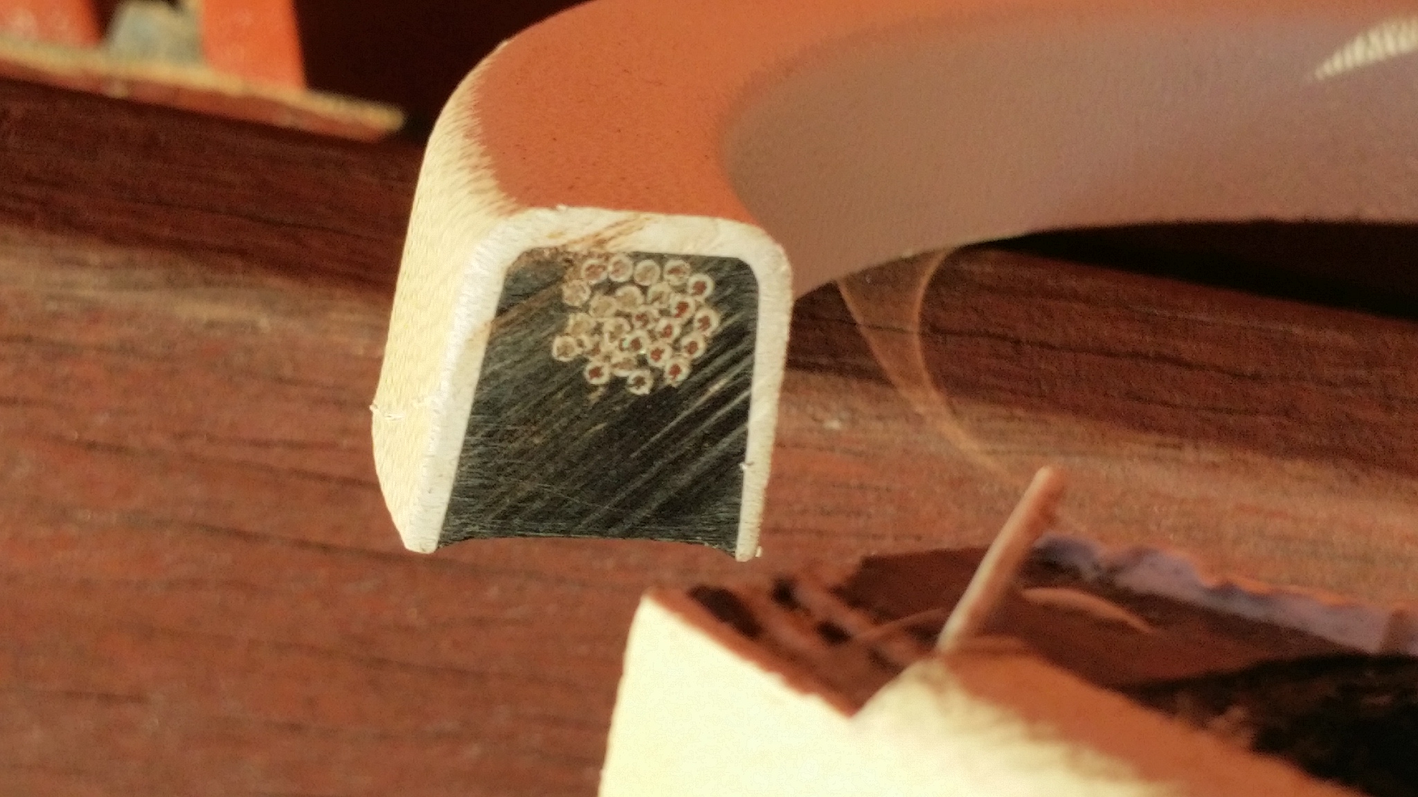

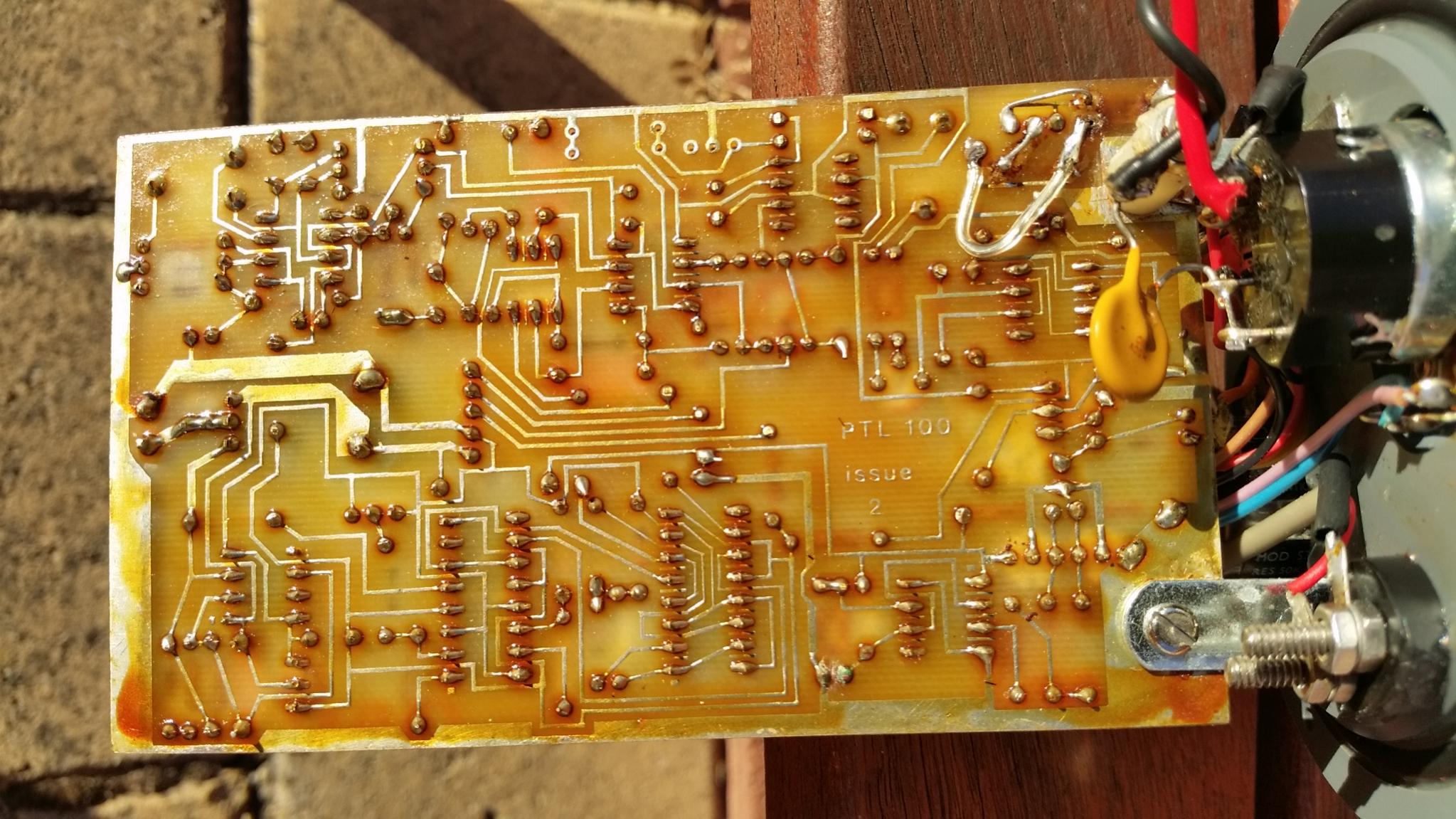

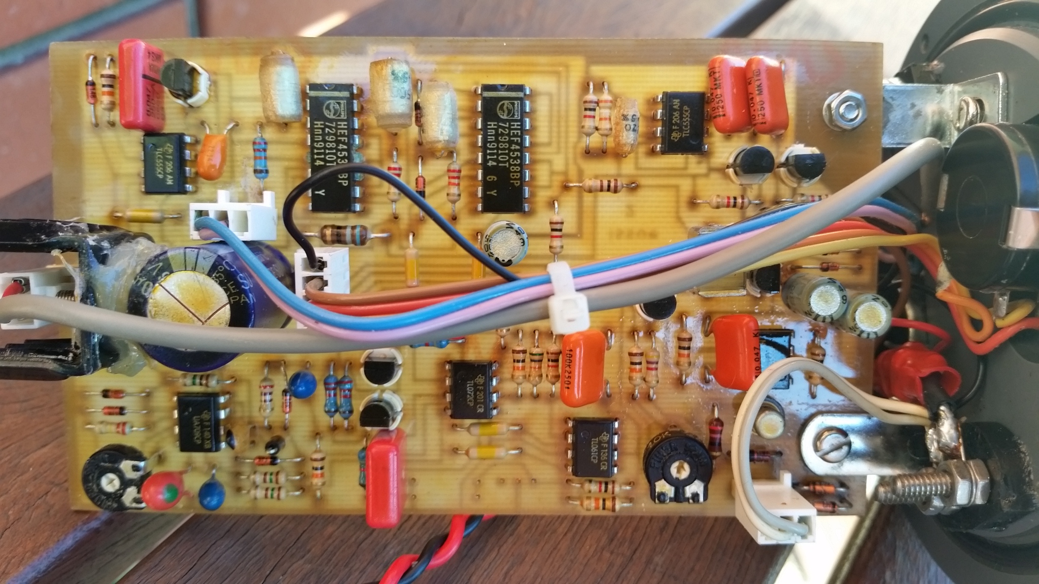

On a related note, I have a non working AQ1B coil here I am prepared to cut open if anyone wants to see what is inside and the AQ1B case is open if anyone wants to see the board. Thanks
