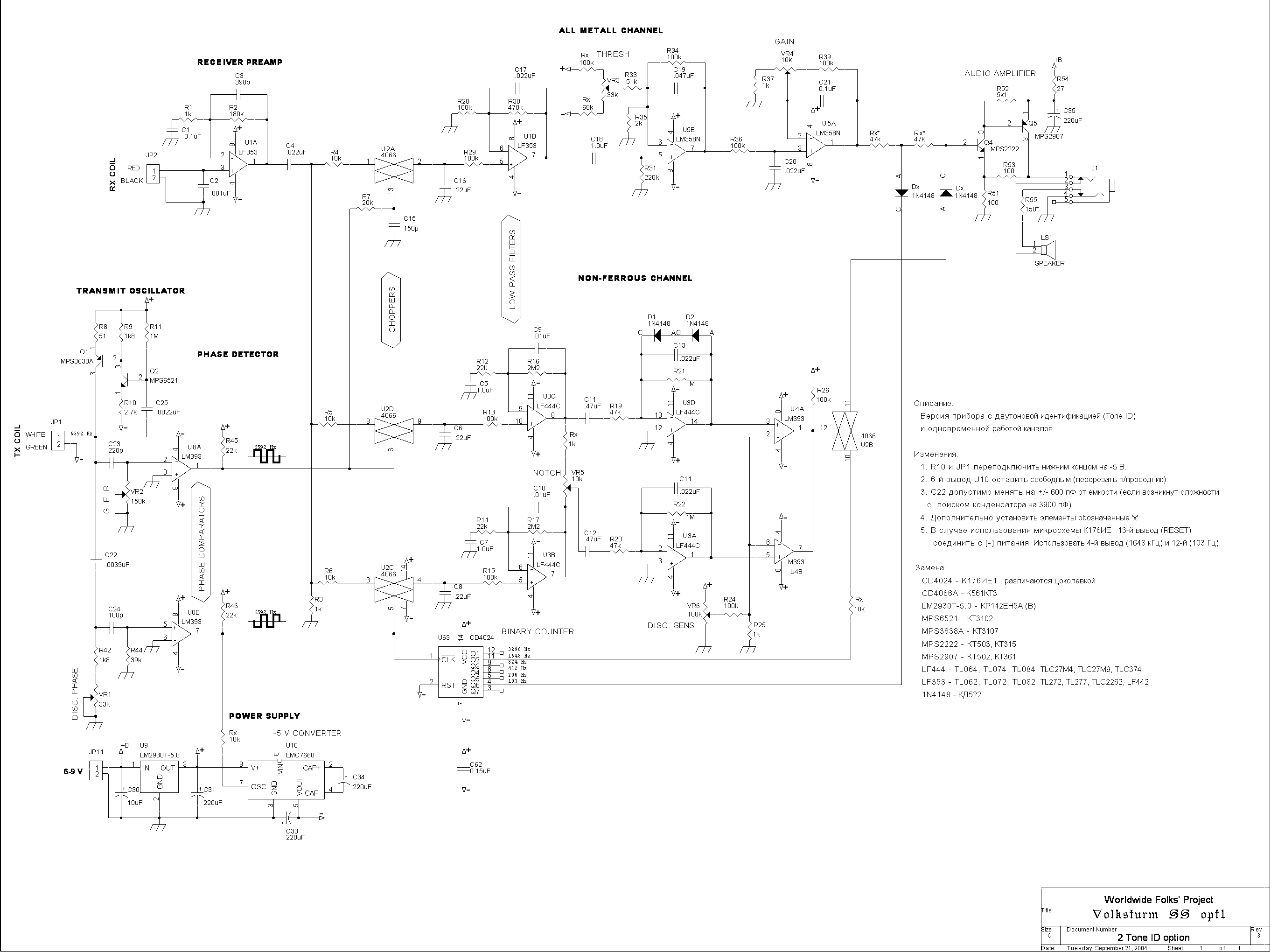

    while searching some new projects i found this Project
    https://buebchen.jimdo.com/selbst-ge...4t-coinseeker/
    it has multitone and deep frequency, pcb is very compact and it has good documentation
    maybe someone here has some free time to redraw pcb with sprint layout or at least to produce some useable gerber files
    i have not the time at Moment cause i´m working on PI detectors
    good luck
    oh mine god... i see my schematic 0_o
    do not use mc34063 for a metal detector. its not so good - noised. much people in Russia noticed this trouble.
      Hello Anatolij, what is the Name of your Project or schematic
      i think i can find all on the DVD i got from you
      description on the german site is not bad, he describes in Details how to tune the Setup
      Tuning coil balnce and amplitude
        hello Bernte, it was left as an offer only. i did not make it. then i used OrCAD in last time.
        BTW i did try to install OrCAD 6.2 on my WIN7 again and it is not wishing to stay - can not use those files.
          look a folder Volksturm.
