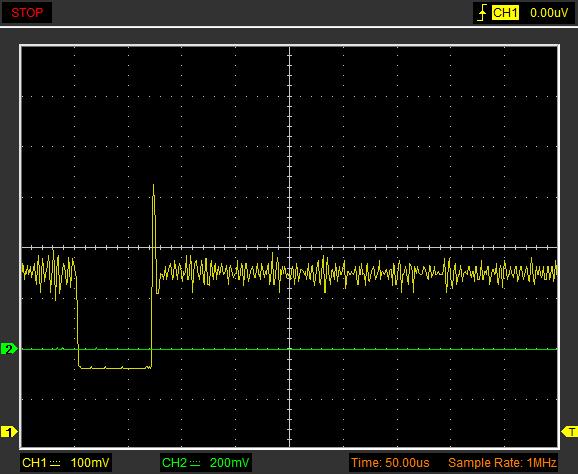

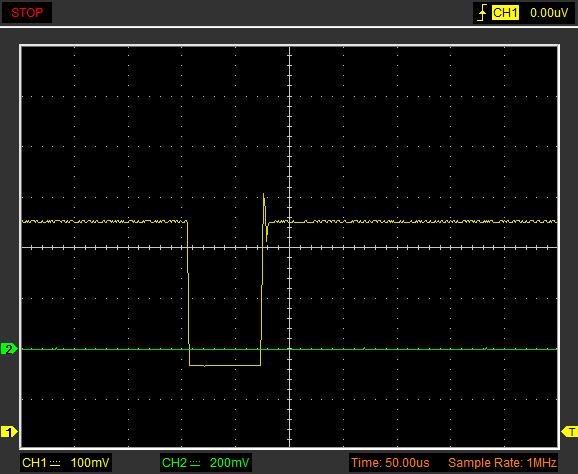

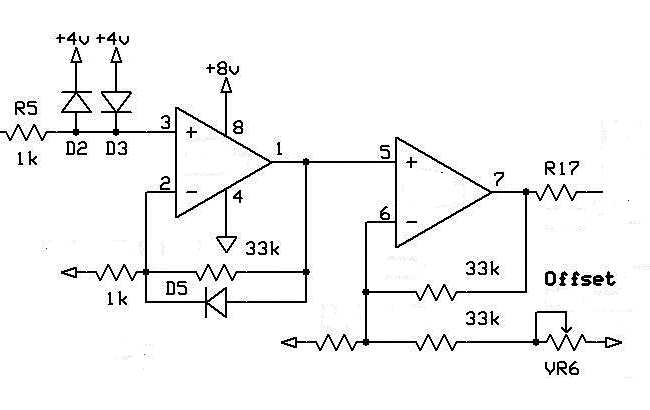

    Hi All, i have problem strange noise at 2 stage preamp
    at pin 1 normal signal, but at pin 7 noise appears,
    i use IC LM4562
    Schematic;
    Pin 1;
    Pin 7;
    what problem i have, need help for this problem,
    Thank,
    Wahyu.

        looks like the preamp from Td3x from Dooley, do you trust your oscilloscope readings?
          yea this from TD3X i just try to modified for next stage, integrator, etc
          mmmmm,,, not realy trust, i use Hantek 20Mhz usb pc, maybe noise from my device.
          Thank for reply eclipse.
          Wahyu.
            I think your just seeing the Noise Amplified by the two Gain Blocks.
            HF
              AGREED,
              looks like noise amplified.
              also looks like coil under damped, bit of a dip there after the spike.
              notice there is also noise BEFORE TX on time.
              could be oscilloscope,
              are shielded cables being used on coil and scope ??
                Looks like your scope probe is x10 and scope common is on -supply instead of +4volts(common). Not familiar with your scope so maybe I'm looking at it wrong. Assuming the not labeled resistor on pin 6 is 1k the noise on pin 7 would be 34x pin 1.

                              Hello All, thank for advice, solve my probe scope x10 switch to x1, noise disapear
