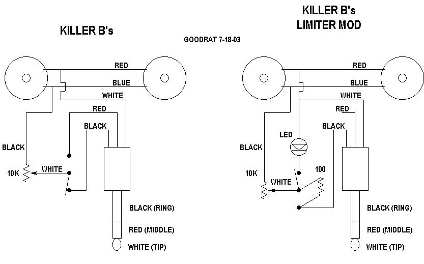

    Here's a little mod I did on my killer B's. They already had a switch that was not being used, so why not? The limiter kicks in just right so you can turn up the weak signals without the loud ones overloading your ears.

    I don't know if it's a good thing to play with the audio of the Killer B's or any headphone for that matter. They are good headphones and the audio tells you allot about what's in the ground. If you start masking the sound or limiting it's audio level then you don't have a true sound of what's in the ground. You can take any target and put it in the ground in different positions with different soil conditions and different moisture levels and you will get different sounds. I guess if you need to dig a penny at 16 inches or like digging big holes in the ground then focus on the weak signals but my experience unless you're a relic hunter is that most targets are less than 8 to 10 inches down and that's good enough for me.

      I hear this response a lot and it seems logical to me. But once in a while on the beach I switch it on. This limiter basically will make targets from 6 inches to coil sound the same volume. The signal on my X5 is a square wave and this does not affect any other properties of the response. So if I can boost those 10 to 16 inches a little louder but still tell the difference between a 16 up to 6 (dynamics not affected), I would say, what's the harm?
      I can still decide whether to dig a deep target, the only difference would be, I am more likely to know I have a deep target.
      Yet I do understand that learning a paticular detectors language is important, yes, why chance it? Because engineers take stuff appart!
