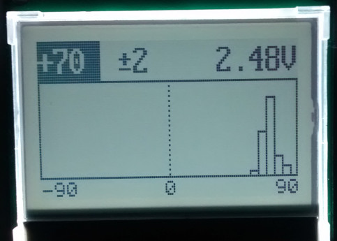

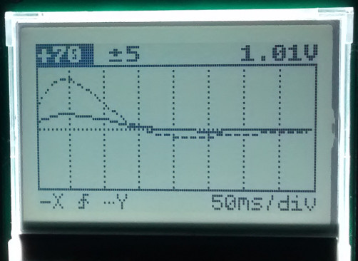

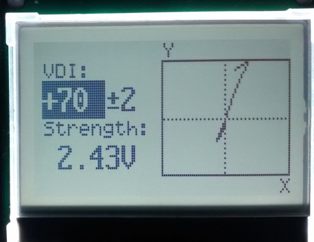

        • I have adapted the code and the zolen display from ebay seems to work well with 5V, the only issue I have found so far is that it has no K- pin to control the backlight, a possible solution could be to cut the K- track on the display and connect it to the vdi to make it work, once I implement the contrast control I could upload a testing firmware for the ST7565 controller

              • this is the firmware 2.1 + ST7567/ST7565 driver for testing, the display should be connected to the vdi pcb as follows:
                CSTB (e.g. /CST) -> CS1
                RSTB (e.g. /RST) -> RST
                A0 (e.g. D/I) -> C/D
                RWR (e.g. /WR) -> R/W
                ERD (e.g. /RD) -> EN
                The configuration pins if they are not set should be
                PSB -> High (parallel)
                C86 -> Low (8080-series MPU)
                SEL[2:1] -> Low, Low (1/65 duty)
                the rest of the pins have the same name, CS2, V0 and VEE are not used, the lcd contrast is controlled by software, only tested with the zolen display (5V+parallel). The only issue found is that the backlight control does not work because the K- pin is connected directly to VSS in the display pcb.

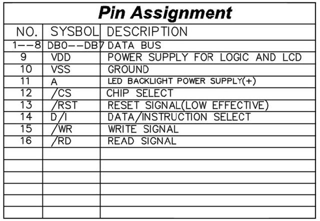

                          I don't think it is a problem my version has the backlight "K" soldered to ground and the led "A" is on the edge connector with a 34 ohm current limiting resistor mounted to the pcb. You can use a switch between LedA to +5v or a pnp transistor switched by the micro. Or just leave it disconnected.
                          Knowing Chinese stuff there may be multiple versions? Mine has 16 pins
Name:	glcd st7565 ebay.jpg
                            this could be the best solution since it would work with all displays but it requires a new revision for the pcb (e.g. for v2.2), mine has the same pins

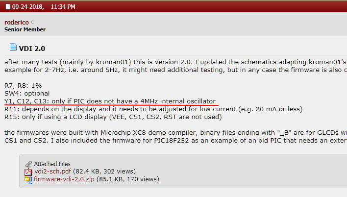

                              • Hello! I ask you to clarify the scheme. Do I need to set Y1, C12, C13 when using PIC16F886? Thank!
