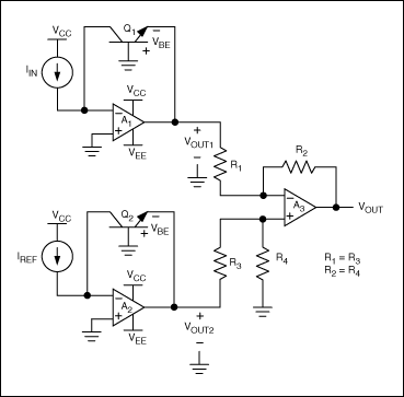

                      • I haven't done any test but the log amp probably won't work because the output voltage would be proportional to the log of the input and then pic would compute the ratio of X/Y to extract the phase and with the log ratio we cannot have the angle, in this case we need a linear amplifier unless a log-1 is done before
                        • You are correct. The output of the x and y log amps outputs (Vout1 and Vout2) are fed to a difference amplifier with a gain of 10. I am not expert here. But I assume one can replicate the mathematical functions in the software.
                          There is something referred to as logarithmic-ratiometric ("log-ratio"). Compressing the signals seems to offer some benefit in terms of precision. The DC log amp transfer function seems to be very good for this task(VDI measurements). There are even chips (max4206) which are dedicated to this purpose.
                          • Here is the exact same circuit topology I found in an article. Perhaps all the software needs is a good ratiometric table for referencing the signals. I know little on this topic, so please forgive the shallow explanations.
                            • all this can be done by software if we know the exact algorithm, the differential amplifier would compute the difference of the log amps, i.e. except from constants, log x - log y = log (x/y), do they use just log(x/y) as a vdi?
                              • Well there is what appears to be an antilog amplifier?? after the differencing amp.(whites log amp and meter VDI circuit). So there is some math going on here all the way through. A series resistor at the inputs to the log amps (voltage input device) converts to a proportional current. These are current sinking (NPN) log amps.
