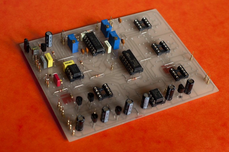

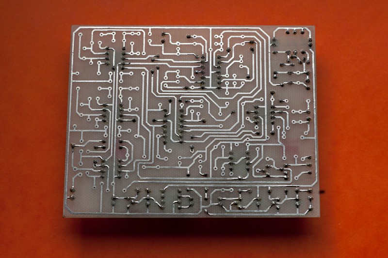

    Hi, i'm start to build a Raptor MD project with my
    NEL Hunter Coil for Tesoro Cortes. (5 pin.)
    I just finished pcb and I have some questions:

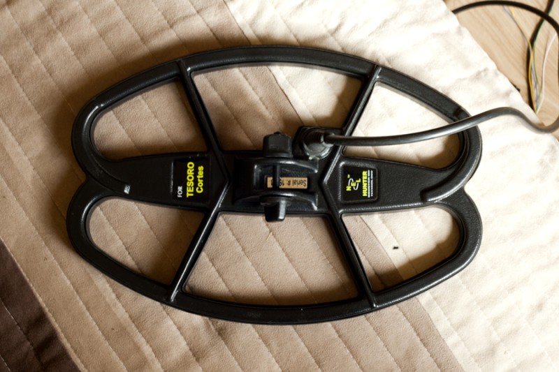

          Below are photographs showing the progress of the work and the NEL Hunter coil used.
          Nicodemus (Nico) also helps in the construction of the detector:

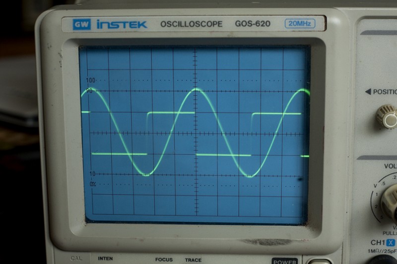

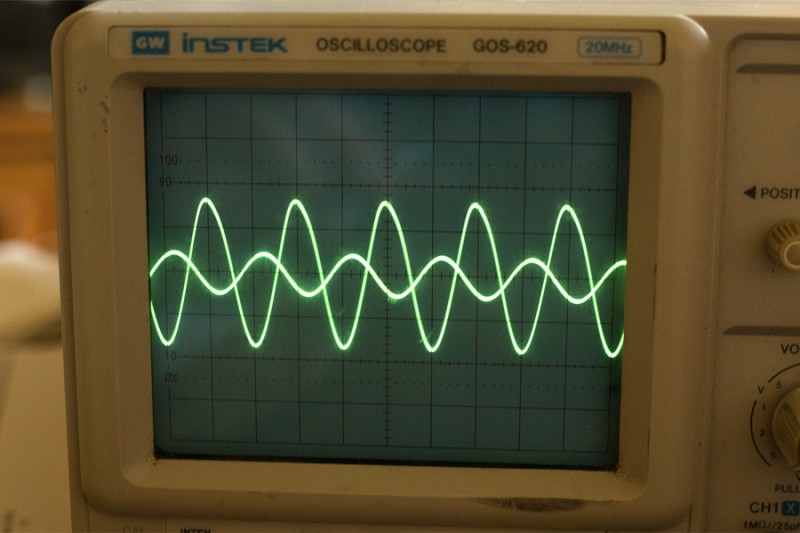

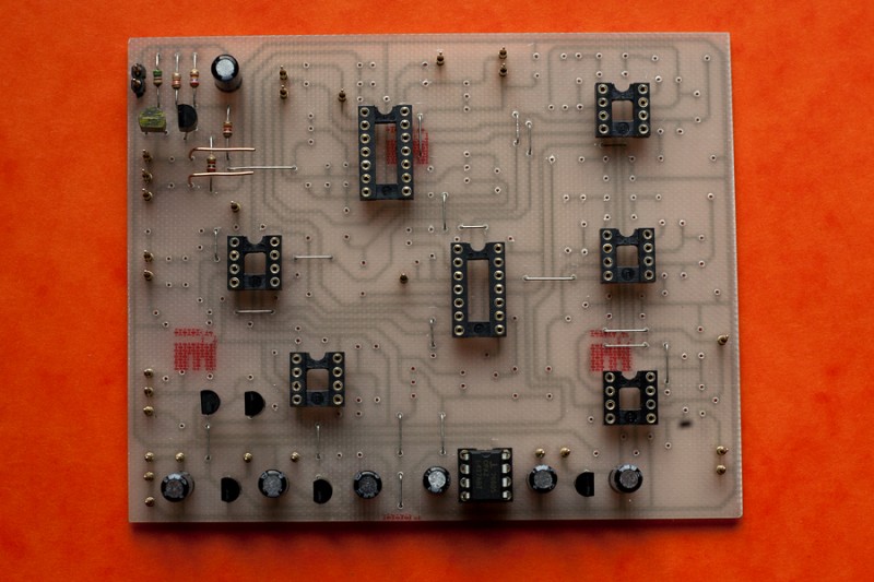

                Next step.
                I soldered the next items according to the instructions in the book.

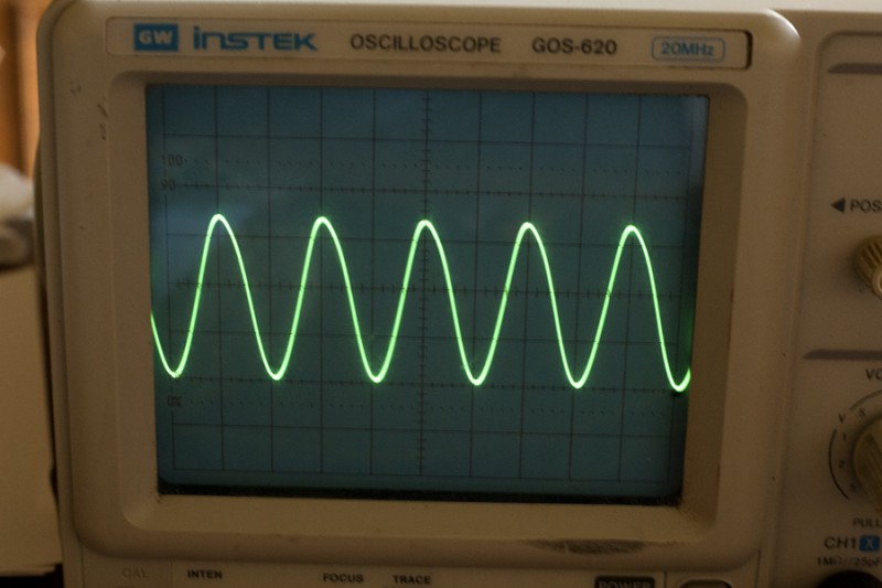

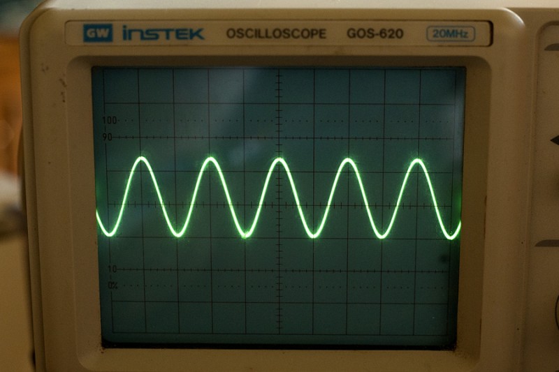

                Tx frequency is 10,04 kHz
                Rx resonant frequency is 10,98 kHz
                Tx amplitude is 17 Vpp
                Rx amplitude is 450 mVpp
                Both oscilograms.
                Are the signal amplitudes correct?
                Are the phase shift correct?
                I'm particularly worried about the amplitude Rx = 450 mV.
                According to the book should be in the range of 120-250 mV

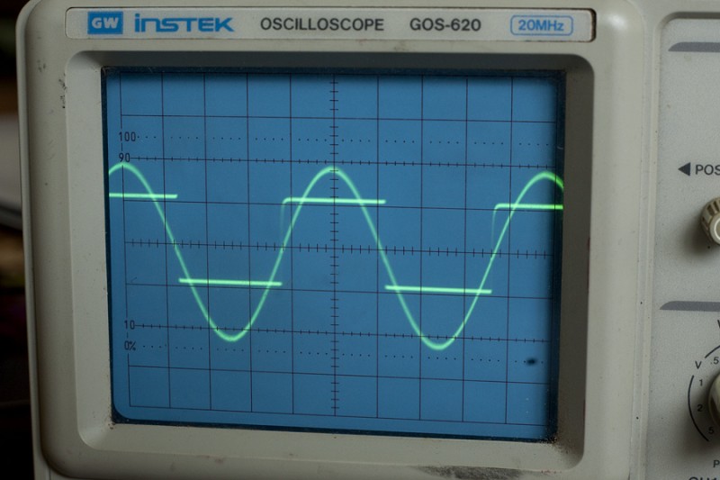

                  From the scope image it looks like the difference between the negative-going edge of the TX signal and the positive-going edge of the RX signal is around 10 degrees. On a standard Tesoro coil this offset is 20 degrees. Try adjusting the TX/RX overlap and see if the offset voltage drops.
                  Also, when you say the "RX resonant frequency is 10.98 kHz", is this as measured on the scope when the TX is operating? Note that even if the RX inductance and parallel capacitance resonant at [for example] 11kHz, the frequency measured at the receiver will still be the same as the TX.

                      In that case, try moving the RX resonant frequency further away from the TX so that you have an offset of 20 degrees instead of 10.
                        Several new components have been found on the PCB.
                        And I did the tasks of points 11 and 12 - these are the results of regulation:
