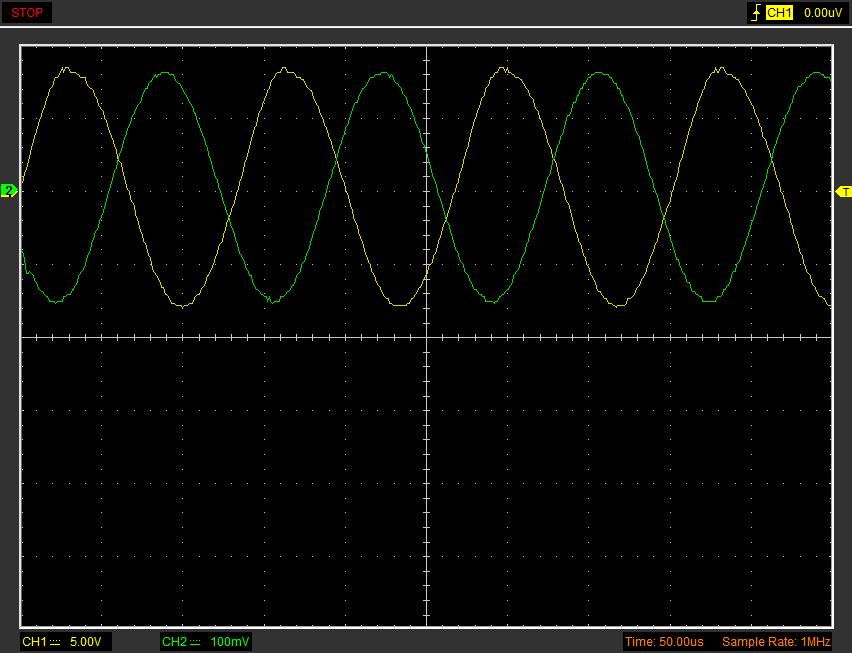

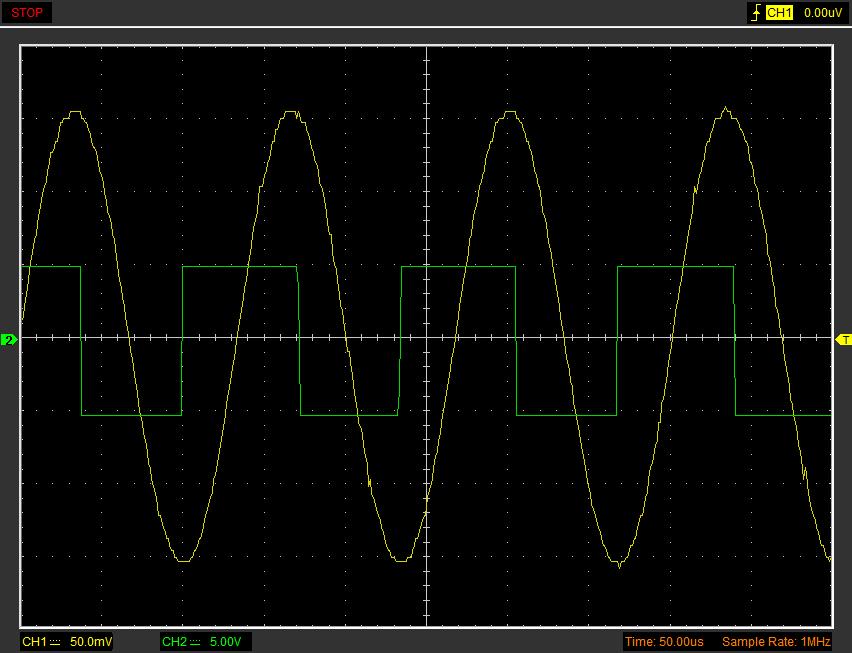

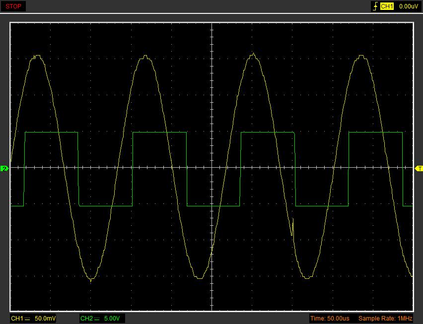

          Hello to all
          I'm experimenting with raptor project at 8.7khz
          I've completed the sampling section with these results
          I think I have to correct sampling discrimination
          Geb seems ok.
          Half-stroke potentiometer adjustment

            Hi Gallico!
            You are using DD coil as I have seen from your previous post in another thread.
            Therefore you must have about 200° as shift.
            Looking the image raptor "TP1-TP2.jpg" do you have this phase between RX and TX but instead you must have between TX and RX.
            In other words, after not before.
            Bye
              Hello Sacchetti
              You're right, in fact, I had already corrected the shift in another discussion: http://www.geotech1.com/forums/showt...-quartz-for-tx message 18 find the pictures.
              However it does not seem to go this way, I still miss something.
              thank you!

                Hi Gallico!
                Please, can you describe better which problem do you have with it?
