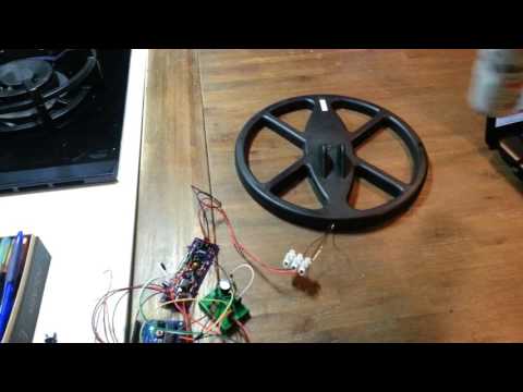

                My explanation is as follows: The Tx coil forms a free-running oscillator whose amplitude is kept constant by a feedback loop. A conducting target increases the power drawn by the oscillator (transformer effect), which forces the feedback loop to readjust the amplitude. The readjustment is the signal you want to measure. The target also causes a frequency shift that can be used for discrimination.

                          I've done some experiments on this mode of operation, see this thread:
                          http://www.geotech1.com/forums/showt...447#post228447
                            My "damping method" prototype. Keep in mind it has no amplifier, what you see is the raw signal digitally amplified.

                              There quite a few IB detectors that can do the same. I am curious to see what other advantage this method may have if any.
