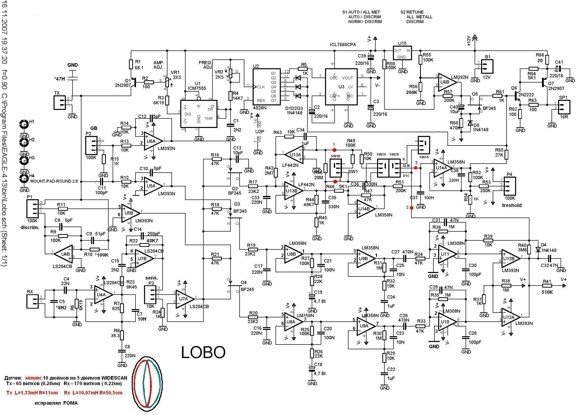

      Is it possible to tune up the Lobo? Ive seen some lobo shematics here. Can someone post a fully working shematic (one sided pcb layout) of it? The lobo is also an option for my next project.

                Thanks homefire (thats exactly what i need), Koala (md4u.....what a great forum;-) ) and davor. I think i will build an lobo first.

                  Eugine was working on the LoBo for quite some time. Guess he has more important things going on these days. I have a Pile of stuff on it here. Bit confusing on what is New or Rehash. I think I gave you the newest goodies. On the LoBo there are two resisters that I could never find. I was planing on making them. File notches in Carbon Resistors a little under in value of what is needed.
                    What Values.
                      6.19 k = 2
                      68.1 ohms = 1
                      38.3 Ohm = 1
                      I know they make them , I just could not find them. Probably find those with just Tolerance Slop.
                        Don't make them, but consider the reasoning for that values. The values that are strictly in E48 tolerance range, and not in E24 or below, are the designer's way of ensuring the value will most certainly be within 2% tolerance, regardless of the supply chain. Funny thing is that shops are usually replenished with 1% resistors, but from E24 values.
                        All of these values are easily substituted with E24 ones.
                        6.19k -> 620k 1%
                        68.1 -> 68
                        38.3 -> 39
                          I have the 6.19K resistors. Could mail you a few.
                          But not the others.
                          However, Measuring some 6.2K, 68 and 39 Ohm, 5% ones, You can probably get Close to the Values you require.
                            Thanks for the Offer Gary. I'm sure I will find them by testing a pile. Even 5% as long as they meter for what's needed.
                              6.19 k = 2
                              68.1 ohms = 1
                              38.3 Ohm = 1
                              Digikey lists them. Sometimes need to pick a resistor close to the listed value. I usually call for a 500 ohm resistor on the schematic but use a 499 because I can't find the 500 ohm or it is a lot more expensive.
                                Yea, most times you can just use what ever is close even in the ball park . I just like to Build As prescribed. That way if something goes sideways it wasn't me subbing parts.
