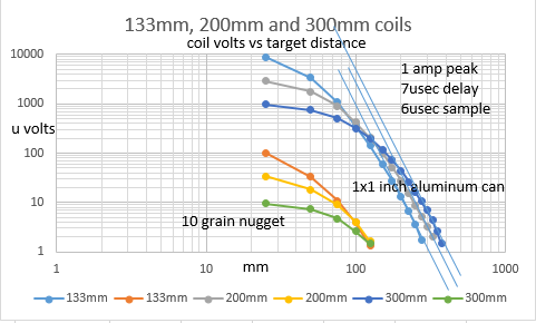

            I'm not for using a lot of current but I see it different. Chart from reply #7. Target size shifts the amplitude vs distance curves for the different size coils vertically. If a target was just detectable at 25mm with the 300mm coil increasing the current 25% should double the detection distance. The percent improvement is highly dependent on target size and the initial detection distance. For detection distance greater than the coil diameter the improvement is small. For an increase in coil current the percent increase in detection distance for a target cut from an aluminum can side 5x5mm should be a lot higher than a 25x25mm target.
            For an increase in current the increase in detection distance might be close to the same for the different size targets but the percent increase is not.

              I see what you're getting at. But you also need to consider the secondary field generated by eddy currents in the target. In the case of a 5x5mm target, this is acting like an extremely small coil, so that the detector [RX] coil is much further away than the target "coil" diameter. In fact, the same applies to the 25x25mm target. Even if the target is placed at the very centre of the coil, it will still be one coil radius away from the windings.
