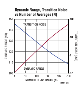

        The noise floor of a PI is the sum of the noise of the damping and limiting resistors. For a carefully designed, standard PI a noise floor of 3uV is already a feat. If you want to directly sample this then your 3dB signal above noise is 6uV, you need an ADC resolution of 19 bits. You spend $50 on a 24bit ADC to waste 21% of its resolution.
        I'm guessing the chart says I need 70,000 averages for 24bits. Maybe 100 averages for 20bits. 100 averages is closer to what's needed. Maybe I'm looking at it wrong.
