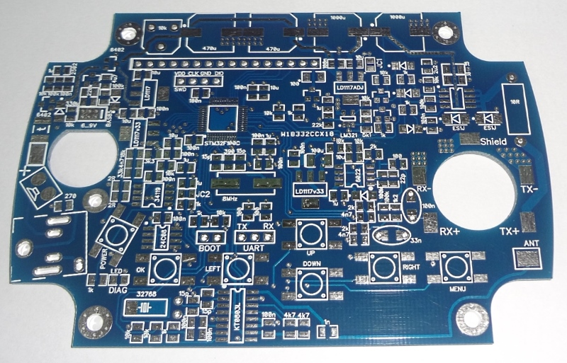

The same problem with me. Have one KROT 3 XM board. But don't know how to solder ATXmega, and some part's seem's cannot be found in local shop's.Originally posted by Koala View PostThere was a few I could have tried. I wanted one with a known working PCB of the shelf.

Later i bought one Quasar AVR pcb (DIP), but again some part's is hard to find for me, for example 3201 IC.
CDI, how do you know the Krot3 is good? did you try one? I built two krot2 detectors,and could not get it to work without instability and false positives. To solder a atxmega, you do it under a magnifier. I use a camera telephoto lens. you carefully solder just the corner pins to lock it down then solder the rest. I have had much better luck with the Quasar Arm, but the firmware does not have all the bugs worked out.

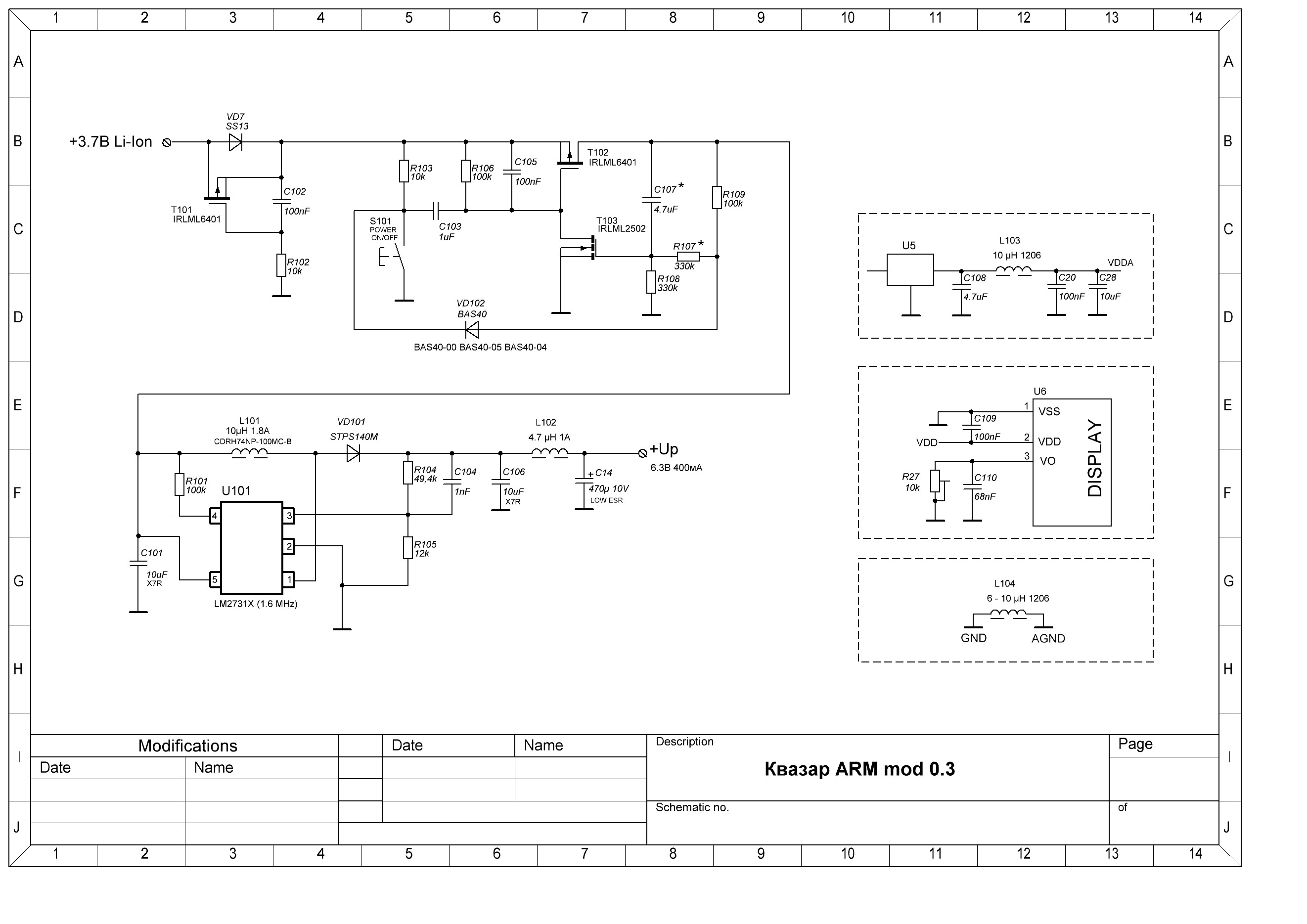

I ordered a set from ebay, circuit board with all components, because a part was missing the dealer gave me two PCBs. So I ordered the rest of the missing and built two devices. Since it is very difficult to find out the important information from the thousands of Russian contributions in the forum, I'm adding here an English-language summary. I discovered at ebay. The author will hopefully do not mind, after all, it increases the chances that he sells his sets.

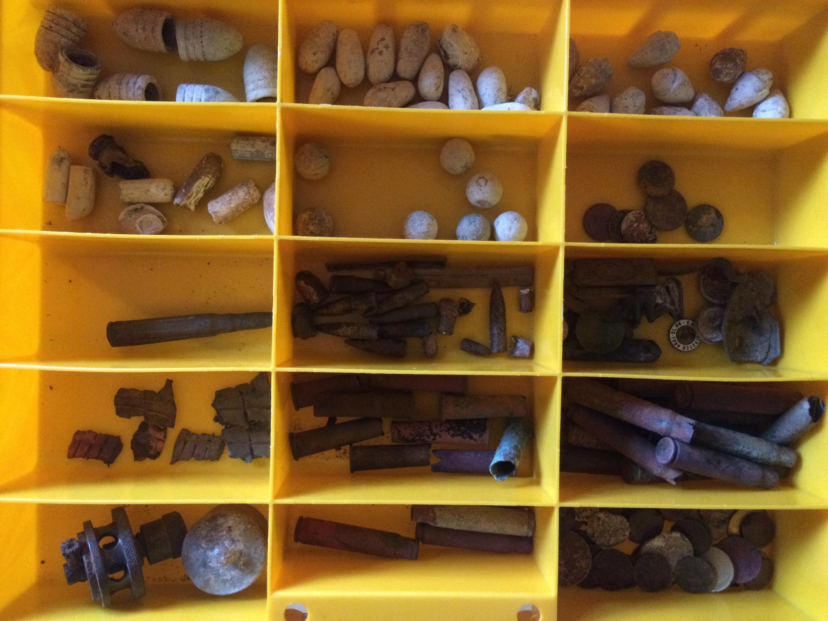

And another picture of some finds with the quasar.

Some things still are not quite clear to me, e.g. the menu point "desired balance" what do I have to adjust there?
