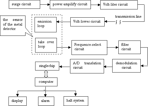

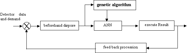

              Metal Detector Based on Genetic Algorithm:

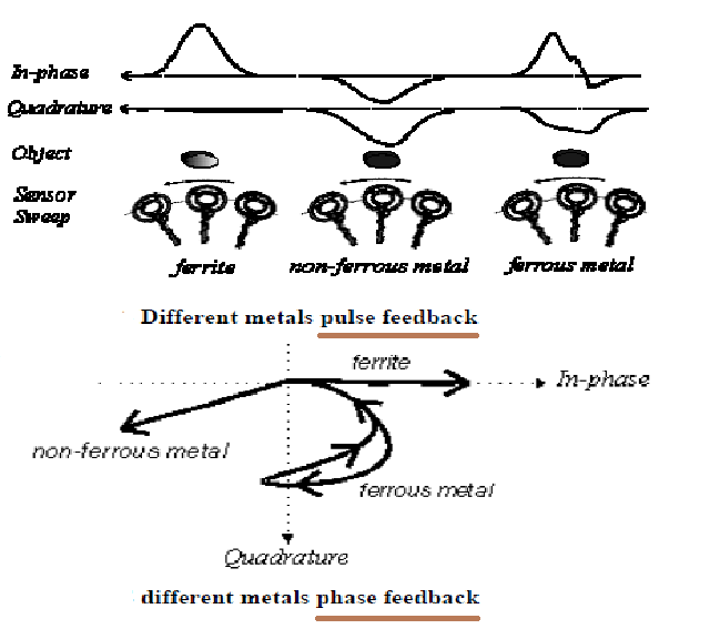

Name:	different metals.png
