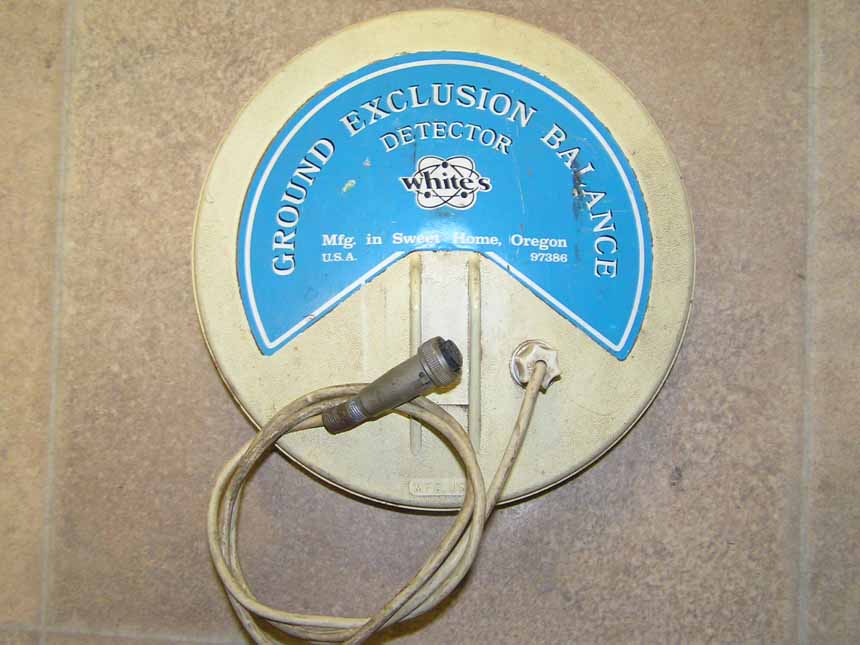

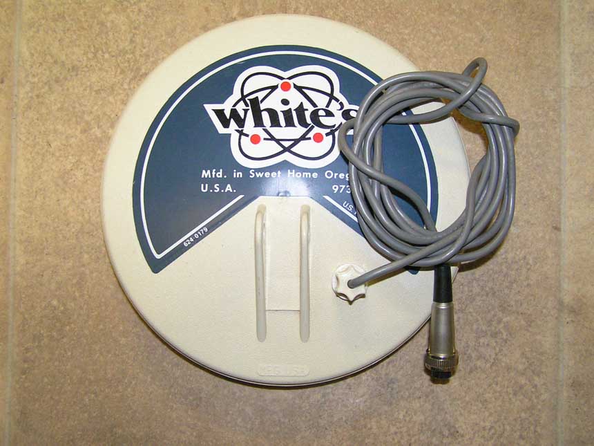

    the coil will plug directly into the machines or the arm rod, but will only work when plugged into in the arm rod socket.
    there are also issues when interchanging coils between the other machine 6000/D. plugging coil direct will not work.
    i have 2 whites coils marked (dark blue 624-0179 and light blue), but they don't interchange i am not sure why. they work on their own unit only
    dark blue 624-0179 coil works on 6000/D S2, 6000/Di S3 with arm rod
    light blue coil works on the 6000/D
    i was able to get the light blue coil to work with the 6000/D S2 but the response and air depth was very poor in compassion to the dark blue coil
    so i am mostly trying to understand the coil differences ,wire pin outs and connection differences. (red, black, white, green, shield) they connect differently with the arm rod

                the dark blue coil is marked as
                6B 8-125
                works on 6000D S2 and 6000Di S3
                and
                D4 ?
                from 6000D
                does anyone know the differences?
                thanks

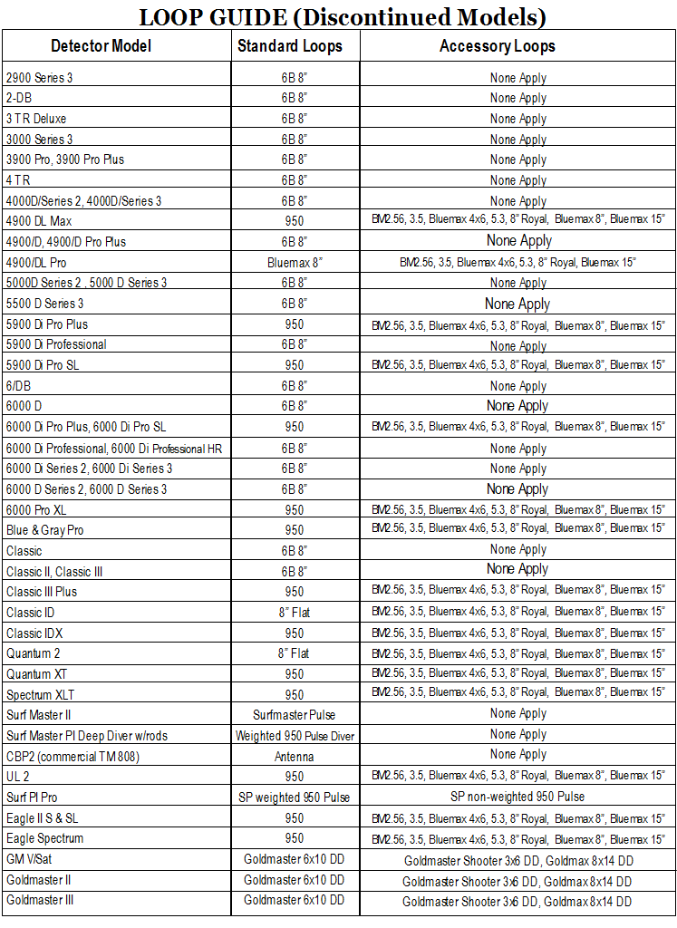

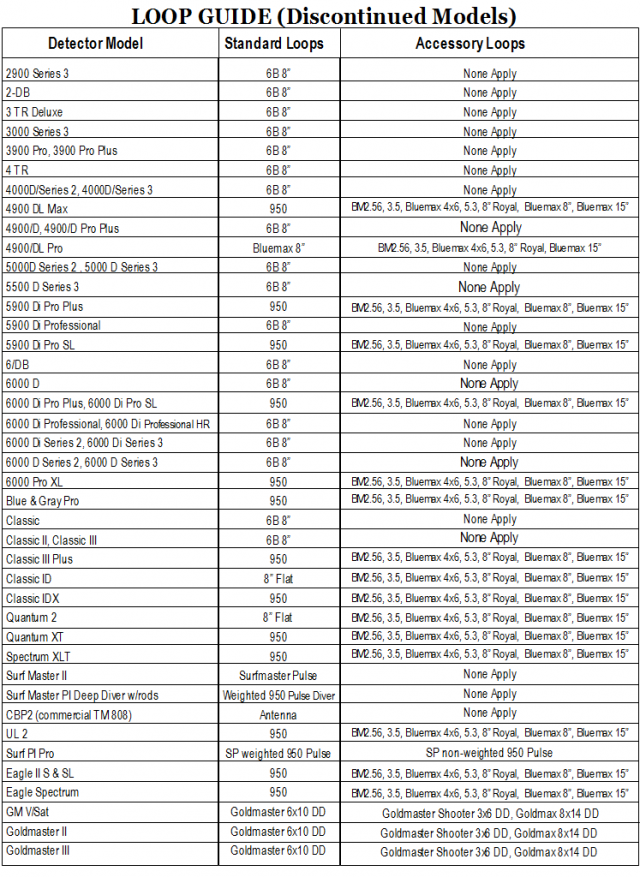

                    this chart seems to be incorrect.
                    i have tested the 4B coil on the 6000d s2 and 6000di s3 which use a 6b. its not not work.
                    and vise versa.
                    it lists the 6000d as a 6b. which what i have is not.
                      and vise versa.
                      The loop guide chart does not agree with the info you show in post #9. To do so it should show the D4 (&D5) coils to work only on the 6000/D & 6/DB detectors, which has been your experience. The 4B coil you have would only work on the (not listed) 4/DB & 5000/D. White's has produced a bewildering array of search coils over the years. Some may work, with degraded performance, on other models.
                        i have quoted a few other posts, which agree with my findings that the chart is wrong. lesson learned i guess. triple check.
                        the 4B coil did work slightly on the 6000D s2 but the target response was very weak. any now i know why
