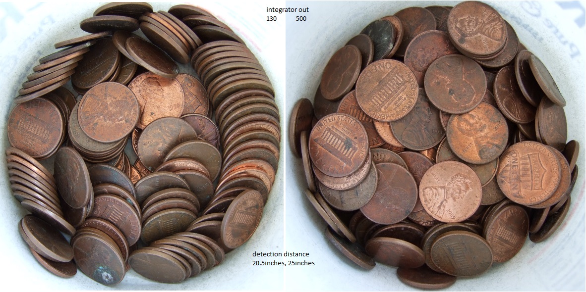

      Tried a quick test with pennies. Used a plastic sour cream container, 80mm diameter at the bottom. About 115 pennies(some old some new). One test with most coins laying flat. Another with more coins on edge. Added voltmeter reading at integrator out with coins at 9.5inch spacing and detection distance on the pictures. PI detector, GB on adjusted to cancel ground signal .Target swinging from a pendulum.
        A worthwhile test, I think. Your two distances (25/20.5) and the two voltages (500/130) are a reasonable match to each other, assuming the inverse 6th power relationship. That is to say (25 & 20.5) suggest 3.3 : 1 signal strength, vs. 500/130 = 3.8 : 1 ratio.
        But it also shows that the arrangement of the coins has a very significant affect on the results.

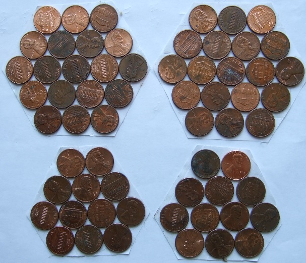

        The kind of 'coin cache' simulation I had in mind was very rigorously defined, such as :
        bottom layer: hexagonal shape, rows of 3,4,5,4,3 coins (total 19 coins)
        2nd layer: as above, rows of 2,3,4,3 (12 coins)
        3rd layer : as 1st layer
        4th top layer : as 2nd layer
        These all neatly overlap, the centre of a coin sits above the triangular gap between the three coins below it...
        A picture is worth 1000 words, I'll add one later...
        All insulated from each other, to simulate the corrosion of Roman bronzes etc.

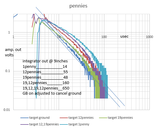

          An attempt at your test with a PI. Coins were sorted for similar signal strength looking at integrator out. Charted the decay(pennies_3.png) to see if I could see why 12coins had higher volts than 19coins. Coins were spaced at 9inches(reply 17 should have been 9inches instead of 9.5inches,remembered wrong). Alignment of the stacked coins does effect integrator out reading. Double sticky tape was put on printer paper and the coins stuck to the tape(pennys_2.jpg).
            Interesting stuff, I'm glad you made sense of my layered penny description.
            The signal strength difference between the double-layer and the 4-layer is quite marked, the idea behind this layering is that there would be little additional change when more layers were added below, ie. 5, 6, 7 layers would be marginally more detectable than 4. These results make me think it's more complicated....
            I've read (somewhere...) that with coin caches, the eddy currents of one coin can pass to neighboring coins, such as ones below, and this is repeated with less intensity each transfer. This is alleged to cause a cache to have a larger eddy-current lag, which would presumably make the cache appear a higher-conductor/lower corner-frequency target to a VLF. I've no idea about PI response - longer delay?
            We appear to be treading new ground here, do you (or anyone else) have any thoughts? I'm going to have to bodge together my machine so I have some results of my own to contribute.

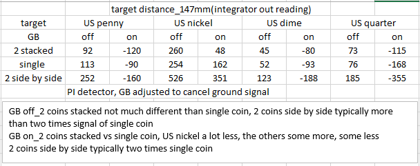

                        Did a test comparing 2 stacked coins vs single coin vs 2 coins side by side. Used a PI detector, wondering if a VLF detector would give similar results.

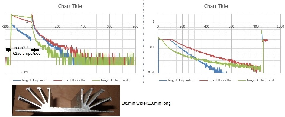

                              Don't have an aluminum plate so I ran a test with an aluminum heat sink to get a feeling for decay time constant. Tx, 160usec constant rate 6250amps/sec, 1000pps. Rx IB coil. Noticed signal decay slope(for the heat sink, US quarter and Ike dollar)when coil on is close to coil off slope after it becomes a straight line decay on a lin log chart. Wondering if it should and why. Chart time scale in usecs.
                                This is called 'the diffusion effect' and is most noticeable on objects with long TC's. The initial decay is fast as it is just a surface current in the object. When the TX pulse is switched off the initial currents are just surface, or near surface. Only after a delay when all of these surface currents have settled down does the decay become a single exponential and result in a straight line decay on a log amplitude/linear time display. Your TX pulse of 160uS width is much too short for your heat sink target to generate a full response as the same onion skin effect also applies to the switch on and duration of the TX pulse. I have a paper that explains this effect this effect from a theoretical point of view. I will look it out and post the details.
