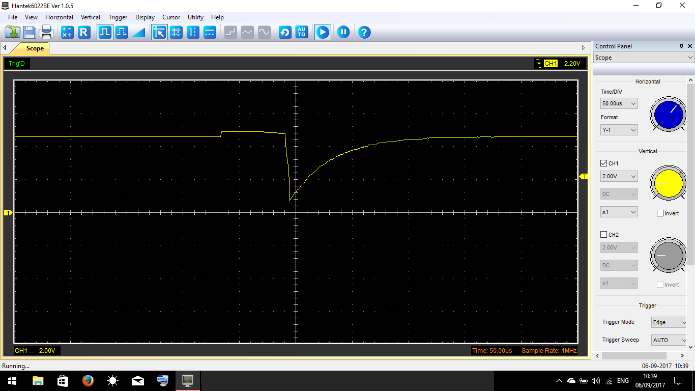

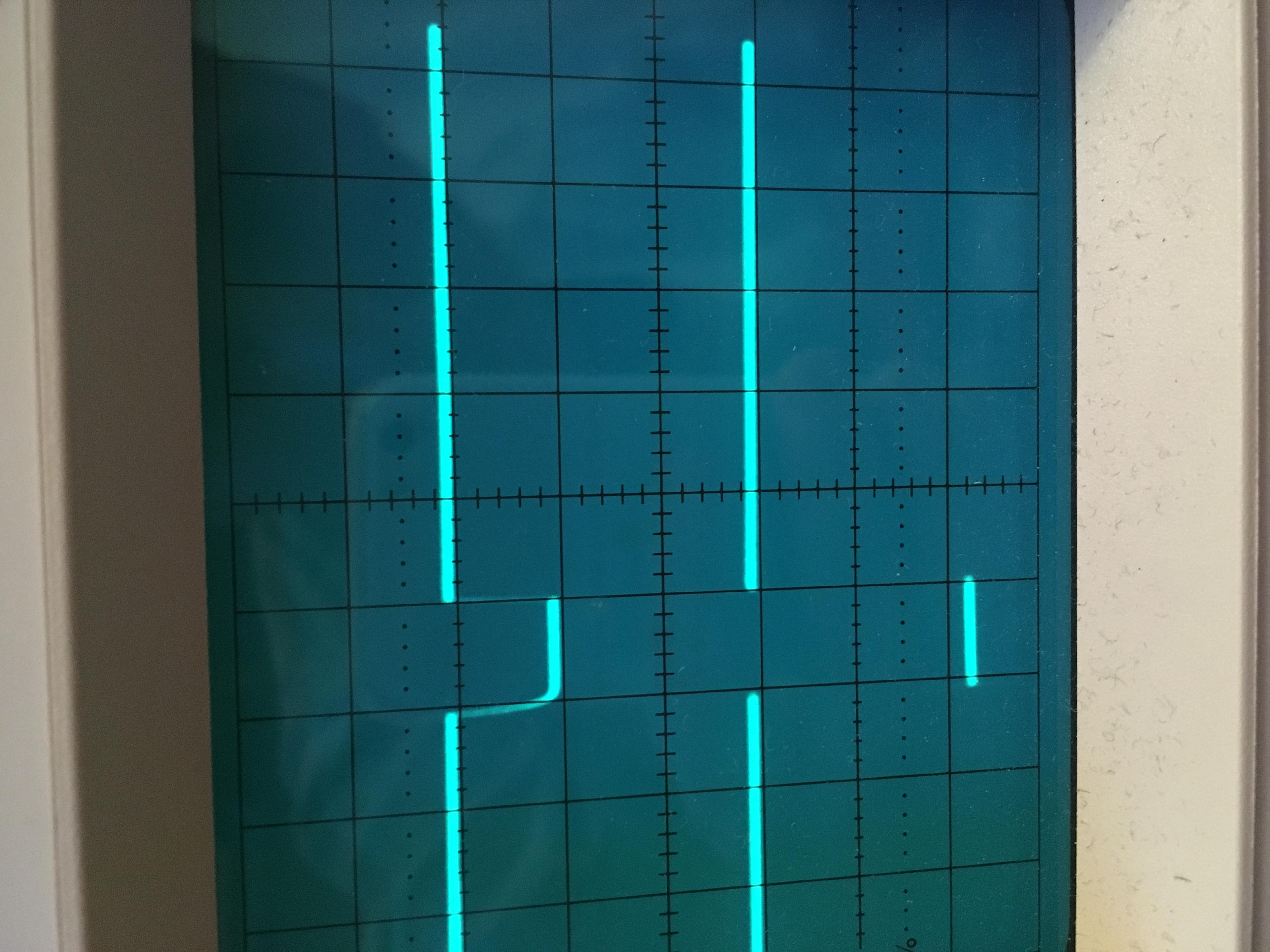

    im just getting a high pitched sound, it used to just start up then went intermittent had to switch it of and on a few times
    i think it might be the delay or some thing else i just cant work it out

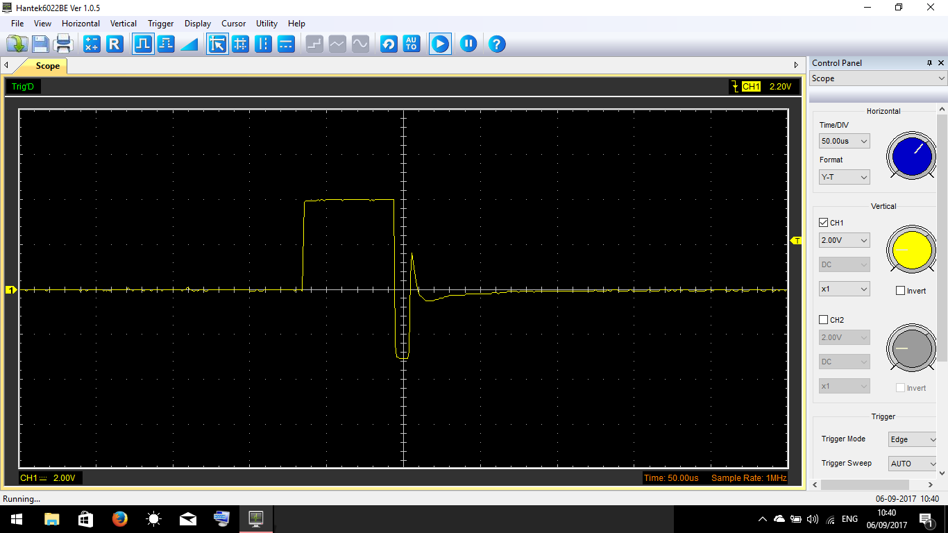

    test point 1
    test point 2

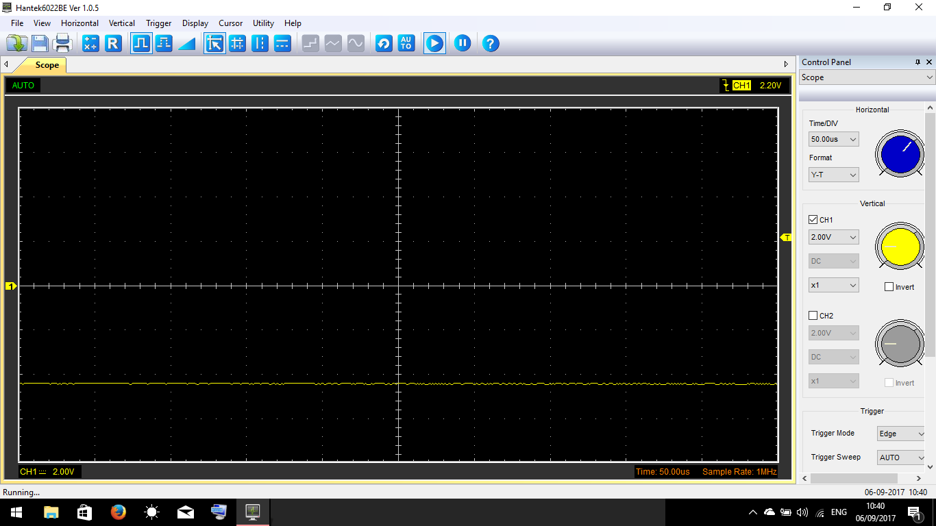

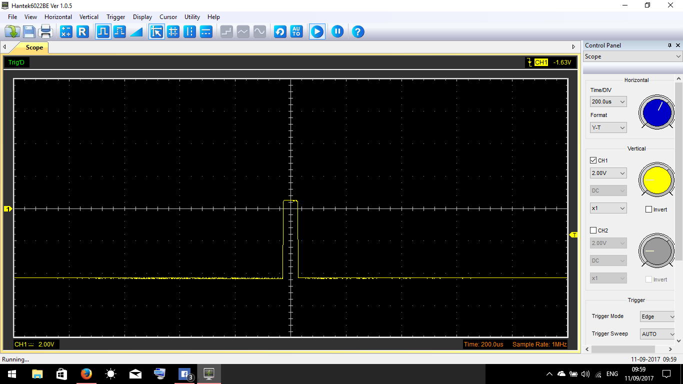

    and pin 8 of the MC14093
    can some one help and post a trace of pin 8 on the 4093 i don't know if its supposed to be like that should it not be -
        some one post a scope pic of pin 8 on the 4093 im still waiting on the chips ordered a 4066 to, i cant find a scope pic of the 4093 no where on the forum

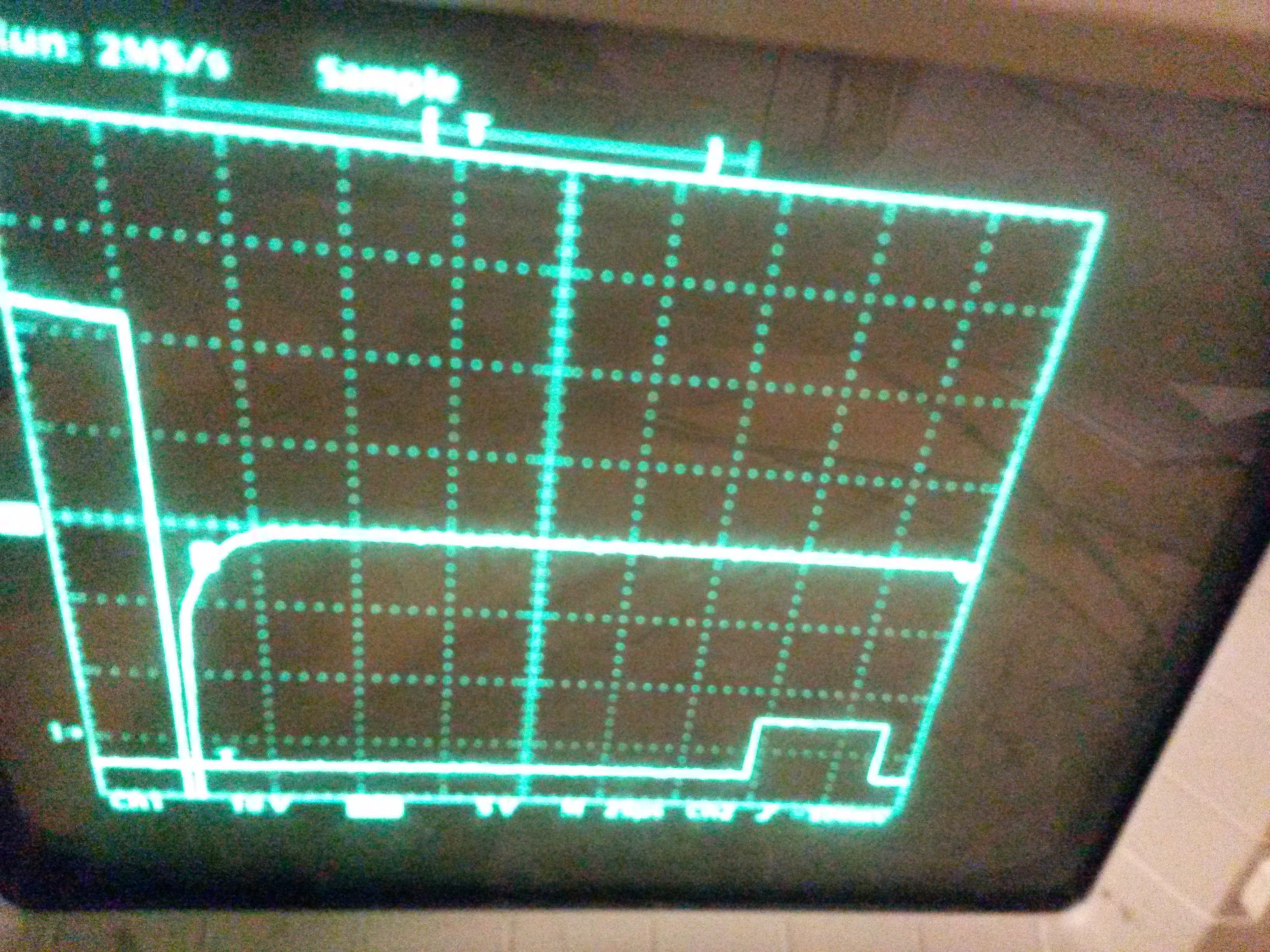

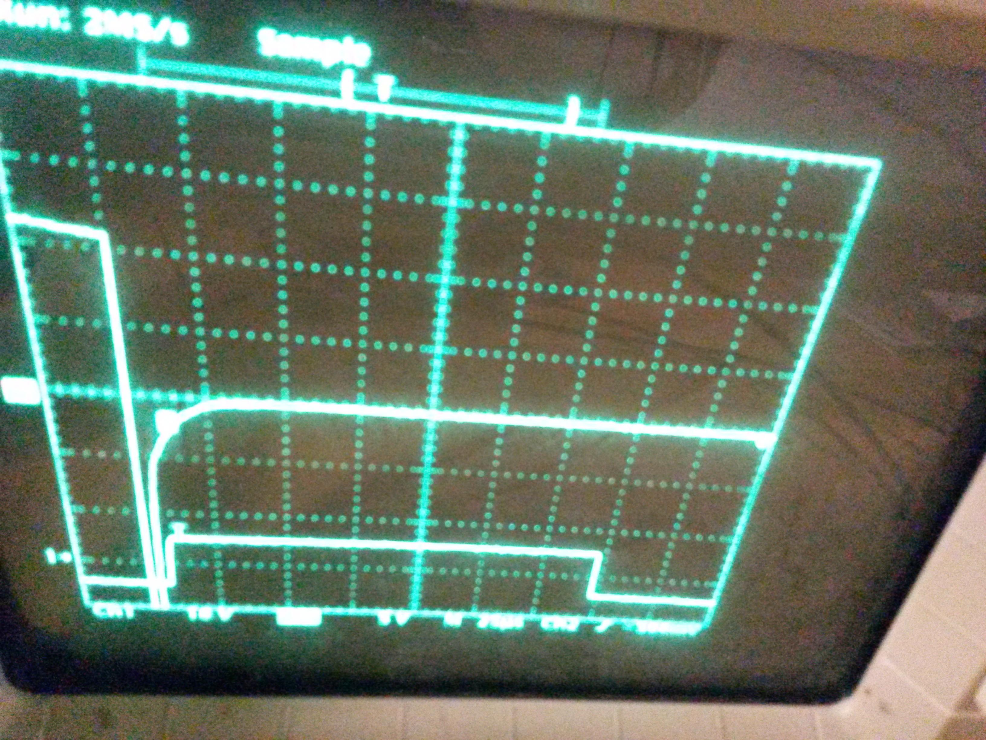

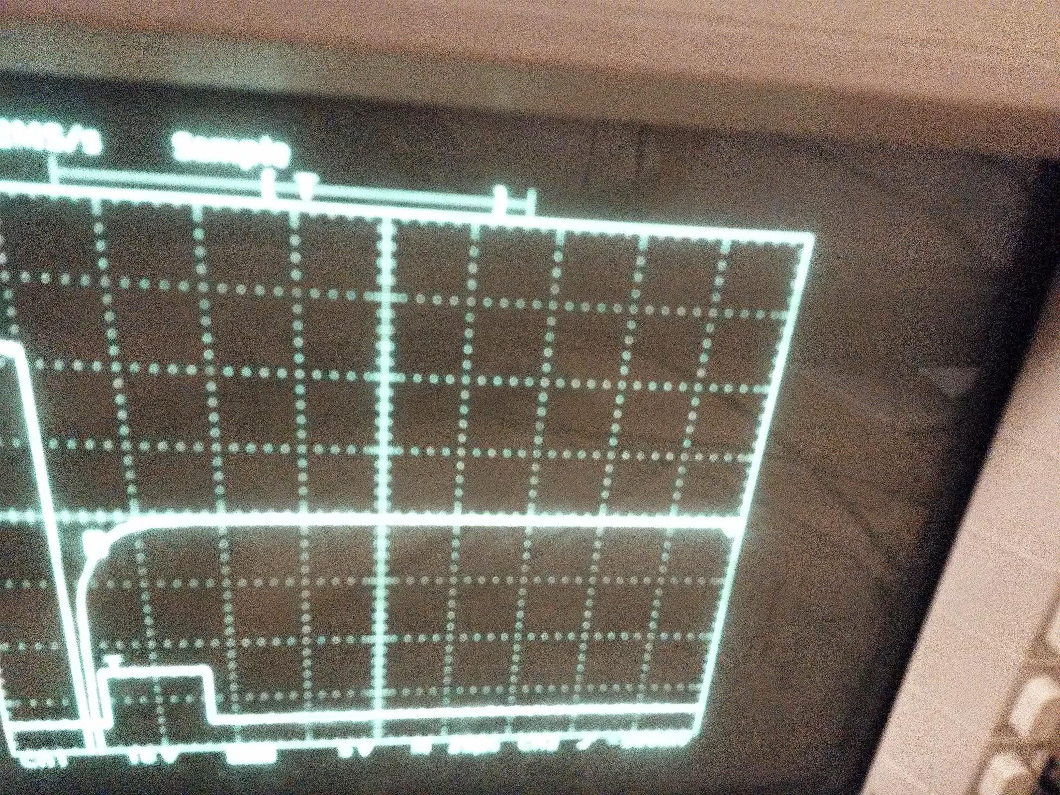

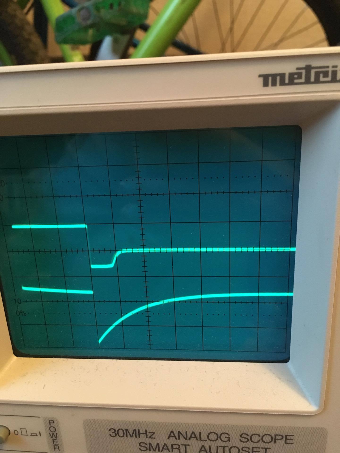

          Why do you need scope pic for pin 8? check pin 10, 11, 3, 4. is your delay working? when rotate the pot you have increase in pulse length?
            ok thanks, here is my problem i put the chip on a breadboard (4093) and tested the logic it works fine, i even tested it with a pot to test threshold, it switches around 1.9v, well within the range of the scope pic i posted, but pin 10 is always low on the board but not in the test so i having wtf moment, as for pin 8 i just want to make sure the right signal is going in to it and its not a power problem, this one was working fine then just slowly died on me, it used to start up fine now it just starts for a sec then a high pitch constant buzz when you turn the delay on the pot, oh and it will stay that way until i leave it for a while without power, so far i have changed every chip trimmer and main cap apart from the 4093 and 4066 they are on order

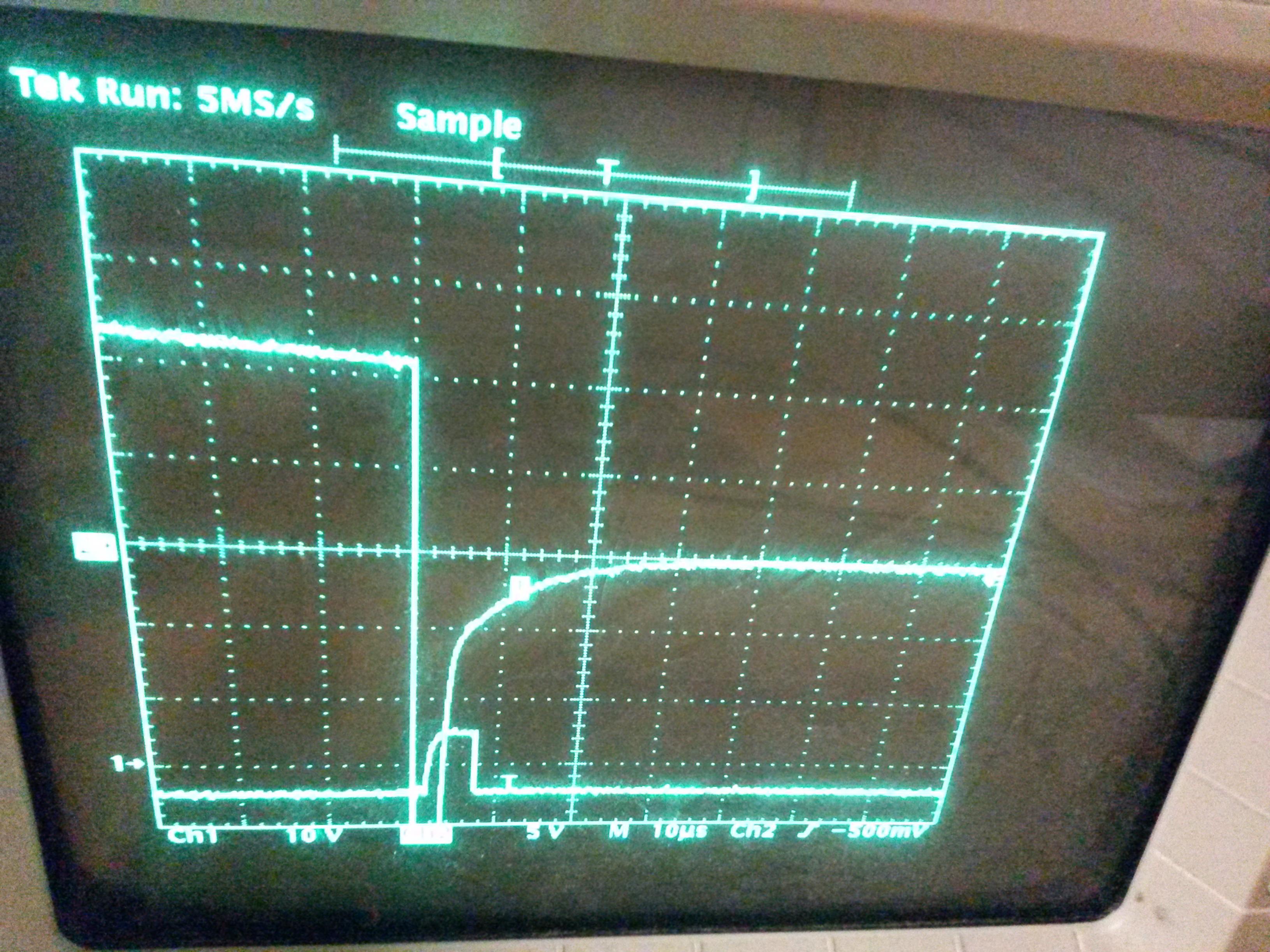

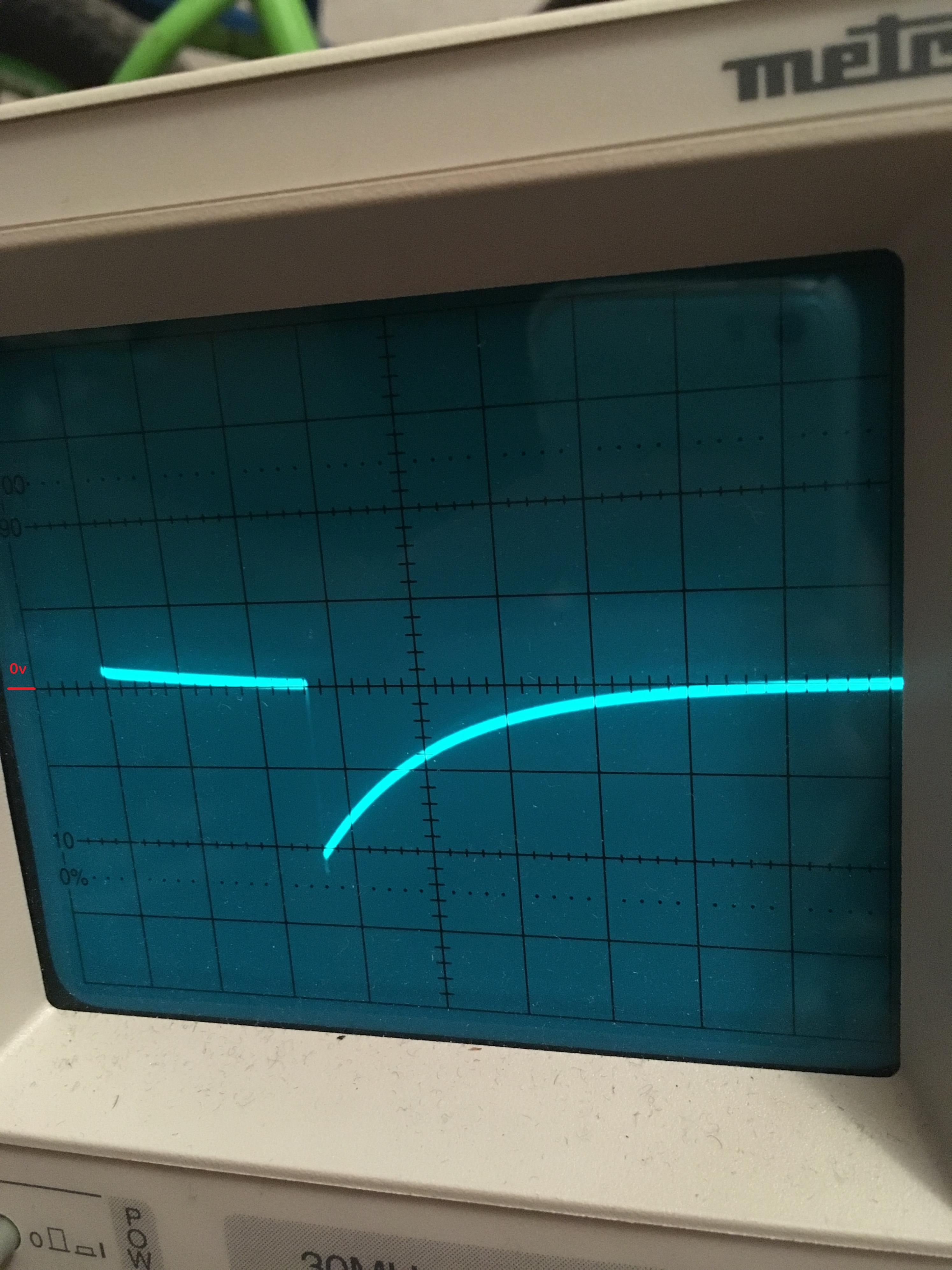

              this is pin8 on my surf pi. it looks good!
Name:	pin8 20us 5v div.jpg
                thanks for the trace yes its the same but i cant read the trace mines is +5 down to +1 is your one the same ?, when i tested the chip it should trigger but as you see i get a constant -5v on Tp1
                  I don't know what is tp1. 5v/div mine is different.
Name:	pin8 5v ped div 20us.jpg
                    so that seems to be my problem mines is +5v and i don't know what's pulling it up its just a trimmer and resistor and a cap i must have a short some where this is before C9 and after

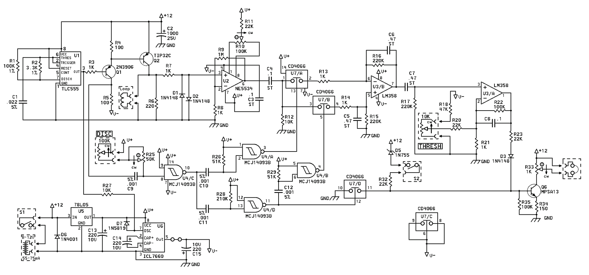

                      Is signal from 7660 and 555 oscilator syncronised? Check transistor q1. I use this schematic, and measurements are from original surf pi.
                        Pin 3 555 and pin 7 7660

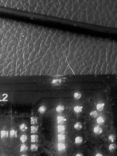

                          think i have found the problem a power track is corroded with the board being black its hard to see need to clean it up and test
                            yes it was the problem on the main power line some how salt water got into the screen and corroded the line, note to self make a waterproof case lol
                              [ATTACH]40483[/ATTACH]
                              Great! Good that you had scope. Moisture can get inside if you swing near the sea and in time comes the trouble.
