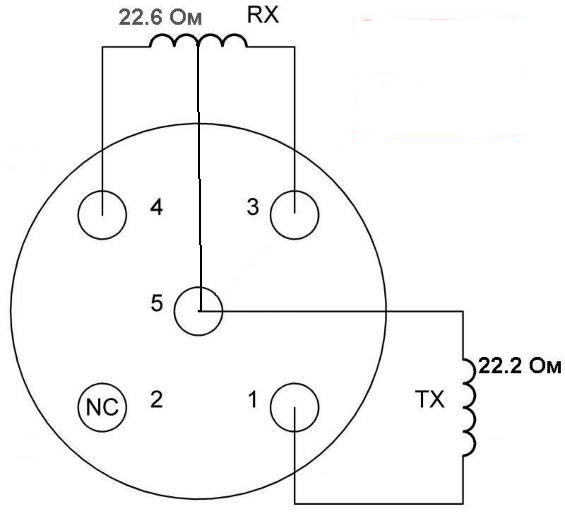

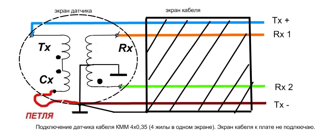

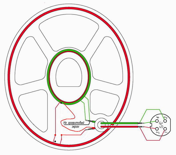

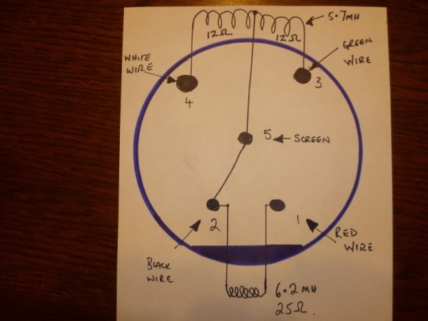

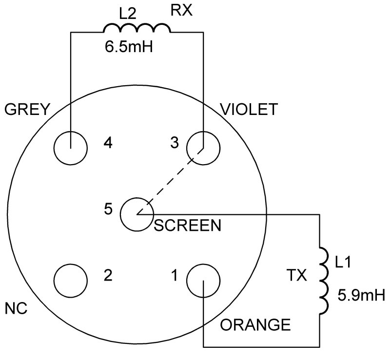

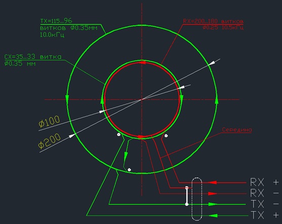

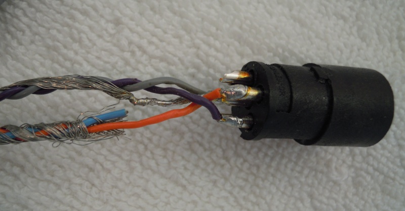

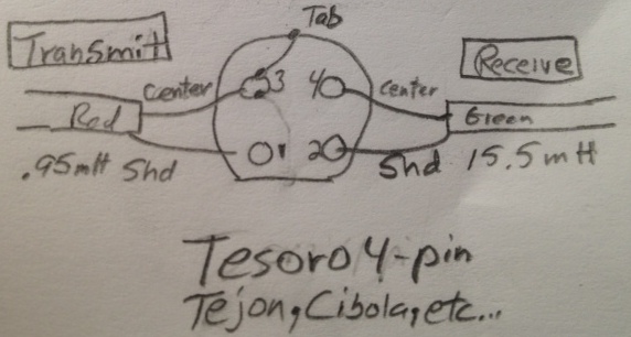

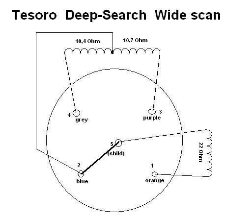

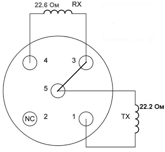

    Is there any owner of Vaquero Germania II ??? The colleague broke the cable from the coil connector . If one of the owners of this model would be kind enough to open the connector and tell us the colors of the wire by the numbers on the connector ???? Thanks in advance ! Or picture of the connector inside? Thanks! fixxx

    I have this only this picture. Mozda pomogne.

          Thanks,problem solved !!!!!
