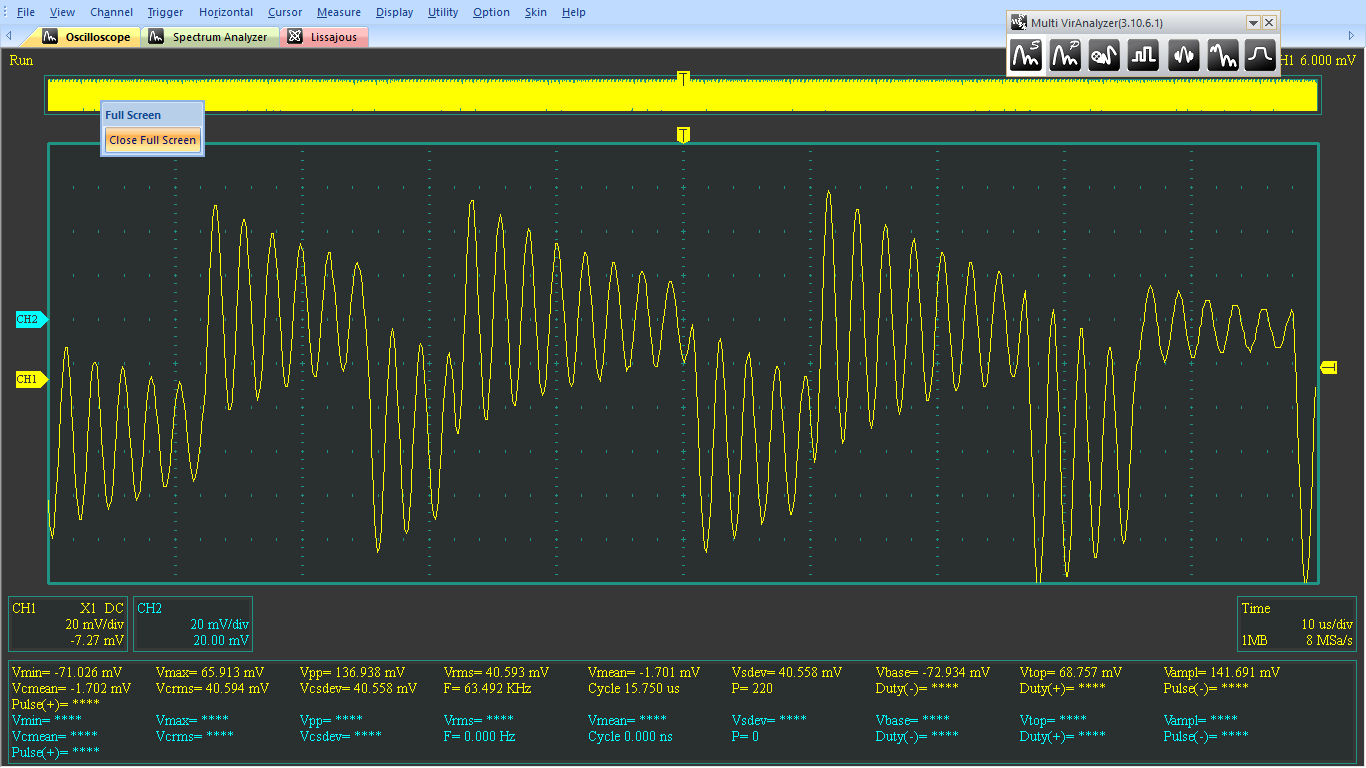

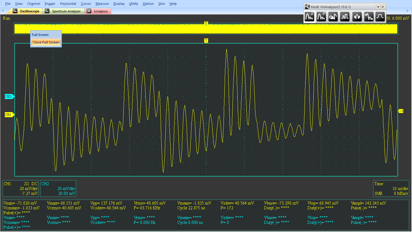

All that sinusoidal ringing looks like a result of some low-pass filtering, with a steep cut-off. Are you using a Harbin "Instrustar" USB scope??
Are you using another detectors RX coil as your pick-up loop? I'm wondering if some resistive load on the coil's output may help.
I
yep instrustar scope usb type, coil was and old bucking coil pulled out of a Chinese toy detector , I will work on getting a single 5kh sig down pat and then work on multi frequency pic later, have to happen next week as driving across paddock tomorrow so be 6days of driving before I get to play with detector again
