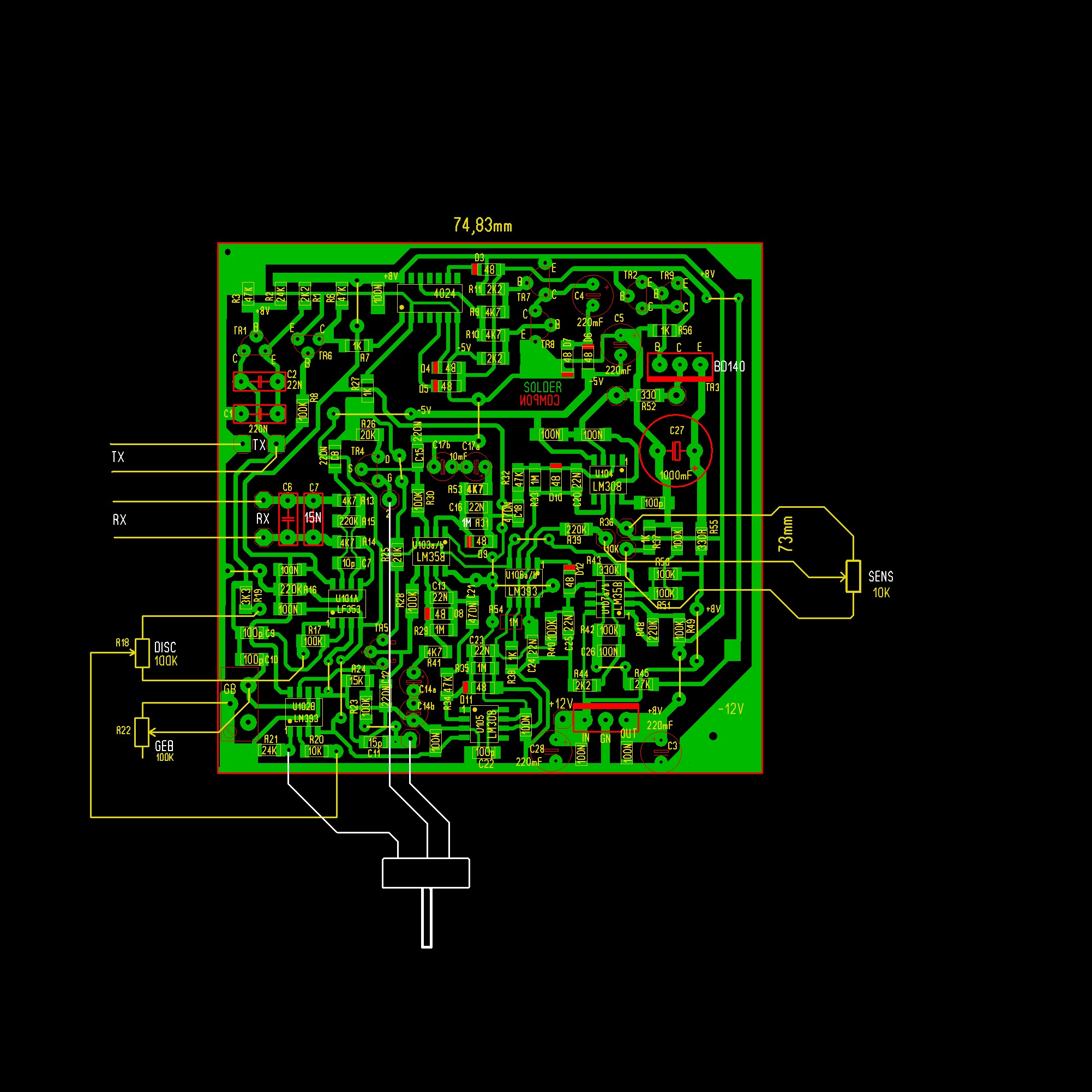

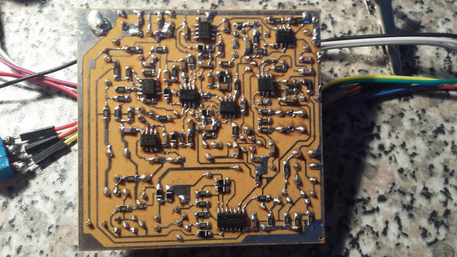

    Here is the my smd version of TGSL. The same version that Ivconic presented year's ago. I reconverted to 1206 size, some thing's, like transistors, FET's, elco's remain through hole.
    Layout file is without mistake's, so everyone can make. Work's same like TH version, i just wanted smaller pcb to fit diferent case.

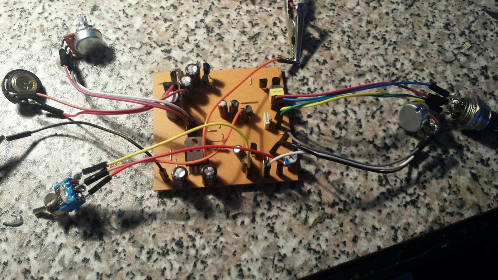

    More photo's...
      Excellent work!
        well done, thx for upload
        next step could be to remove tht elcos and replace them with smd elcos
        you can add smd pads on same Position like the holes for tht components
        or solder smd parts direct on solder rings if the footprint of components is the same
          Thx Bernte, you are free to do whatever you like with this. I i maked TH part's cause in that moment i had a lot of those, next problem is BF245, i didn't searched for smd replacement, btw i don't know if smd BF245 exist.
          Im my case, there is MPF 102 fet's, so orientation for bf245 should be for 180 degree's.
          In next few day's i will change 2907 and 2222 transistor's to smd 3906 and 3904.
          Also, i will post Minelab musky oscillator, but that pcb isn't checked yet.
          Regards.
